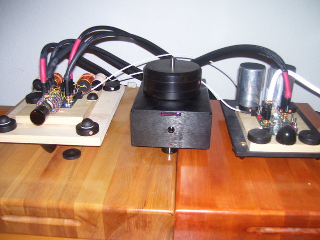

I just recently replaced my Jensen PIOs (2.2uF) with Mundorf SIOs (3.3uF) on the output caps in my Altmann Attraction DAC with no bypasses.  The Jensens themselves were readily apparent upgrades over the WIMAs, and I too immediately noticed more "bass virilty."  The Mundorfs really seem to have opened up the extreme frequencies and lifted another significant veil from the sound.  Highly recommended tweak, but there are some slight difficulties with the stock lengths on the Mundorfs' leads.

maybe you dont need ANY outputcap on the Altmann Dac, just a superb little piece of gold wire :D
for that length will be really cheap
Why that solution?
As any very short wire  sounds better than any cap money can buy.
BUT ONLY if you know you can trust the INPUT cap of yr next apparatus ( probably a preamp or power amp.)
You DONT NEED 2 caps in series with an IC in between
actually you SHOULD NOT WANT 2 caps in series. :nono:
