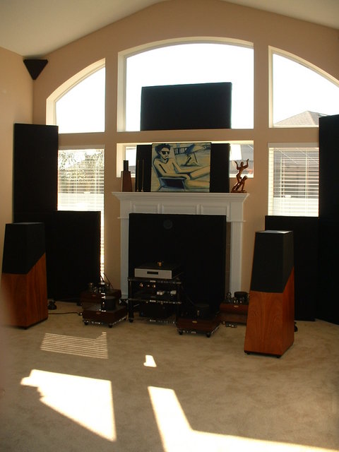

I love both products.  I have 6 GIK Tri-traps - 2 Monsters - 2 244's and 8 242's etc... 8th Nerve corners and seams.  We just moved into a new house and I tried my system without any panels.... YUCK!!!  The Tri-traps are excellent!  Here's a pic of them playing together happily ;)  I have the rear and side walls treated too.

Truly beautiful-- ah-- the way the sunlight plays across the room-- and across the acoustic treatments.
Looks like you have stacked tri-traps in that picture with some 244's or 242 up there as well.
How come my room doesnt look like that with my eighth nerve stuff installed?  Just looks like someone stuck pillows on the walls in the corners.
No sunshine....  no beauty.   I think I need a pair of tri-traps-- maybe thats the problem.

Thanks  :wink:  Your right, I have stacked tri-traps in the corners - monsters on the floor next to them - 2 244's behind the rack(covering the fire place) and 2 242 on the center wall.  It all works pretty good along with the 8th Nerve stuff.  I have 2 more tri-traps in the rear corners and 2 8th Nerve seams on the wall/ceiling junctions to the left and right of my listening chair. We have the windows tinted for UV protection but around 7:30pm-8pm its still little blinding, hehe..
