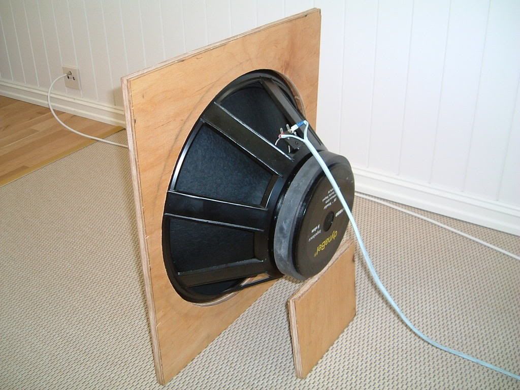

Have had them up and running for a week or so. Have gone the minimalistic way by just mounting them on a sheet of plywood.

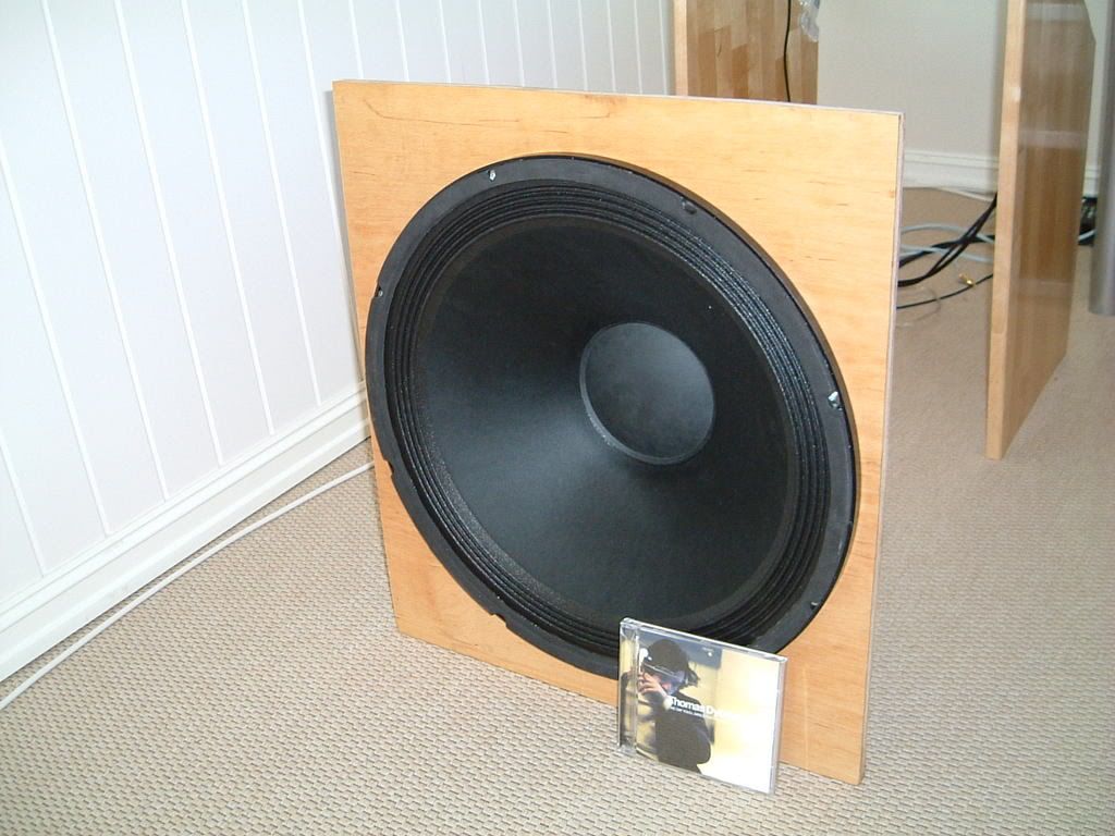

It's on prototype stage yet. But one driver weigh 24 pounds, and is stable by it's own weigtht.
Here's the size compared to a cd-cover:

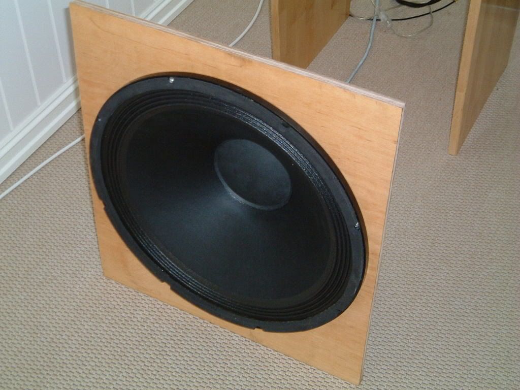

It's place'd right in front of the mainspeaker:

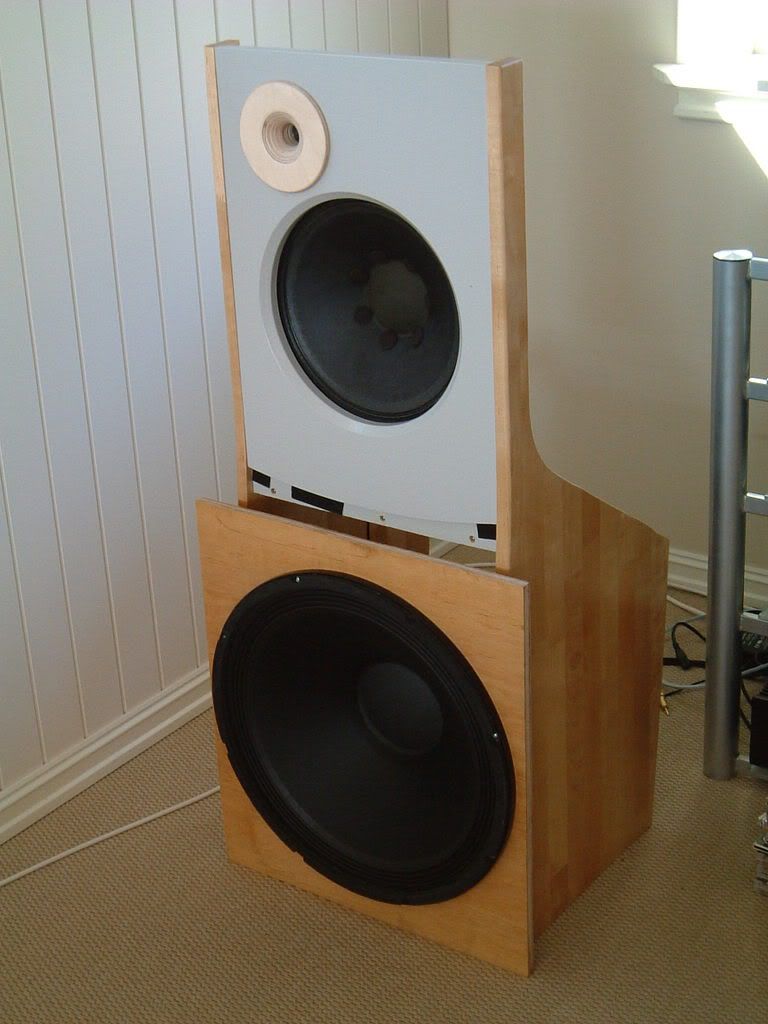

Each driver has taken the place of dual Peerless 12" in each channel (W-baffle). I thought the 12" where nice, but the difference is quite big. The bass is much tighter and not boomy at all (which the 12" was in some way at loud volumes). The kick drum is really sounding like a kick drum, and not some animated wannabe :) The deep bass is less distorted and is not trigging any big resonances in my room
This driver seems to fit the broadbander much better regarding sonics. The 12" broadbander is a coted papertype. Just the same as the 18".
I have not applied any eq yet, as I do not feel the need for any. There is enough grunt down there. I'm going to run some sweeptones sometime , to get a real picture of the performance around 20-30hz.
As you might see, the old housing for the W-baffle, is making som kind of U-baffle. But it's not contributing to much, because it's not airtight on the sides (quite a gap).

The position in the second pic looks just about perfect.  Just add damping and staggered cross bracing and a top in that U.  It will give you greater bottom end potential and require less power.  Since it fits so well you should give it a shot.  There's also something different about sound "mushed" out of a deep manifold and direct radiation, though it may not matter much below 80hz.  Keep in mind that you need almost an 8m long room for dipole to 22hz.

I have to try the U-baffle as you say. It's easy and not much work. I have done the U-baffle earlier with some 12", and it had defiantly more bottom. Things started to rattle in the room. My experience with ripole shows no problem when the X-over is as low as 80hz, so I do not think it will be any problem. My room is over 9 meter long, but unfortunately I'm sitting in the middle of it. :D
