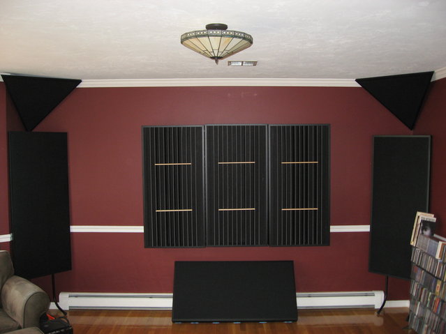

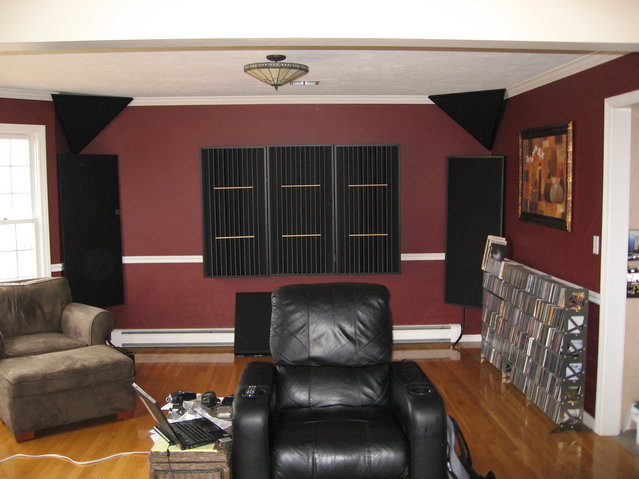

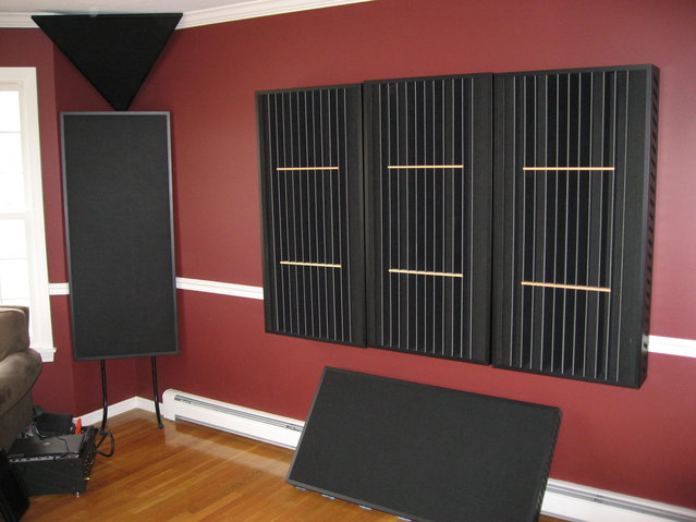

Ok, I have the back of the room cleaned up and the RealTraps Tri-Corner Traps, Mondo Traps, and Diffusors are all mounted.  I now have the following RealTraps products installed behind me:
(2) Tri-Corner Traps
(2) Mondo Traps
(3) Diffusors
(1) MiniTrap
Here are some pictures:
A couple looking straight back at my listening spot:
Back left of the room:
Back right of the room:
Next up, I will be cleaning up the front of the room and moving some things around.  I will also be ordering a Mondo Trap (HF version) to go on the front wall in place of the current MiniTrap.

Nice looking room George.  Ethan's diffusors look really slick against the wall color.
Bryan
zybar
  • Posts: 12091
Bryan
Thanks Bryan.
