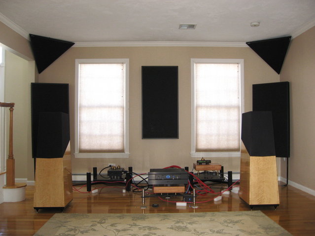

A picture is worth a thousand words:
Ignore the mess as I am still working on getting things permanently mounted and cleaned up.
George
« Last Edit: 20 Mar 2007, 05:26 pm by zybar »

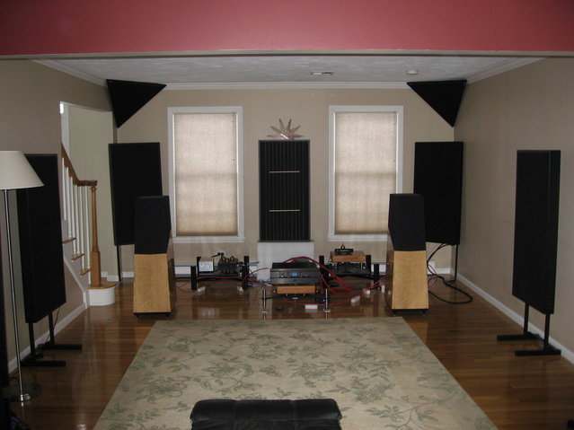

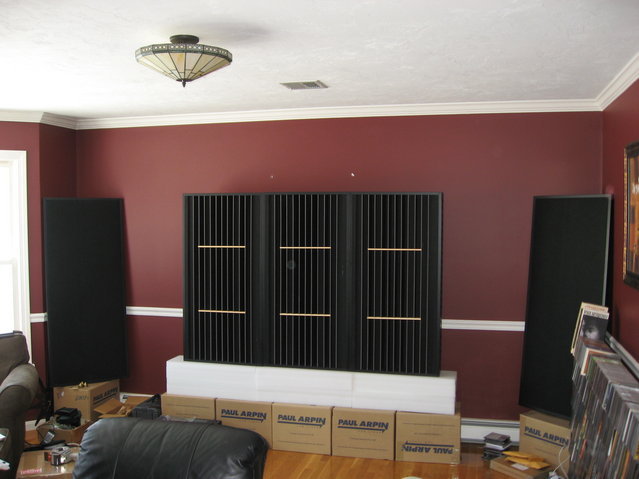

Here are some before and after pics:
Before
After
George
