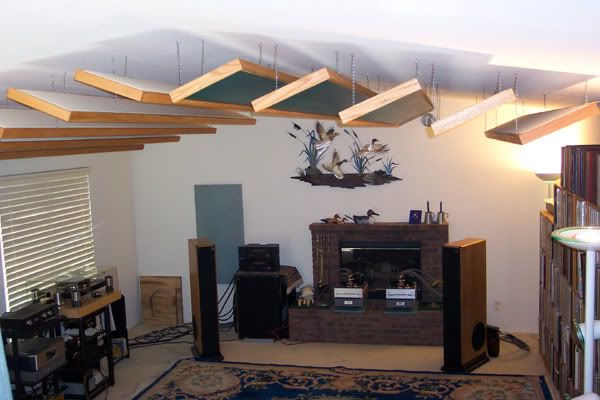

Thanks for the info Brian.  However, my ceiling is peaked, 10' high down the center and 8' at the sides.  Plus, I have all of those panels hanging from the ceiling which may or may not break-up bass frequencies.  In addition, the room is sealed at the back for high frequencies, but not for bass.  The bass escapes into the rest of the house and up the stairs.  Some gets reflected back, but I have not been able to measure how much.
Nobody said being an audiophile was easy, so I could try all fifteen frequencies between 57Hz to 71 Hz.  However, I think it will save time to analyze the response curve of the room so that I know what the center frequency of the hump is and how wide it is.

With a room like that, you might want to look at the frequency curves for each speaker individually.  You might have different modes for different speakers.  You may want to add some bass trapping in the corners.  Also, you could lift the sub using, eg, ASC subtraps (or just a small table) to minimize the floor-to-ceiling mode:
http://www.asc-studio-acoustics.com/sub-trap.htm
This way, you could affect another mode using the EQ.  Are you using the bass amp on the subs or on the RM30s (or both)?  I think using these to drive the bass of the RM30s/RM40s is a great idea.

The plate amps are driving the separate drivers of the Larger.  The RM30Ms are being driven full range by the SET amps.  I am thinking about putting caps at the input of each SET amp and rolling off at 70Hz.  That will require retuning the sub, of course.
The room and its acoustic treatments were designed by Rives Audio.  The frequency response curve is fairly flat except for a broad 4dB hump in the bass which makes things a bit warmer than they should be.
Question - is it really possible to get floor/ceiling modes when the ceiling is sloped for its entire width.

« Reply #15 on: 25 Feb 2007, 12:10 am »
My soundroom ceiling slopes from 7ft 10" to 8ft 10".  I ended up with a pole frequency of 70Hz, .25 bandwidth and 5dB of cut.
Feel free to experiment, you'll get the hang of the EQ controls quickly.  Small changes make a big difference.

True enough works for me too  :D. My ceiling is 7' 10" with no slope and I am using a DEQ at 72 Hz 1/5 oct at -4 db and my side walls are 14' 10" with a 38 Hz at 1/6 oct at -3db. and a little bump at 144 just 1/5 oct -2 db.
