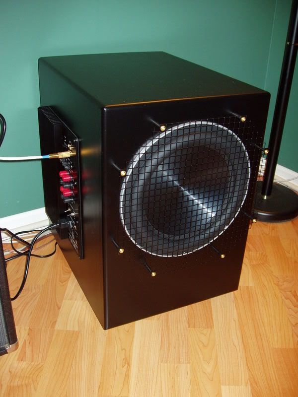

I love my stereo pair of Rythmik SE370 subs.
In the past I have built several ported subs but was never happy with the boominess of them. No matter how hard I tried to tune and place them properly.
After listening to dozens of commercial subs at shops and friends houses, the Rythmik may be the most musical subs I have ever heard. Very fast, clean and tight.
118 lbs. each , the grills were originally 1.5" from the baffle and at higher volume the surround would hit them . So they were moved to be 2.25" from the baffle.
I don't have 1000's of dollars to spend on subs ....but with these  I feel like I have 1000's of dollars worth of subs.
BTW, Brian Ding was a pleasure to deal with. He answered all of my emails promptly, shipping was fast, and they were packaged very well.
