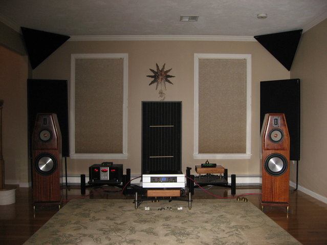

In the topic on Diffusors there is a picture of Zybar's room:
What is the benefit, detriments, or change by using the Tri-Trap up in the corner, instead of covering the entire corner with the traps?  I have been debating whether to cover entire corners in my room with traps or doing something like Zybar.  But, not sure of the differences between using traps only or traps and tri-traps.

Btw I like your rig. Very nicely done and it's nice to see someone who realizes how much better your system sounds with quality room treatment and traps.
Not my rig, it is Zybar...I am using the photo as a reference point to my question.

Dan,
Ethan is way more qualified to answer your question than I am, but here a few thoughts on why my room looks the way it does:
1.  I started out with the Minitraps when that is all Ethan had.  I bought as many as I could afford at the time, and bought more as funds allowed.
2.  I originally had the little tri-corner products from Eighth Nerve and Echo Busters, but when Realtraps came out with their tri-corner, I tried it and thought it improved my sound more than the other products so they stayed.
Did you ever have the panels straddling the corners from floor to ceiling, or compare a panel up in the corner to the triangle?

> What is the benefit, detriments, or change by using the Tri-Trap up in the corner, instead of covering the entire corner with the traps? <
First, just to clarify, we call our triangle shaped bass trap a Tri-Corner trap. :green:
When cost is not a factor, the best way to treat a corner fully with RealTraps products is a MondoTrap straddling the corner, about halfway up between the floor and ceiling, and Tri-Corner traps above and below. The reason this is better - but again, when using RealTraps products - is it gives the most broadband absorption.
The front surface of MondoTraps and Tri-Corners (and MiniTraps) have a membrane that increases their absorption at low frequencies. But the membrane also makes them semi-reflective at mid and high frequencies. So by allowing a gap between the top and bottom of the MondoTrap and the Tri-Corner traps above and below, mids and highs can get to the rear of the panel where they too are absorbed. So you get the best of both - a lot of bass absorption, and absorption at mid and high frequencies too.
Absorption over the full range is important especially in the front part of the room, in the vicinity of the loudspeakers, to reduce the "chatter" and excess ambience that typically accumulates there. In the rear of a room absorbing mids and highs too is not as critical because by then the ambience and reflections are no longer "near." Indeed, this is why diffusion is popular in the rear of a room, especially in a larger room like George's.
--Ethan
