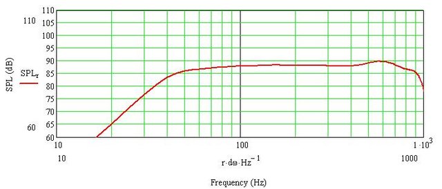

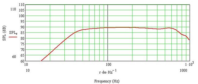

If you are Josepho of a diy-Audio thread I think I said already there that one Alpha15 would do it. And I also think I recommended MJK's worksheet to you: http://www.quarter-wave.com/Models/MathCad_Models.html . However I think that this is of some general interest, so here is a simulation with one Alpha15 and Seas Hexagonal W15CH001 driver. Alpha is crossed 2nd order Linkwtz-Riley at 250 Hz lowpass and the Seas at 350 Hz highpass likewise on a 48 x 20 " baffle with Jamo likening (I have in fact had this simulations since the discussion in this thread earlier) :
If you go up to 24" width, it will simulate like this:
This is a brilliant example of what you can achieve spending some time with this excellent software.
