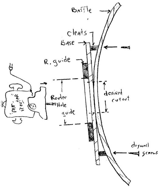

After thinking again about my suggestion with the support board on top of the curved panel, I discovered a possible problem with the stability of the support when the cutout is being made by the router: when the circle is done, the inner plate will want to fall out, meaning loss of support for the ruler and drifting out of center. To avoid this, the circle ruler for the router must be large enough tu stretch out obove the inner circle and the center pick of the circle ruler must be deep enough to perforate not just the support board but to stick in the curved panel as well. Then it may work.

Hola.    Thwo, your on the right track. You have to build a fixture to cut a perfect circle on a curved surface. Forget the circle compass guides and templates. First a router support board of sufficient size to accommodate the full base of the router from 1/2" plywood-MDF etc. Attach cleats of 3/4" pine that follow the curvature exactly. A circle cutting guide of 3/8" to 1/2" MDF-pine- Plexiglas etc. allowing for the diameter of the router base. Calculate this opening or eye it-adjust it to size. Attach this to the baffle from the backside with drywall screws. Cut slow. A bit of sufficient depth will be needed. The thicknesses of all these boards is up to your skill levels using power tools.
A sketch is in the Gallery...."router gd 1"  Jeenie.

« Reply #64 on: 24 Mar 2009, 05:44 pm »
[imJPEG imageg][/img].....???????  What am I missing?
mcgsxr
Re: Jamo R909 Clone?
« Reply #65 on: 24 Mar 2009, 08:59 pm »
To post it, you have to get the full URL from the properties of the pic, in the gallery - <img>http://www.audiocircle.com/image.php?id=18920</img>
For the above, I changed the brackets to show you what you need to do.
jeenie67
« Reply #66 on: 24 Mar 2009, 09:21 pm »
O' TAY!!
