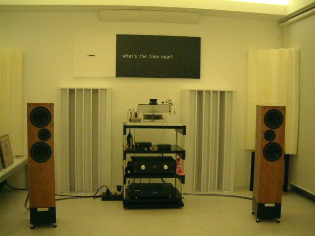

Yes I agree with 8th Nerve their theory of treating all corner,but I think wall treatment is also a must to get complete control of the room....
BTW different from you,even though this customer in the picture already use Eighth Nerve all over the room corner,we could still hear very much improvement in bass control and imaging/soundstage after place the QRD diffuser and Foam bass trap (double size of Arlulex LENRD at front and depth,4 times more of foam) at speaker backwall and two corner ,I think he used 8th nerve "Rectangle" at there before but couldnt cure his 60 hz peak & long reverbation problem,now he say the big foam does.......  :roll:
I completely agree that bass traps and diffusors will provide significant additional benefits to 8th Nerve implementations.  What I said was that I found that "standard acoustic panels" (flat absorptive panels at first reflection points) made no real noticeable difference once a full 8th Nerve solution was installed.  Bass traps and diffusors serve very different purposes for acoustics.  And fwiw, this was only true for me while using the 8th Nerve ADAPT products (not the Response products).
