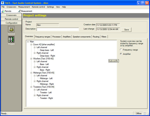

I now have in my possession a fully modded TacT S2150 amplifier.  Since I already have two stock S2150 amps, I finally have the opportunity to experiment with active multi-amping.
As before, the RCS 2.2X is used to divide signal between the mains and subs with 70hz, 48dB/octave high and low pass filters.  The sub output goes through the integrated DAC via a balanced cable into a Crown K2.  The main outputs (all digital) go through paralleled AES/EBU and S/PDIF links to S2150 #1 (modded amp, on tweeters right now) and S2150 #2 (stock amp, on midrange), respectively.  From amp #2 another S/PDIF link daisy chains to S2150 #3 (stock amp, on woofers).  I will be replacing the daisy chain link, which is using a borrowed S/PDIF cable, with another parallel direct link from the 2.2X using a glass Toslink cable which should arrive in the next few days.
Previously, two discrete sets of speaker cable or one biwire set was used to connect the amplifier(s) to the external passive crossover, which then had three sets of pigtail speaker cables that connected to the binding posts of the main channel that are in turn connected directly to the individual driver groups.  So it was extremely easy to bypass the passive crossover, I just disconnected it and connected each amps' outputs directly to the binding posts on the speakers.
I'm using wonderful new software for TacT called TACS.  It is developed by some gurus in France and is free.  It allows very flexible crossover design with semi-automatic parametric EQ, speaker correction, and level normalization.  Also it has a self-contained measurement module that is vastly superior to what comes with the RCS 2.2X.  It still uses the RCS to generate pulses and as mic preamp.
First step is to configure the TACS software to the system.
