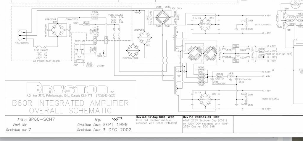

Have a late model B60R C coming from overseas so it's currently configured for 230V 50-60hz 300W.
Sent off an email off to Mike at Bryston on the cost of doing the conversion from 230 to 120 but in the intern curios if one could use a step up transformer?
Unlike a step down transformers it does seem counter intuitive to boost a a 120 outlet to 230 only to have the B60R on board power supply to then reduce it to a working voltage compatible for the proper function of the unit, the label has 50-60Hz so the Hertz should not be an issue but maybe someone else here has a similar experience.
Maybe after talking to Mike and getting a few instructions maybe it's something I can attempt myself but won't argue if sending it up is preferable. Hopefully find out sooner than later.

Although it might be "against the grain",  the most easy solution is a big 120V - > 240 V , 2000W transformer , inbetween your 120V home wall power socket  and the 240V mains plug of the B60R AMP e.g.
https://www.vevor.nl/spanningsomvormer-transformator-c_12206/vevor-2000w-spanningsomvormer-transformator-ac-110v-220v-transformatoromvormer-2x-us-nema-5-15r-3-pins-2x-standaard-europese-shucko-uitgangsaansluitingen-1x-5v-usb-poort-1x-type-c-aansluiting-p_010591488333?adp=gmc&country=NL&utm_source=google&utm_medium=cpc&utm_id=15570505350&ad_group=132570219593&ad_id=569746995020&utm_term=&gad_source=1&gad_campaignid=15570505350&gbraid=0AAAAAoMbvB9sIwT4bK8X7qfBAHs0cG2Ht&gclid=EAIaIQobChMI1_f4nPCBkgMVR6SDBx1SxwFLEAQYASABEgL3BfD_BwE
The cost of such a transformer  (US 60,00 ) would be much less than sending the AMP  to Canada (Mike Pickett), to convert it from European to US duty.
A competent technician could rewire the amp; It would ential:
- Changing the hook up of the 120V AC primaries of the 2 mains transformers from serial (240V AC) to parallel wiring ( 120V AC)
- Omitting the 240V DC removal circuit (D588, D589, D590, D591, C%92, C593 ) and
- Employing mains Fuses with higher Values (2A instead of 1.5A, 5A instead of 4A).
But unless, you find a qualified person in your neighborhood, to do this for you,
I would advise you to go for option #  1 : Buy a dedicated 240V - 120V 2000W preset transformer.
If you are not really qualified to do this revamp yourself, and you would make a mistake, you might hurt somebody or yourselves or damage your AMP.
It is not worth it , IMHO!
Just my 2 Cents!

Yep, I'm looking at this one, 800 watt should be sufficient...
The Krieger appears to be popular.
https://www.amazon.ca/dp/B00HDUUL40
I'm in Toronto so mailing distance from Bryston, back in in the 80s they were in Rexdale and I could drive there in 20 minutes and the turn around for any repairs used to be a day or two, but times have changed.
I'll start with the transformer and see what Mike has to say about doing the conversion.
