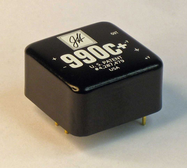

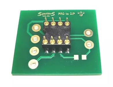

Question: I have a quad of John Hardy 990C+ opamps from a failed Mivera Audio DAC attempt.  They are the pro style pinout.  However I plan to get a set of the Sparkos SS2590's also.
Can I use them in this DAC using this?  With a riser?
PDF on the 990C+: http://www.johnhardyco.com/pdf/990.pdf
Jon L
Only thing I see is 990C (single) seems much taller than Sparkos SS2290 (single), so you might have to do something to bridge the top and bottom boards together if the connectors don't shut all the way.  Or, it could work fine with the connecting pins not 100% closed.
