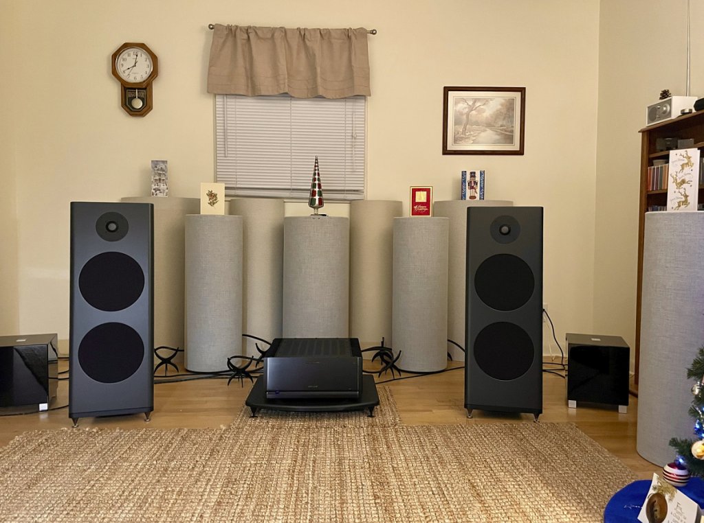

The floor reflection is actually the most critical in your room as it’s usually close enough in time to the speaker that our brains can’t decorate it as a reflection. We hear that as a smearing of transients and sound stage focus. A similar thing happens if you put your speakers too close to the side walls.
My recommendation is get a good thick rug that does a good job at absorbing sound. I found really good luck with Thomasville Marketplace Luxury Shag Rugs that you can get at Costco and other retailers. They do a great job at absorbing from about 400 Hz and up, and yes, I’ve measured it.  :D

I couldn't agree more on the floor being one of the earliest (4ms) and quite destructive reflection! When that reflection reduced, it's quite shocking! The soundstage and image become even more localized, and the best way to describe it would be. The frontwall becomes like (in visual terms) a large museum diorama. It's crazy guys! The sound stays closer to the speakers. Plus in turn, you can use a bit more volume! I have a "chunky Jute rug that I bought off Amazon. I've had to cut it back a couple of times as it was too effective. Imo, we want to hear the floor to some degree and the ceiling on the frontwall. It give the recordings some sense of "Space and the Ambience of the venue. $250.00 for an 8x10 A great article on rugs.
