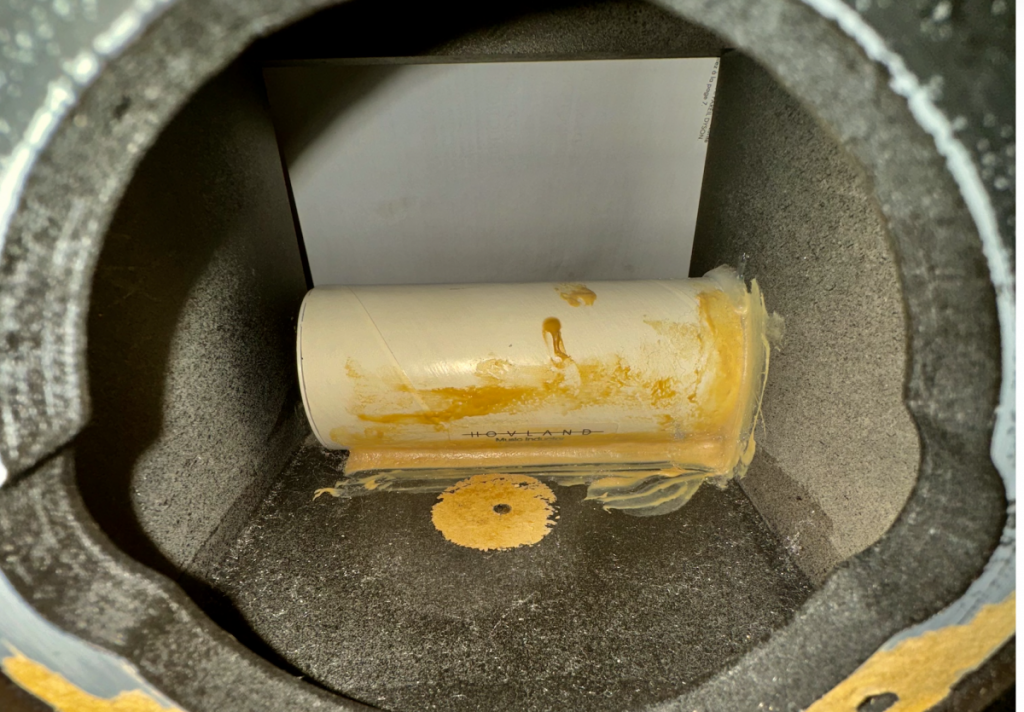

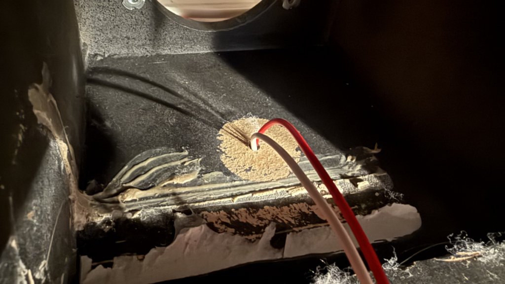

This is a picture of the top chamber of my Merlin VSM speaker.  This chamber is where the crossover and Esotar tweeter were mounted.  These are 2 of Danny's 16ga solid core copper wires.  The circle you see around it is where the hot glue had puddled from the previous wires being fed thru that hole to the woofer in the chamber below.
So, hot glue about the diameter of a quarter and it will flow where it needs to and get happy.  Easy.
The debris behind it is what is left from removing a large Hovland inductor that was in a paper tube.  That required a hammer and chisel.
So, don't go crazy with the glue either...
