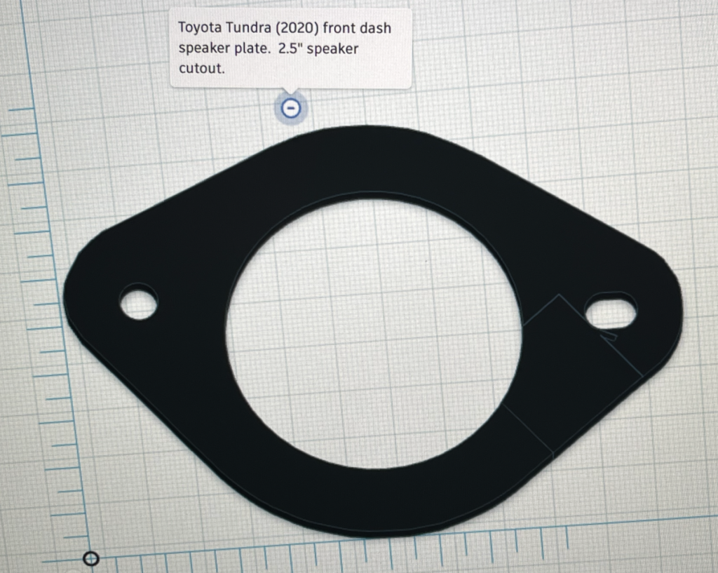

Excellent news. Please post a parts list for us audio voyeurs and if you have an image of the mounting plate post that as well. What software did your son use to create the mounting plate? TinkerCAD?

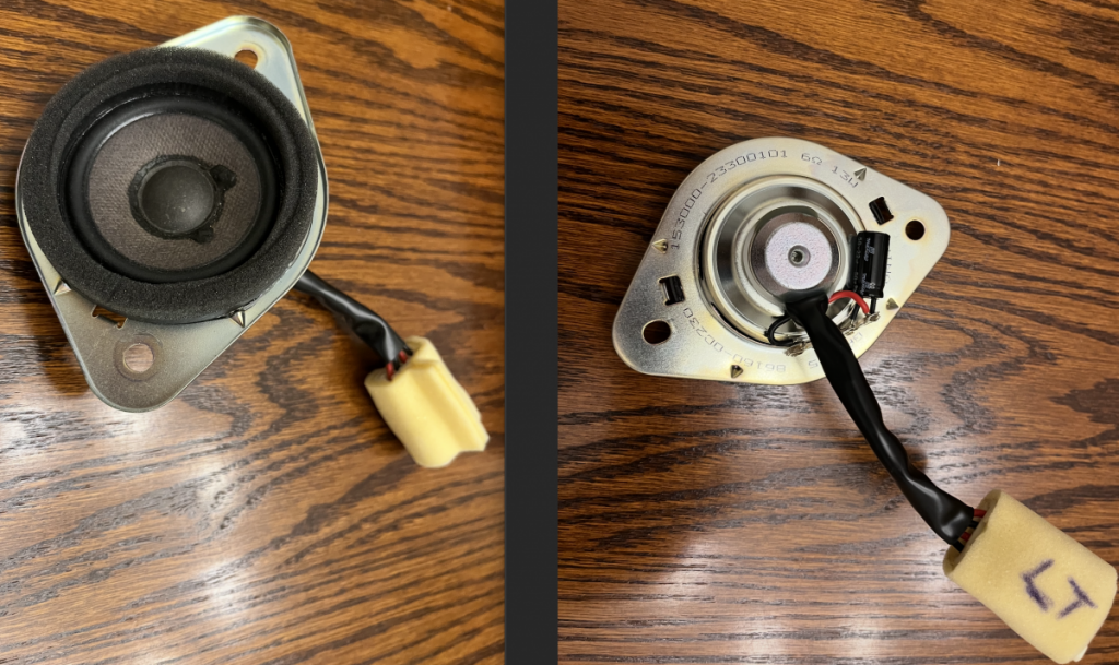

Here is a picture of the stock speakers:
(while Toyota calls this 2.75" speakers... the 2.5" speakers I ordered have exactly the same size cone diameter)
We traced the speaker frame and my son used Tinkercad to create the template.  Print was made with a Bamboo printer:
Putting it all together... I used hot glue to secure the speaker to the frame template.  Connections were all soldered and shrink wrapped.  Sound has been way better than I hoped.
