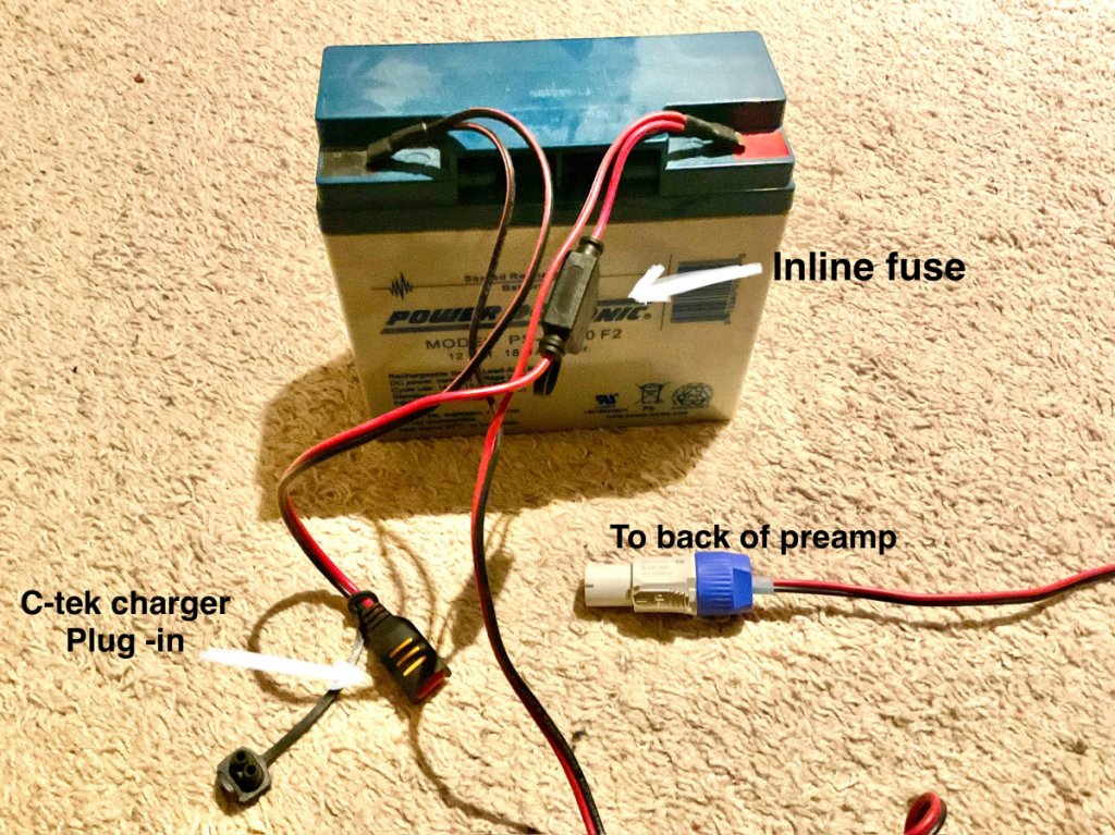

By some stroke of luck i got hold of Dodd preamp/ buffer. Issue is the friend lost the remote and all the cables. I am trying to figure out how to get it working. I am planning to get
https://www.amazon.com/CTEK-40-206-5-0-12-Battery-Charger/dp/B00CD44RQO
for battery i am getting
https://www.amazon.com/Rechargeable-Emergency-Lighting-Security-Terminals/dp/B0180YUC00?th=1
I am still confused how will i connect the batter to the preamp , i know i need to buy some powercon connector
https://www.amazon.com/NEUTRIK-NAC3FXXA-W-L-POWERCON-Power-Locking/dp/B0CQ68NHGY
I am just confused how all this will come together. Like charger and split the cable etc. Any ideas or someone have anything lying around?
Must be noted that DC Voltage is polarized, you must connect the positive battery terminal to the input marked as positive on the equipment.
If connected in reverse, will occur damage to the pre-amp and the battery may heat up.

This is how it is hooked up.
On my Dodd preamp I now use a linear power supply. Good luck
Is there a switch to cut off the charger when using the preamp, or do you have to physically unplug the charger?
ZAKski288
Re: Dodd battery Preamp
« Reply #7 on: 17 Jun 2025, 04:15 am »
Yes, you have to physically unplug the charger.

I have had a Dodd Buffer for a long time and have used it sparingly.
I did not unplug the charger when I used it (it never occurred to me to do so).
How long can (should) you play it unplugged?
I take it that it sounds better unplugged.
Thanks for any info on this.
ZAKski288
« Reply #9 on: 17 Jun 2025, 10:11 pm »
You can play it while it charges, but after it’s fully charger it doesn’t make sense to leave it plugged in and charging. Better to cycle the battery. When I used the battery only, it would last a long time before it died. Then I would charge it till it was fully charged.
