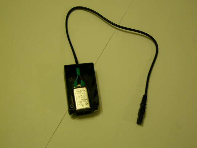

Not sure if this little gismo will work for GK1 but those who own budget DVD/CD player might want to give Jaycar's EMI Power Line Filter a go. For NZ$11.25 it worth every penny and effort.
(If link doesn't work, search for MS4003)
http://www1.jaycar.co.nz/productView.asp?ID=MS4003&CATID=&keywords=filter&SPECIAL=&form=KEYWORD&ProdCodeOnly=&Keyword1=&Keyword2=&pageNumber=&priceMin=&priceMax=&SUBCATID=
It might be small (size of  9V battery), it work. It bring smile back on my face after listening to my lightly mod Pioneer DV667 DVD (563A in North America) player with it. Took me less than an hour to get it fitted and it is staying in my system. This include the time it took me to look for my soldering iron and bit & pieces hidden by my wife.
http://www.audiocircle.com/image.php?id=1703
