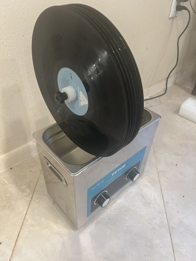

The Vevor device with a spindle full of records draining on top.
I leave it there for 5 minutes then transfer to the drying rack for 1/2 hour.

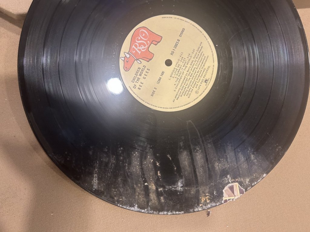

For a record as extreme as this … I dip the damaged portion in the tank… wipe with microfiber towel.
Then run it in the tank.
