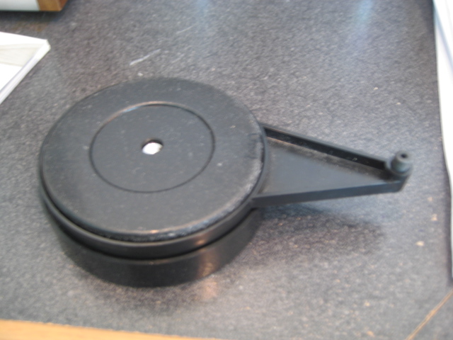

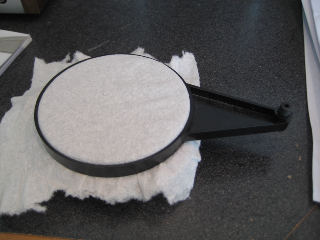

Just last night I found my old Allsop record cleaner but no pads to go with it.
I guess I could use paper towels or Terri cloth for pads.
I was also thinking of using a spray bottle with a little dish soap and water.
Think it'll work ?
No Pad:
Paper towel
WireNut
