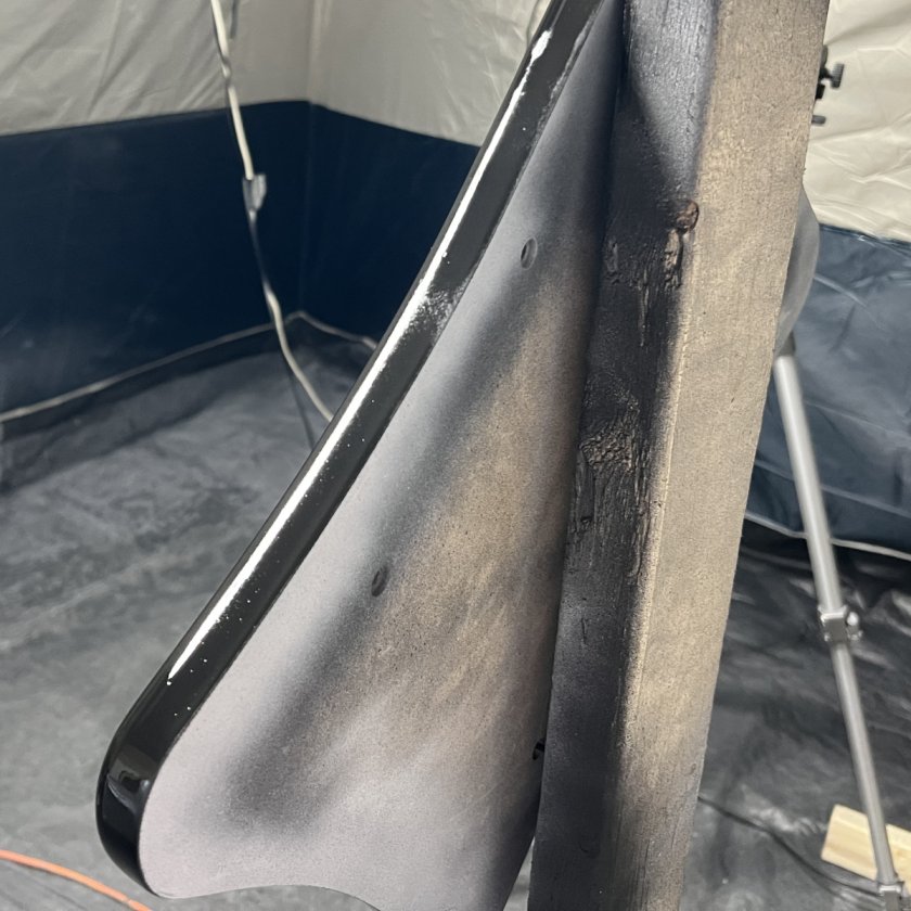

Alright, you've seen all the sanding photos and now it's time to try and build things back up.  I mentioned that nick I found in the base where I did something stupid so I tried to correct that as best as possible without going too crazy.

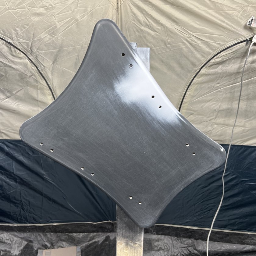

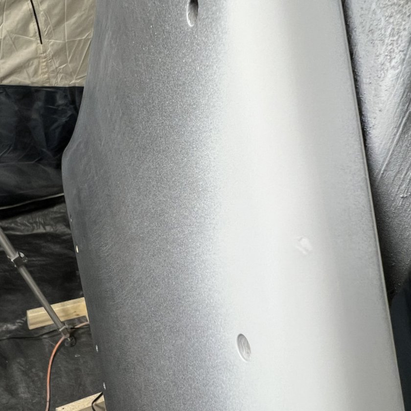

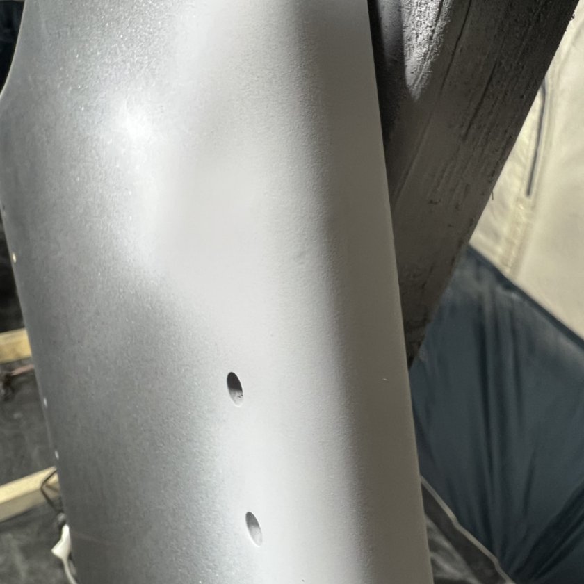

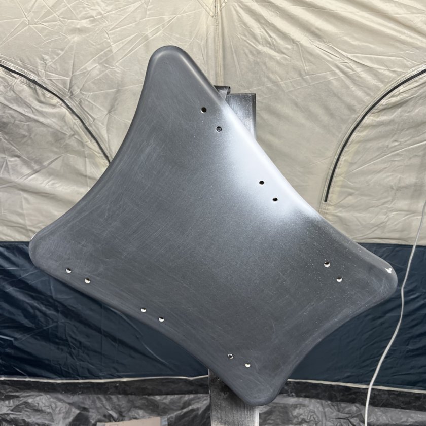

Here's a closeup of right after spraying the first coat of the automotive filler primer
And here's another photo after that first coat dried

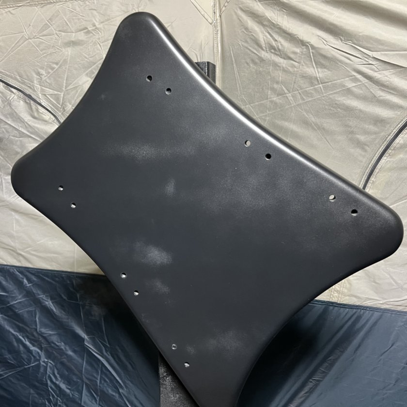

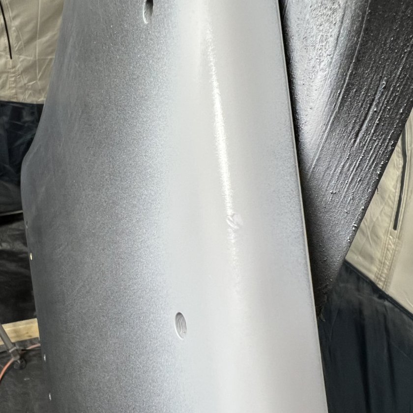

And...here it is after doing three full coats and letting it dry
If we zoom out a little, this is what it looked like after I finished priming the bits that needed it.  FWIW, I ended up priming quite a bit more than I had initially planned on simply because I went through the primer in a few spots right along the bottom edges.  So to make things easier on myself, I just primed anywhere that MIGHT have needed it.  I figured that was better than thinking I got everything and missing something.
Next step, I wet-sanded the prime coat with 800 grit.

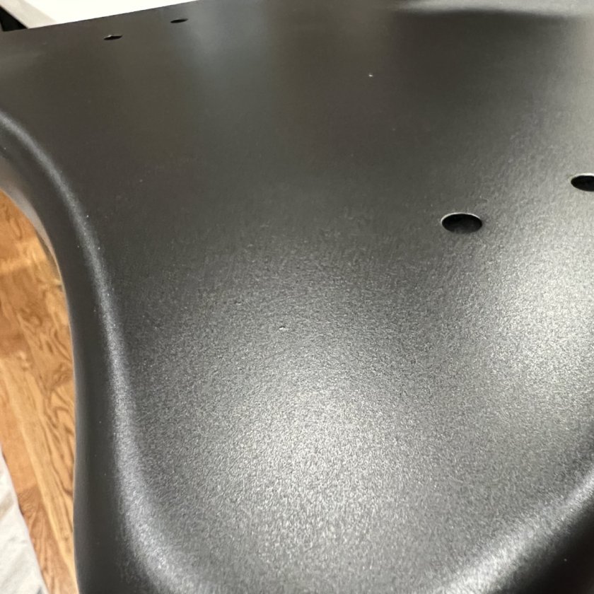

Then it was on to "touching up" the base with black paint.  Due to the amount of primer I had put on previously, it just made way more sense to go ahead and paint the whole thing.  So, that's what I did.
If you look closely more towards the middle of the base, you'll see some of that orange peel look in the wet paint - look near where the light is reflecting off the paint.  It is very likely because I put the paint on a little too thick - not thick enough to develop a run or sag in the paint, but not as light a coat as I probably should have put.
I made sure to paint along that back edge to fix the spots where I sanded through the finishes and the primer.
Having pointed out the orange peel in that photo a couple images up, what I'm deciding to do is let this paint dry completely for 24 hours and then wet sand it using 800 or 1000 to try and eliminate the orange peel.  After doing that, I'll do one more coat of the black paint - this time I'll do a better/lighter coat of the paint (not go on as wet) - wait another 24 hours and then wet-sand that before going onto the clear coat step.

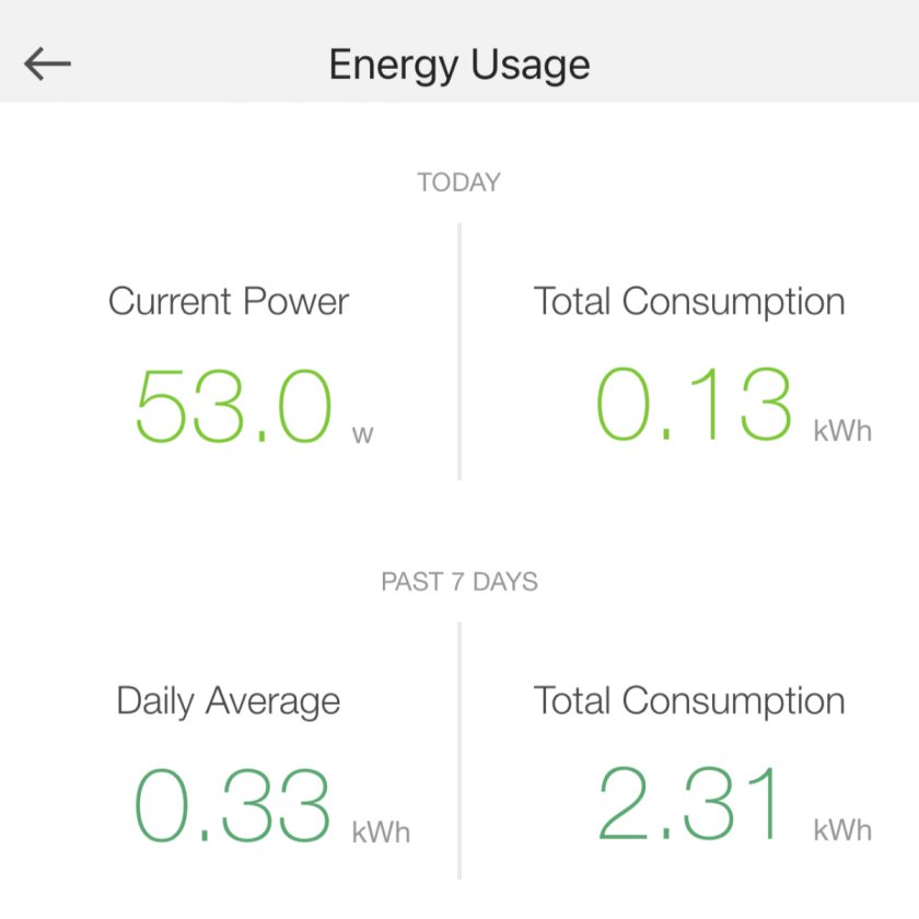

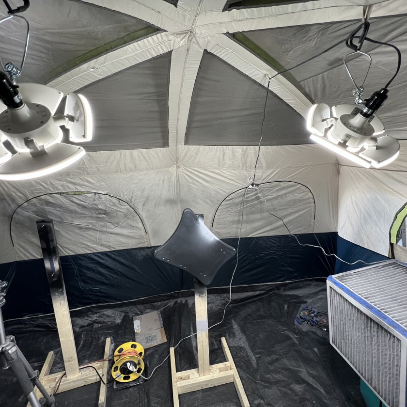

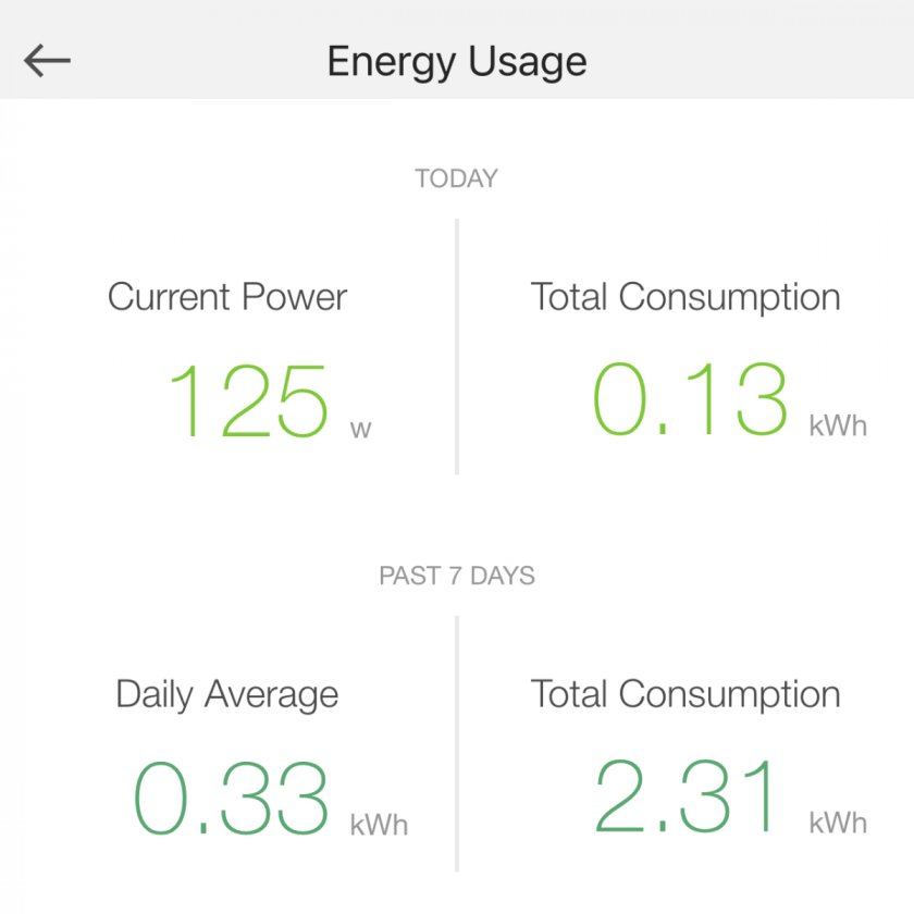

Also, I ended up getting a smart power strip that allows me to see energy being used.  I thought I'd share some of those photos too...as mentioned previously, I bought a two-pack of garage/worklights from Costco that are just awesome.   Here's a wide shot of my setup for spraying:
The energy for just the fan running that is acting as my air cleaner - 53W isn't too bad.
Then, with the lights set on their medium brightness and the fan running
So the interesting thing here is on medium brightness, it's about perfect for working in the tent.  When I had them on the brightest setting, it was almost too bright AND at the full brightness the two lights were using 145W just themselves.  On medium brightness, they're right at 72W combined for the two.
So, knowing that I'm going to be sanding, painting, sanding, clear-coating, sanding, clear-coating...it might be a few days before I have another "real" update.

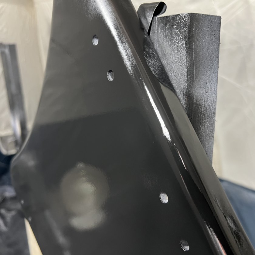

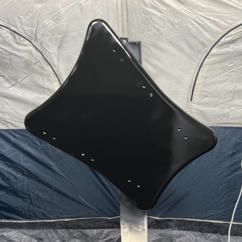

Here's where I finally did it pretty dang good - this is a super close up and it looks like there's some texture in the photo but I can tell you at any (non pixel peeping distance), this looks nearly as good as a factory finish on satin black speakers I have in my house.  It was super exciting to see this - oh, and this is just an hour or so after spraying the first layer of clear...
UNFORTUNATELY, I THOUGHT I could get a whole first coat with what I had left in the can I'd used for the other base and I ran out about 3/4 of the way through painting the flat surface of the base  :duh: You can see about midway up the piece in this next photo where it starts looking cloudy - yeah....that's where I ran out of clear  :cry:

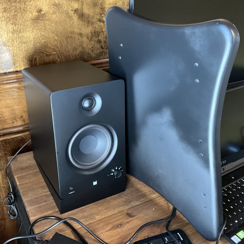

So last night after I posted that new response, I realized that the closeup picture I took of the finish made it look like total garbage - I couldn’t really see it well until I looked at it on a larger screen later…so, I thought I’d share a couple of additional photos that show how good the clear actually does look.  So on the left of each picture you’ll see some off the shelf purchased speakers, and to the right is the base directly touching so you can (or can’t) see the difference in the finish.  Like I said before, IMO, the finish on the base looks reallllllly good.  Good enough that I would be more than happy with it on my finished NX-Tremes.
Full shot of both together - you can clearly (pun) see where I ran out of clear on the bottom of the base…
And here’s a closer in photo that will show you (IMO) just how good the clear looks on the top of the base now that I’ve learned how to apply it properly
It’s crazy how hard it is to take a photo of black and get it to look like it does to your eyes.
Anyways, I hope this illustrates better than my previous post just now nice the base turned out…

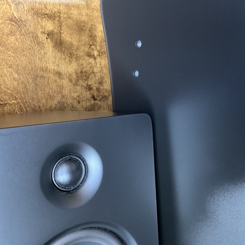

Here's a nice shot showing how nice the black looks just sitting in a room
This shot shows the speaker base of a purchased "black" speaker where you can see that the base is a dark gray but the baffles actually look black - I LOVE how the SprayMax Hot Rod Satin Black turned out!   What you see there is a pretty accurate representation of what my eyes saw - it wasn't that the light was way brighter on that speaker stand, it was just that the black on those baffles was much darker than the paint on that speaker stand...
Here's an extreme closeup of the tweeter...I didn't even notice I had an area in there I need to clean up / smooth out...but, if you look at the surround, you can see just how beautiful that finish turned out - it really does look like a professional paint job!
