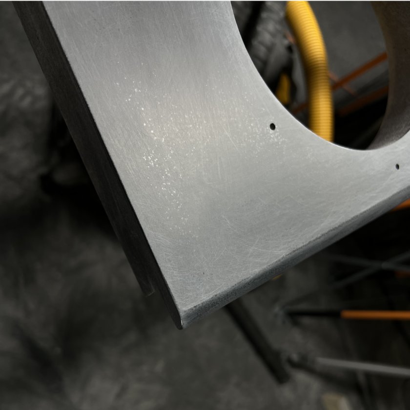

Sanded a Speaker Base - More Lessons Learned
I mentioned that I might buy that Super Assilex sandpaper - I did...
https://amzn.to/4b3SDkp
Unfortunately, it won't be here (some of it), until tomorrow night, and the rest of it this coming Monday  :(

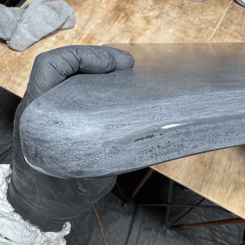

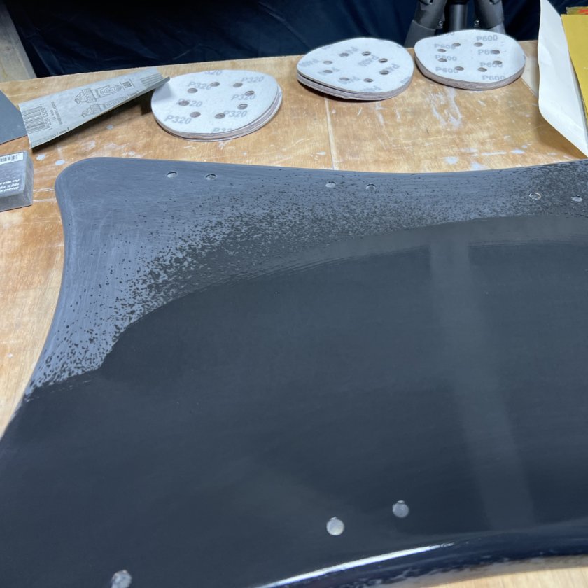

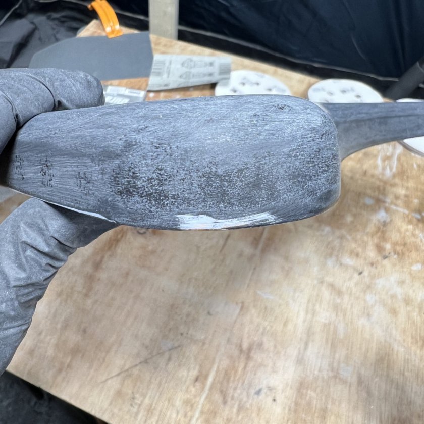

So, to keep the bus moving along, I went ahead and sanded one of the speaker bases.  This time I started with 320 and used it everywhere - BY HAND.  On the top I used the Dura-Block wrapped with 320 grit.
Around the curves and along the sides, I first curved my hand around the edge with the sandpaper sort of cupped in my palm....that was a mistake as I had a fairly long line along the very bottom that went through to the primer.   :duh:
There was a spot that I don't know that I could have avoided - for some reason it just didn't have much clear on it.
Here's another spot where I went though - just got too close to the bottom
Here I wisened up (just a little) and avoided the bottom edge - you can see a thin line where I didn't sand.
I think the biggest takeaway here is DO NOT GO NEAR THE VERY EDGE!!!!. The reality is nobody is ever going to look at a half inch of that thing sitting on the floor and notice anything - so I probably should have left a good half inch completely alone.
And lastly - if you ever get nervous while doing all this sanding, just remember there's a pretty painted piece under there that you just have to do some more work to reveal. If you spray some of that Sprayway cleaner on there, it fills in all the tiny little scratches and gives you a glimpse into the future.
I'm not gonna lie - having never heard these things, with all these time-consuming mistakes I've made, I REALLY hope the journey is worth it in the end!
While I'm waiting on my new (and hopefully amazing) sandpaper to get here, I may switch over and start prepping the veneer, tomorrow, maybe...

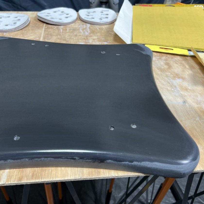

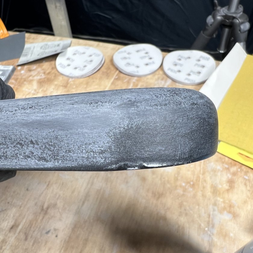

I don’t think I got any intermediate pictures on this last baffle that I was sanding, but in the past I think I mentioned I’d dropped down to 320 grit (regular sandpaper) to try and cut the orange peel faster.  That was still taking way too much time so on the last baffle I dropped down to 220 and that seemed to be the “right” grit.  I did attempt to use the 600 Assilex as the main cutter for the orange peel but it was like using the 320 - it was just taking too long.  Ultimately, I started with 220, then touched up areas that I wanted to be more precise with the 600 Sky Assilex, and then the areas that need to be repainted and cleared, I then hit with 800 Lemon Assilex all around the general area so I can spray the paint, and then come back and do a clear to blend into the surrounding areas.
Like I said, this part is really tedious.  It’s the only part I’ve not really “enjoyed” so much during the build - I think it wouldn’t have been so bad if I hadn’t gotten down to the primer in so many spots that will now require touching up.
Also, being new to the whole finishing with spray cans thing, I’m sure if I was better at it I could have reduced the amount of orange peel that I ended up with, but there’s no way to know the “right” way to do it without actually doing it!
So here’s some photos…

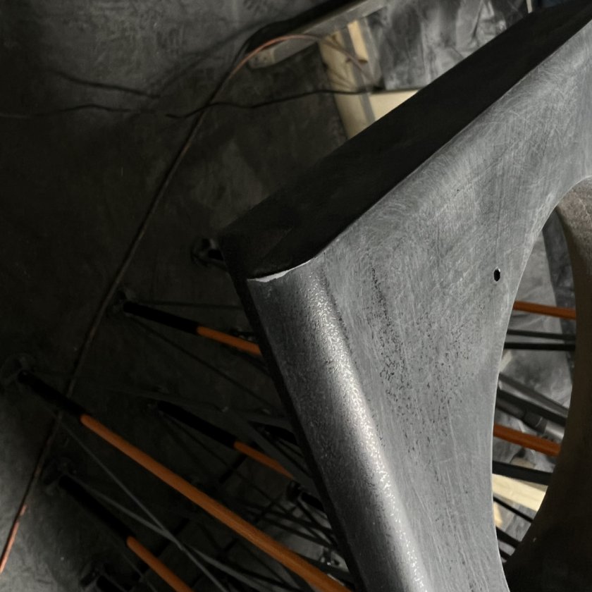

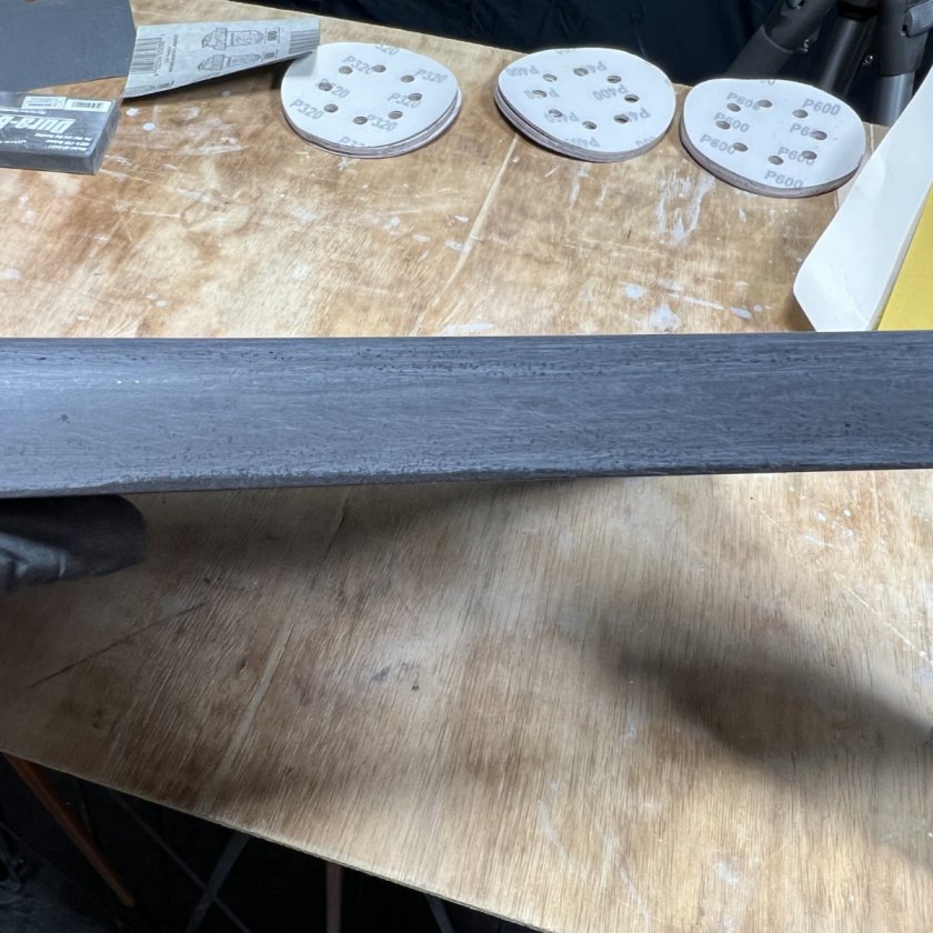

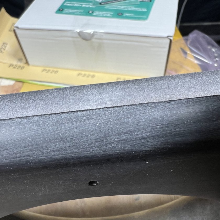

Here I tried really hard not to touch the very edge while sanding the round over on the baffle.  I think I did much better on this one than the first baffle.
A tiny spot at the end of the baffle that needs to be touched up.
Another tiny spot at the other end of the baffle that needs to be touched up.

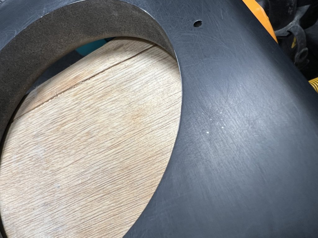

Here’s a shot of the round over where I sanded down to the 600 sky Assilex.

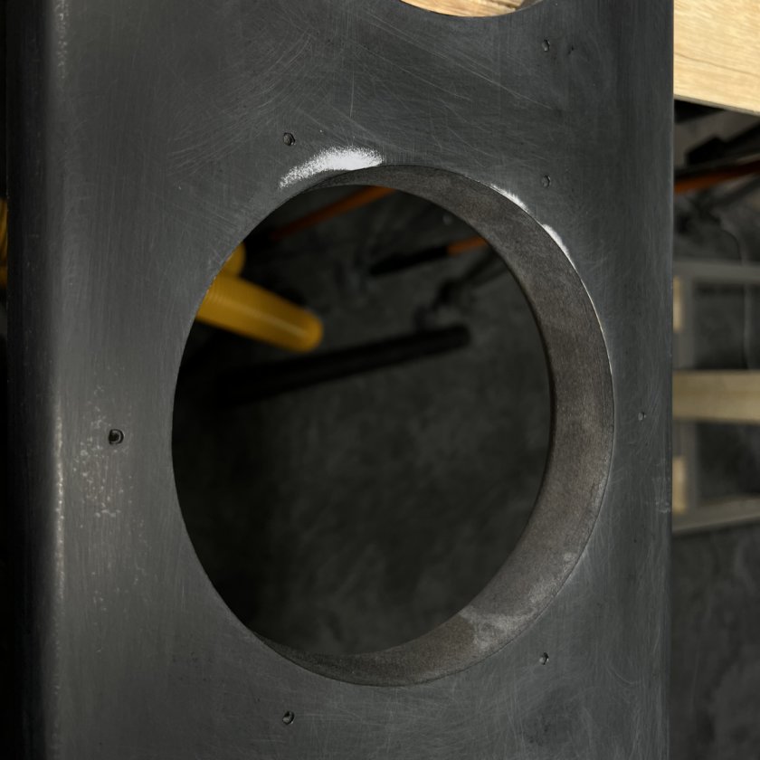

Here’s a picture of one of the speaker openings where I got down to the primer - I think I’ll probably just tape off the baffle later and maybe hit this with a small bit of clear coat - this doesn’t have to be pretty because it’ll be behind the installed drivers.

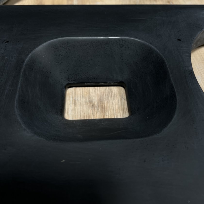

And lastly here’s the wave guide sanded to 800 lemon Assilex and the surrounding area ready to be touched up with paint and clear.
Next up
Someone please tell me if I’m barking up the wrong tree - but my current goal is to sand to 800 lemon Assilex around the areas that need to be touched up - then as nlitworld suggested, hitting it with a scotch pad.  Spray it off with cleaner/degreaser, then just lightly spray the areas to re-cover the primer…then, after that’s filled in nicely, come back and spray a couple coats of clear directly over that and just barely fan it to the surrounding areas so I can sand it back and blend it in when it’s dried.
If that sounds wrong, please let me know.  My guess is I probably won’t make much more progress on this until this weekend.

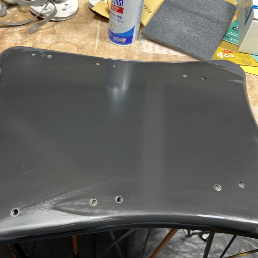

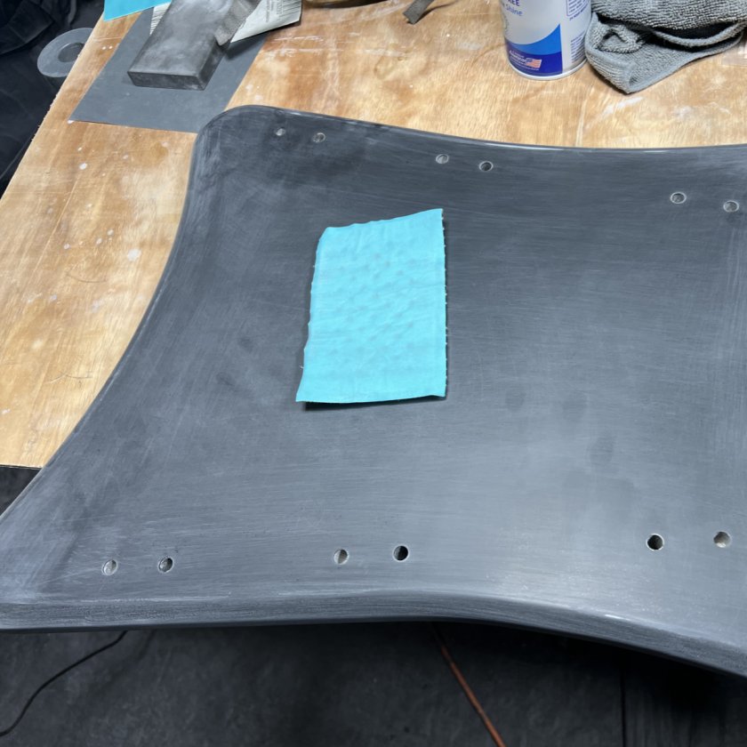

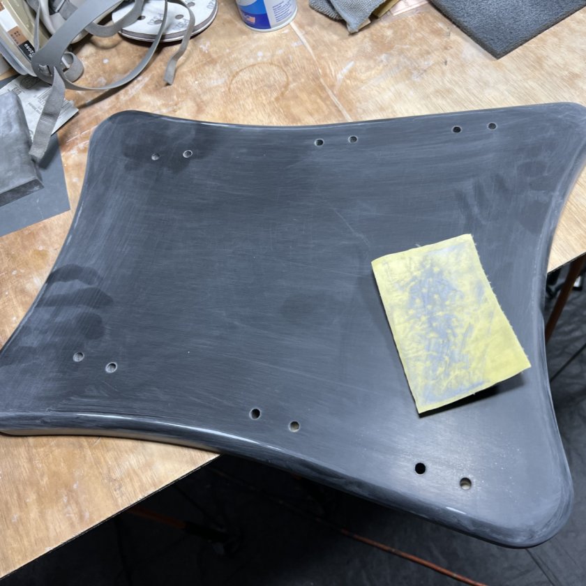

SPEAKING OF learning curve - I think I learned a bit of a lesson.  Now that I've sanded everything back down and am ready to touch up and re-clear-coat...rather than doing them all back to back again, I'm going to just try a base.  The plan over the weekend is to touch up primer in some spots (you'll see why below), touch up paint in many spots (thinking about going along all the edges), and then doing the two coats of wet clear coat on just one base.  First coat, as Lloyd mentioned, get it nice and wet and let it completely flash off which will likely take 15 minutes or so in the cooler weather...then do the same thing for round two.  HOPEFULLY everything will lay out completely smooth with no orange peel...if not, I'll evaluate what I want to do from there.  If things aren't "perfect" (or as good as I want them to be) - I may try my hand at wet-sanding out the orange peel and just going to finer and finer grits of sandpaper - maybe up to 5000 grit and see what that looks like...HOPEFULLY I won't have to do that as I'm really wanting my clear satin to just be beautiful this next go-around.
Anyways, with all that said, here's some more pictures of the progress (regress?!)

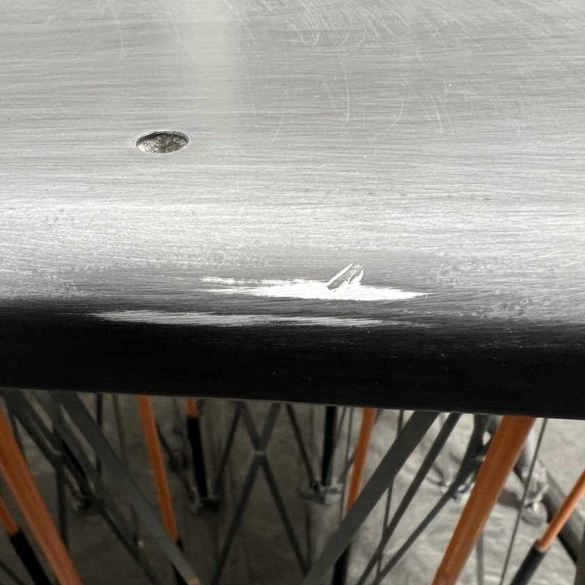

First thing that REALLY frustrated me is I think I remember knocking one of the bases over, and at the time I remember thinking - "I'm not even going to look because I'm going to be mad"...well, I forgot about that until I went back to sand things down...and look at what I did.
That's right, there's a nice little knick out of the side of the base  :cry:
Like Nlitworld said, you can always just sand things back down and do the steps again.

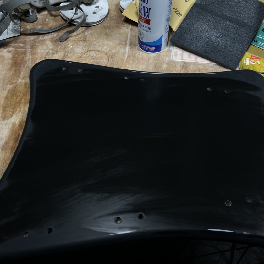

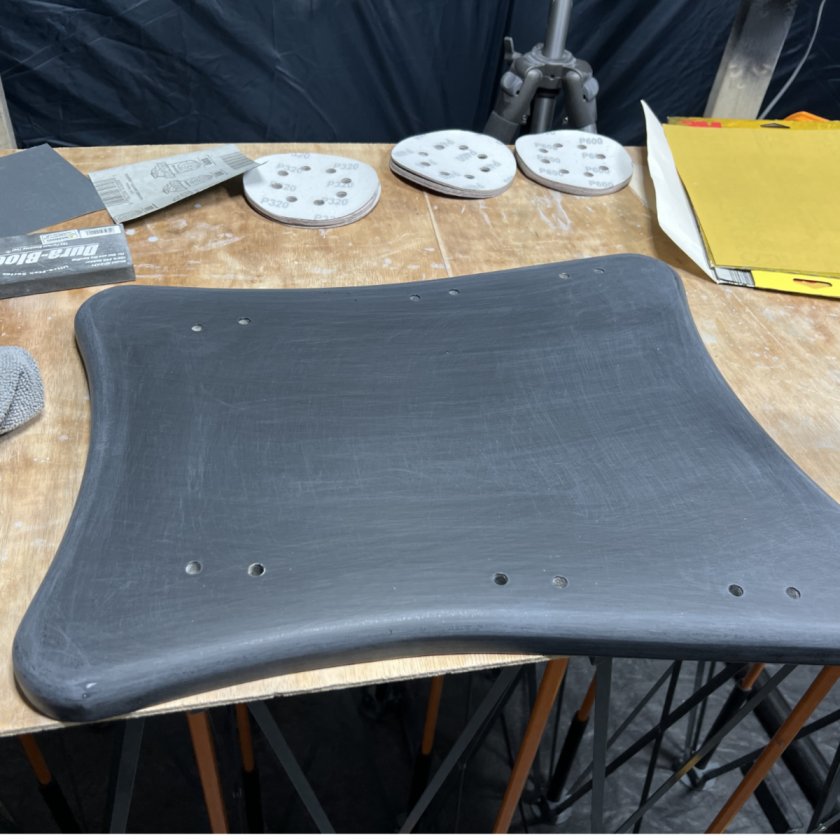

This is where I sanded with the Super Assilex Sky (after already having hit it with 220 to knock off the orange peel).
Then I wiped that down and hit it with the Lemon Super Assilex

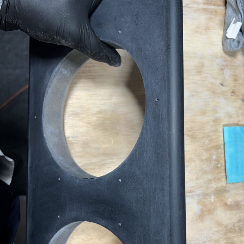

This is what that knick looked like after sanding - you can see there's a tiny little divot in there so I went and bought another can of filler primer that I'll hit that spot with before painting...
After the sanding, I hit it with a Scotch Pad (technically I used a Duragold gray pad as I'd read they are supposedly slightly higher quality with a more consistent micro-scratch) - plus the Duragolds were cheaper to boot.

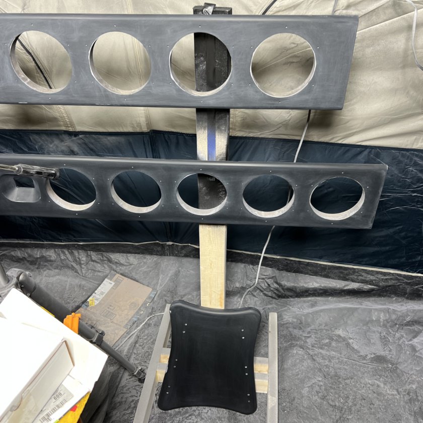

Now I'm mostly back to where I can get to trying to finish everything again - I have the baffles and bases sanded and scuffed and ready to be touched up and re-cleared.
And last shot I adjusted the exposure and took a photo so you can get an idea of how truly black this stuff looks if you went it after sanding - I think these are going to be gorgeous if I can ever do all the steps right  :D
Did I mention I'm REALLY itching to get on with this but I'm TRYING to be patient and do it right?!  I REALLLLLLLLLYYYYY want to get to the veneer and then onto the crossover building because I really would like to hear these things one day!
Again - Nlitworld - I really do appreciate the tips along the way.  I'll get there soon!
