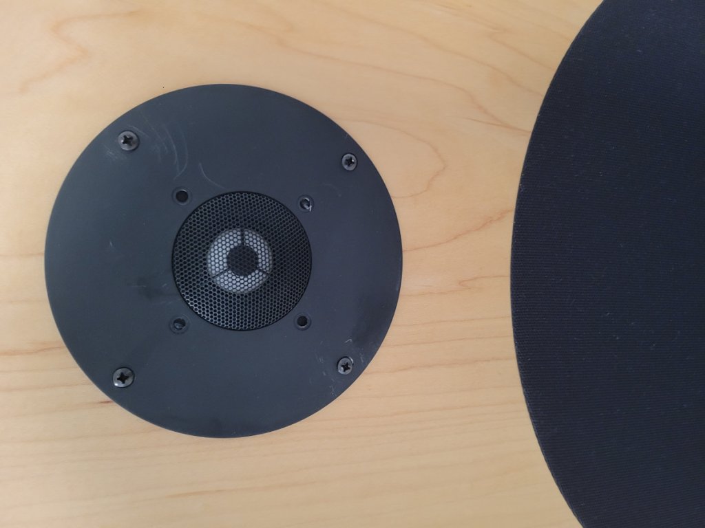

How are they affixed to the mounting plate? It doesn't look like the screw holes in the mounting plate line up with screw holes on the tweeter.
Charles Xavier
Re: Available again: M3 Sapphire tweeter
« Reply #13 on: 1 Feb 2025, 09:04 pm »
Looks like some type of adhesive.
newzooreview
« Reply #14 on: 1 Feb 2025, 09:14 pm »
Makes sense. There are plenty of suitable choices for that.
