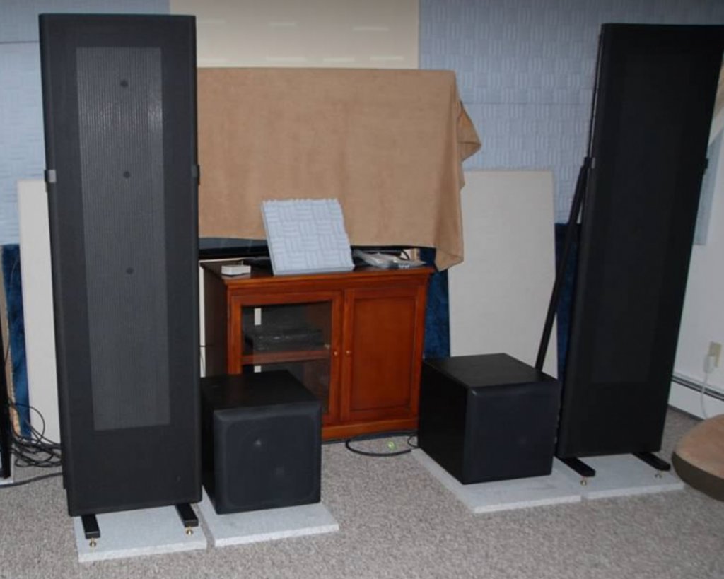

I ordered a pair of Bullies that I should get in January. I will be replacing a pair of Magnepan 1.7s. I have two Rythmik subwoofers that I use with the Magnepans. I was thinking about selling off my old stuff, but now I wonder if I should keep both subs and get two splitters for my preamp and have basically four subs. Am I nuts? Are four subs better than two? :green:

Is it “ok” to replace the Maggie’s with the Bullies and keep the Rythmik subs between the speakers? I really don’t have room to move them,

You can use them in addition to the Bully's. However, moving them to the rear of the room and running them out of phase with the woofers in the Bully's would do away with a lot of room modes and even out bass response very nicely.
