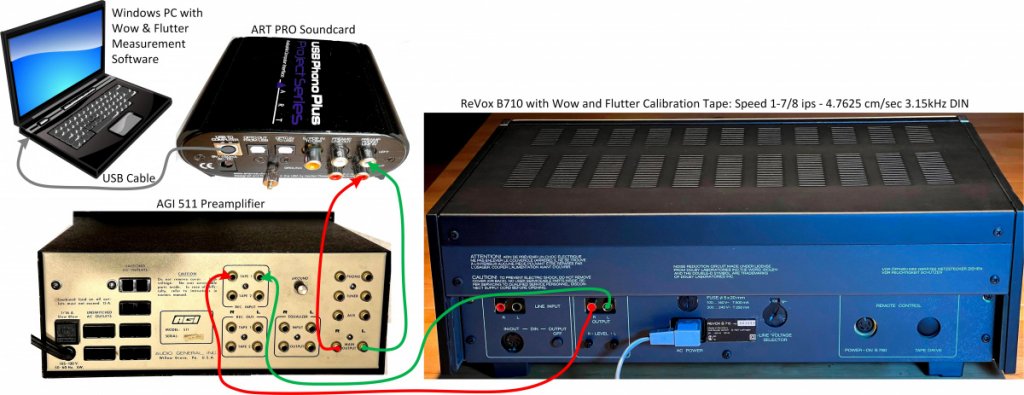

* The equipment setup for all W&F tests described in report "ReVox B710 Tape Deck - Successful Wow & Flutter Restoration" using the AnalogMagik software program is shown in Figure 1.
* A preamplifier having RIAA phono equalization, together with the recommended ART Pro Soundcard is required for interfacing with the AnalogMagik turntable/cartridge test package. While RIAA phono equalization is not needed with tape signals, I retained the same preamplifier for signal boosting and setup consistency. (Successful restoration of this vintage preamplifier is documented in report "AGI Model 511 Preamplifier Restoration" https://www.audiocircle.com/index.php?topic=186321).
Figure 1. Outputs of B710 Tape Deck to Preamp, Preamp output into Soundcard connected to Windows PC by USB cable.
* To minimize any variables between the two test configurations, the same equipment setup shown in Figure 1 was retained for the W&F tests using the WFGUI program.  The only difference between the two equipment setups was the W&F test program running on the Windows PC.

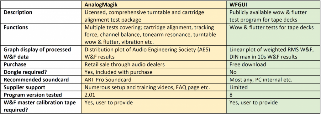

* A basic comparison of features and characteristics of the two W&F test programs is listed in Table 1.
Table 1. Comparison of AnalogMagik Turntable/Cartridge and WFGUI Programs.
* In my case as I already owned and had experience with the AnalogMagik program in the setting up and fine tuning of my vintage ReVox B790 and Oracle Premiere turntables, it made sense to take advantage of its AES W&F processing to evaluate my B710 tape deck.  My additional cost was just the W&F master calibration tape.
* Note there will be differences with; processing standard (AES, DIN, RMS etc.), usability, performance, support etc. between a licensed multipurpose test program designed for turntable and cartridges, and a free download W&F test program developed for tape decks.  Nevertheless, both programs proved useful and straightforward to use and would likely benefit most tape deck users for basic W&F measurements.

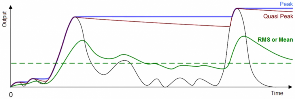

* There is a nice diagram (Fig. 2) on the site "Reflective Observer - Wow & flutter explained", which I found very helpful in explaining the different measurements. The Y-axis (no scale) labelled "Output" represents the measured voltage level or signal amplitude. The coloured label "Quasi Peak" in the diagram has also been described as "Weighted Peak".
Figure 2. Explanation of measurements: Peak, Quasi-Peak, RMS or Mean - courtesy Reflective Observer - Wow & flutter explained.

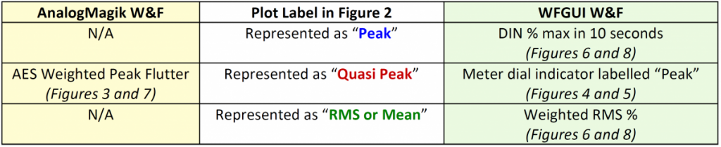

* The following Table 2 describes how the plot examples in Figure 2 relate, in general, to the W&F measurements in this report.
Table 2. Examples of W&F relationships depicted in Figure 2.

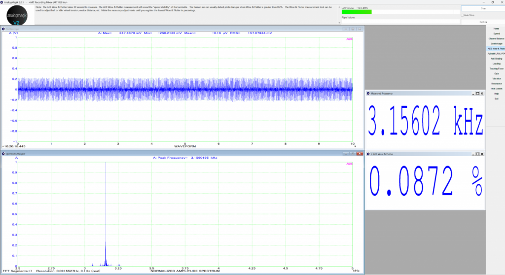

* An example of an Audio Engineering Society W&F measurement is shown in Figure 3. (This is similar to "Figure 15. Example of a final W&F measurement" shown in report "ReVox B710 Tape Deck - Successful Wow & Flutter Restoration").
Figure 3. Example of AES W&F measurement acquired using AnalogMagik with Tape 1.
* A total of ten (10) AES W&F measurements were acquired. From this sample size of 10 gave a mean value AES W&F of 0.088%, with standard deviation 0.006.

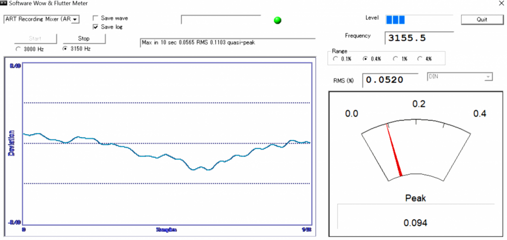

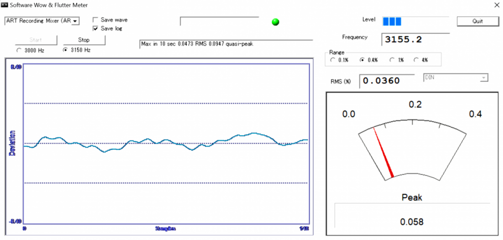

* Using the identical equipment setup and same W&F master calibration tape from the AnalogMagik test, approximately 5-minutes of continuous data were logged to text file.  Important WFGUI settings selected were DIN, 3150 Hz, and Save log.
* Throughout this 5-minute recording session, a total of fifteen (15) screen captures were acquired. Screen capture examples of a low W&F value and a high W&F value are shown in Figures 4 and 5, respectively.
* Note, the WFGUI signal panel displays a light blue trace against a dark blue background, which can be hard to read and the dark blue colour when printing consumes extra toner ink.  To improve this, I removed the dark blue background using the graphics software CorelDRAW function, "Effects -> Adjust -> Replace Colors".
Figure 4. Example of a low W&F value acquired using WFGUI with Tape 1.
Figure 5. Example of a high W&F value acquired using WFGUI with Tape 1.
* Although all relevant data is available, I found some of the nomenclature used in the WFGUI labelling confusing.  But not to complain, I'm grateful it's offered as a free program.
* From reading the Meter panel box labelled "RMS (%)" values, and the Meter dial indicator labelled "Peak" values (with "DIN" selected, presume this is meant to be Quasi-Peak, also referred to as Weighted-Peak), the Mean and Standard Deviations were calculated for this sample size of 15 screen captures.
- Mean value of the WRMS W&F was 0.046%, with standard deviation 0.006.  As a cross-check, the data saved to Log file produced a mean value WRMS W&F of 0.044% with standard deviation 0.007, in close agreement.
- Mean value of the Quasi-Peak/Weighted-Peak W&F was 0.081%, with standard deviation 0.010.

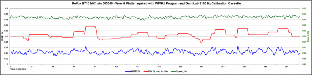

* Next, the data saved to Log file was imported into Excel and plotted as shown in Figure 6.
Figure 6. W&F plot from WFGUI log file data using Tape 1 - Weighted RMS %, DIN % max in 10 seconds, Speed-Hz.

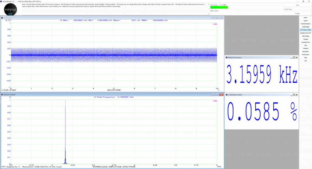

Figure 7. Example of AES W&F measurement acquired using AnalogMagik with Tape 2.
* A total of thirty-two (32) AES W&F measurements were acquired. From this sample size of 32 gave a mean value AES W&F of 0.057%, with standard deviation 0.006.

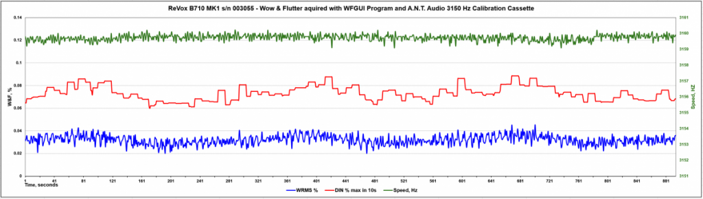

* As before, using the identical equipment setup and same W&F master calibration tape from the AnalogMagik test, approximately 14-minutes of continuous data were logged to text file.  Again, the same important WFGUI settings selected were DIN, 3150 Hz, and Save log.
* Throughout this 14-minute recording session, a total of twenty-nine (29) screen captures were acquired (not shown).
* From reading the Meter panel box labelled "RMS (%)" values, and the Meter dial indicator labelled "Peak" values the Mean and Standard Deviations were calculated for this sample size of 29 screen captures.
- Mean value of the WRMS W&F was 0.033%, with standard deviation 0.006.  As a cross-check, the data saved to Log file produced a mean value WRMS W&F of 0.032% with standard deviation 0.004, in close agreement.
- Mean value of the Quasi-Peak/Weighted-Peak W&F was 0.056%, with standard deviation 0.007.
* Finally, the data saved to Log file was imported into Excel and plotted as shown in Figure 8.
Figure 8. W&F plot from WFGUI log file data using Tape 2 - Weighted RMS %, DIN % max in 10 seconds, Speed-Hz.

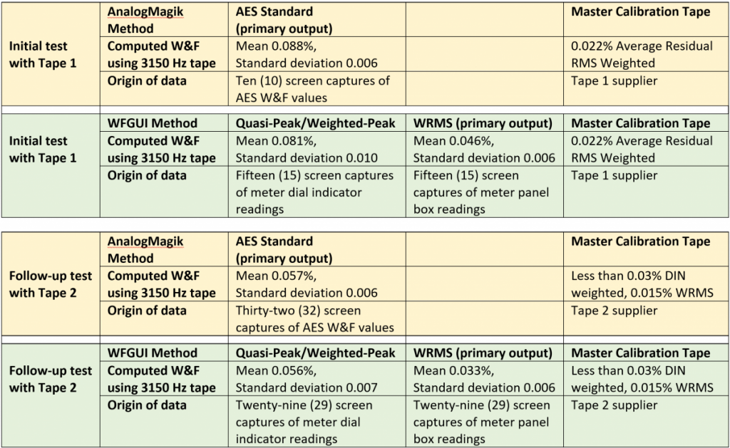

Summary of W&F Results
Table 3. Results of the W&F measurements: AES, Quasi-Peak/Weighted-Peak, and WRMS.
* From reading the Audio Engineering Society standard, the original version AES6-2008 - quasi-peak method was updated in 2012 to version AES6-2008 (r2012) 2-sigma statistical method, providing a more reliable and stable analysis, now referred to as Weighted Peak Flutter.
* Encouraging to see from this data set was the close numerical agreement of the AnalogMagik AES W&F value 0.088% vs. the WFGUI Quasi-Peak/Weighted-Peak W&F value of 0.081% using Tape 1, and AnalogMagik AES W&F value 0.057% vs. the WFGUI Quasi-Peak/Weighted-Peak W&F value of 0.056% using Tape 2.
* The relationship of the different waveforms shown in Figure 2 correlate with the observations from this WFGUI data set, i.e. Maximum Peak >  Quasi-Peak/Weighted-Peak  >  RMS.
* An interesting observation from the WFGUI data set, the WRMS W&F values (0.046% and 0.033% for Tape 1 and Tape 2, respectively), in numerical terms, are about half the Quasi-Peak/Weighted-Peak W&F values (0.081% and 0.056% for Tape 1 and Tape 2, respectively). Quoting from the Reflective Observer, "In practice, RMS value is usually about one half of quasi-peak value."
