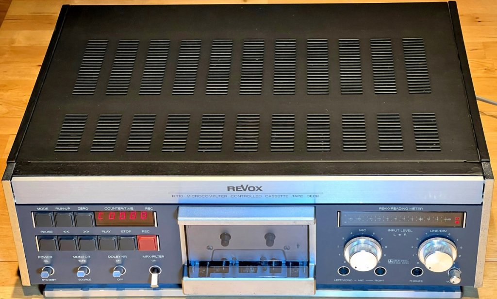

Figure 1. Front view of restored B710 MK1 Cassette Tape Deck - photo taken January 2023

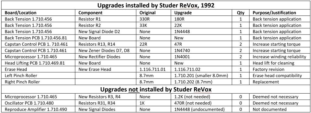

* Overlooked at the time of kit ordering, my B710 had been repaired by Studer ReVox back in 1992, where the erase head was changed to new type necessitating a smaller size 8.0mm left pinch roller (right side pinch roller remained the same size at 8.7mm and installed without issue).
* Reporting this finding back to Nagravox, I was kindly supplied free of charge a new replacement smaller size left pinch roller which I installed without issue - I thought that was very good service.

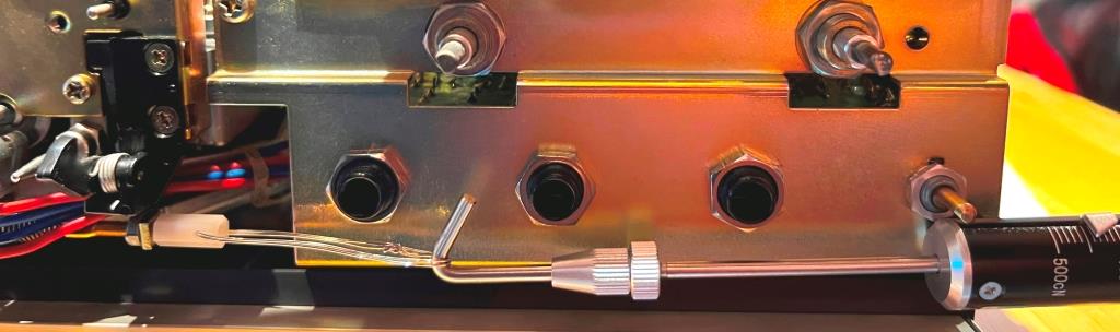

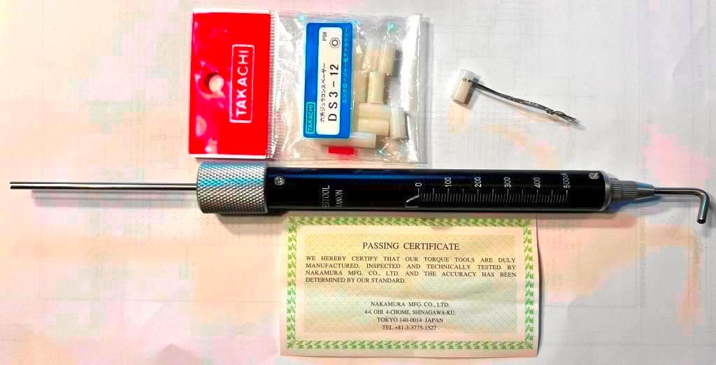

* To adjust the pinch roller force, I purchased a pull-tension gauge made by Nakamura Mfg., model KANON TK500CN (Fig. 2), where the number 500 indicates a maximum reading of 500 centi-newtons (5N).  This is a good match for measuring the left-hand and right-hand recommend pinch roller force of 300cN (3.0N) and 480cN (4.8N), respectively.  For horizontal measurements, the tension gauge is supplied with a compensation chart. With model TK500CN, 30cN must be added to the measured value when the tension gauge is deployed horizontally.
* Next, I purchased a set of 12mm length nylon spacers having M3 internal threads, then drilled a thru-hole to fit a pull wire (Fig. 2).  M3 is the thread size of the two pinch roller adjustment set screws and these mated perfectly with the threaded nylon spacer.  A small loop was made in the pull wire to attach it to the tension gauge's hook.
Figure 2. Tension Gauge model KANON TK500CN (Left), M3 nylon spacer with looped pull wire (Right).
* Pressing the front panel Red "CLEAR" button to engage the pivoting carrier, then gently pulling on the tension gauge until the square adjustment nut just lifts, the corresponding pull tension can be seen (Fig. 3).
Figure 3. Setting the right-hand Pinch Roller tension to the recommended 480cN (450cN + 30cN horizontal correction factor)

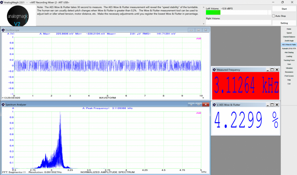

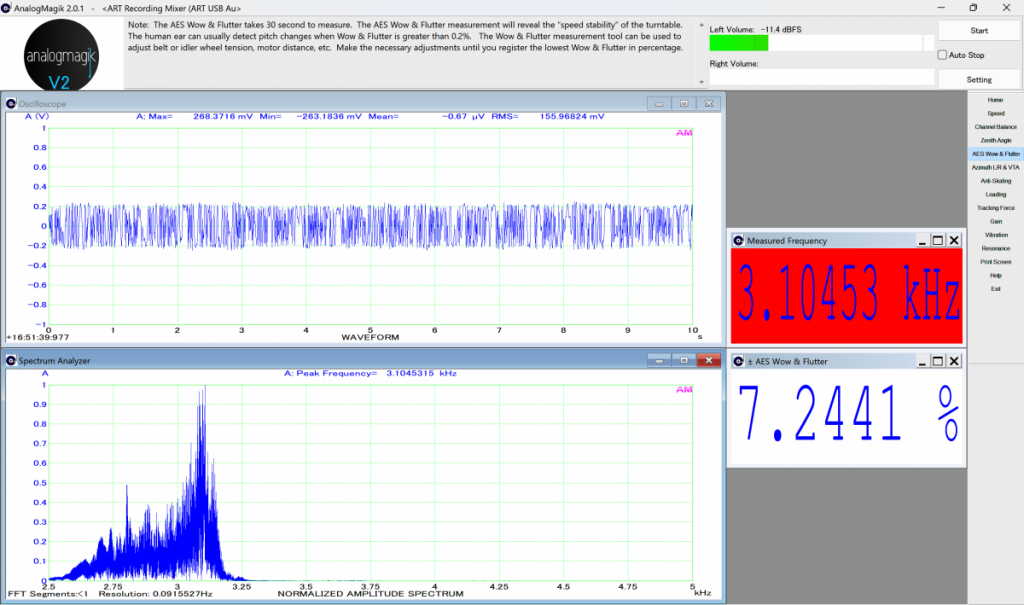

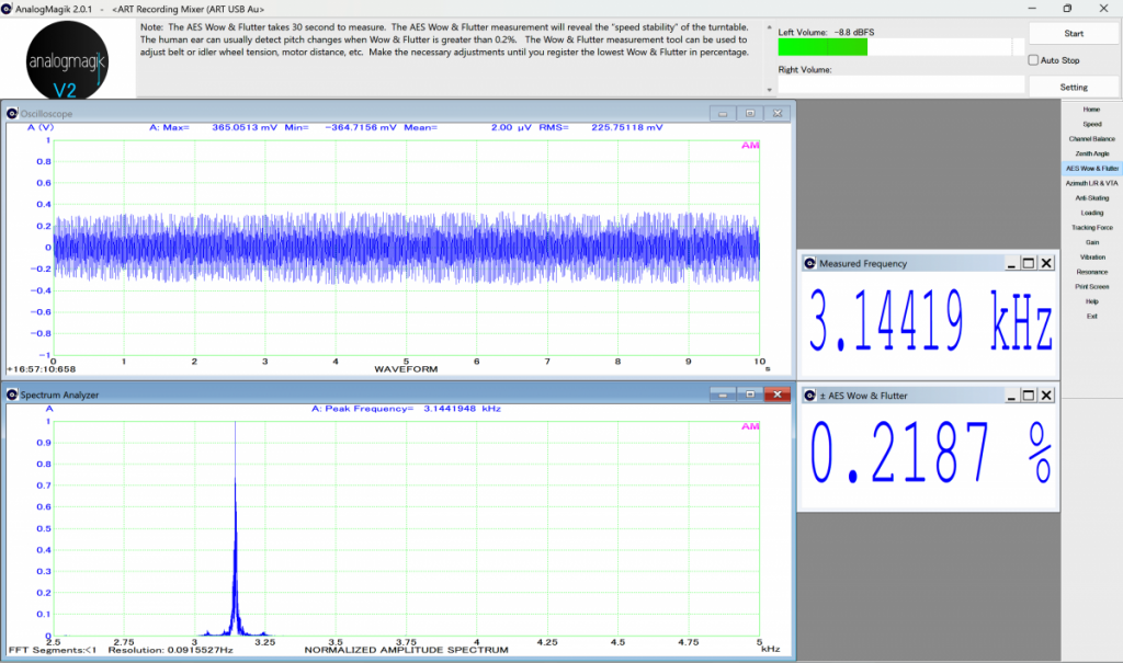

Initial W&F result
* While adjustment of each pinch roller force is straightforward by turning its square nut accordingly, no matter what each pinch roller force was set to the wow & flutter was terrible (Fig. 4), to the point that when the unit had warmed up playback was unlistenable.
* Obviously, this was not a useable situation and so next step was to service the capstan motors.
Figure 4. Initial example of an AES poor W&F after warmup - not good.

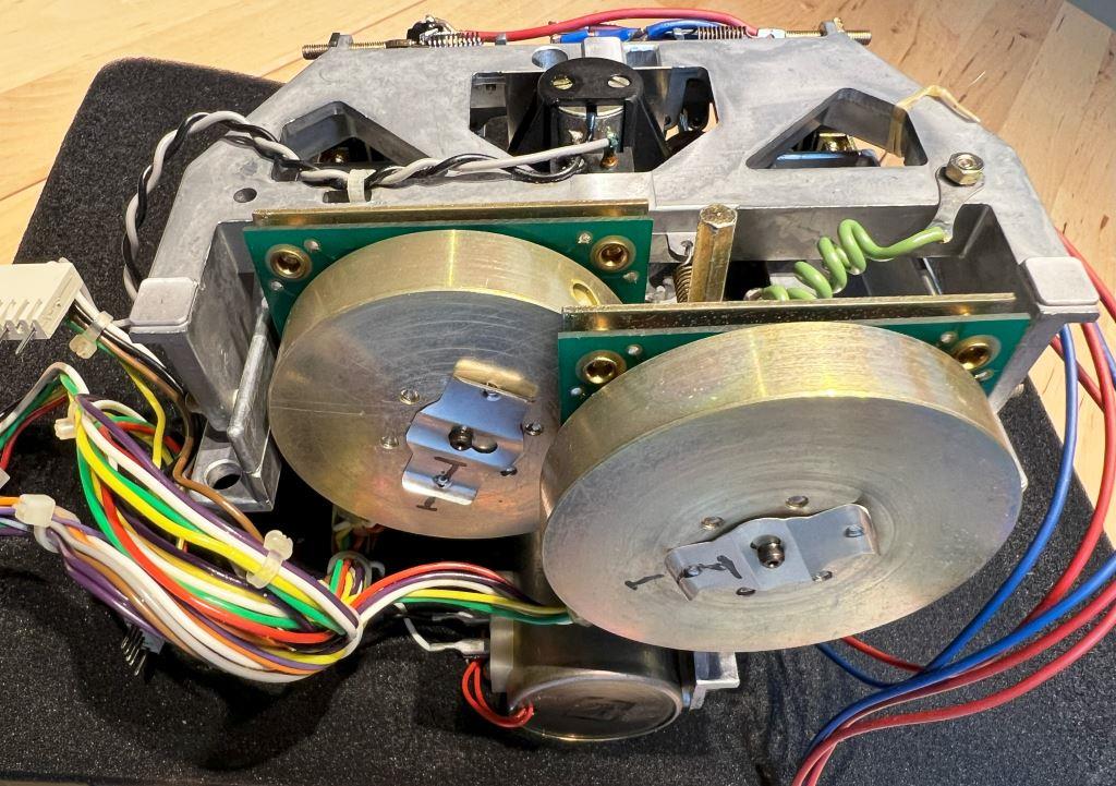

* It's a delicate task to remove the tape drive chassis and perform this servicing, extreme care is required.
* To preserve factory W&F settings, the original positions of the shaft lock clips were marked on each flywheel (Fig. 5).
Figure 5. Flywheel shaft lock clips marked with original factory positions - tape drive chassis resting on soft foam sheet.

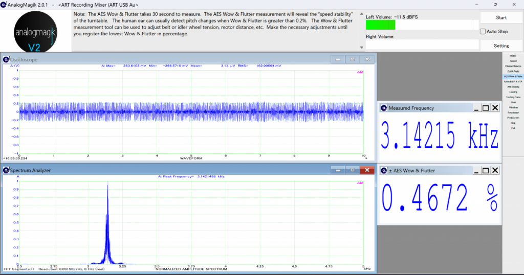

* Each capstan shaft was carefully removed, cleaned and lubricated with fresh PDP65.
* Likewise, the sintered bearings were carefully cleaned and lubricated with fresh PDP65.
* After reassembly paying attention to the correct order and orientation of all parts, there was an improvement in W&F measurements (Fig. 6).
Figure 6. Following example of an AES poor W&F after capstan motor service - still not good.

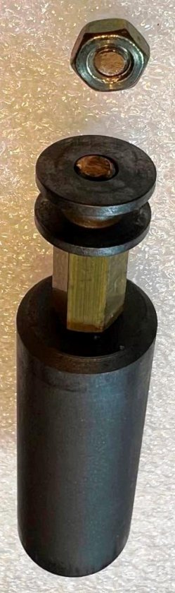

Figure 7. Solenoid Plunger, threaded shaft sheared
* Finally, after some months I could receive a used solenoid plunger, installed and adjusted it to the correct position as described in service manual section 3.4.5.

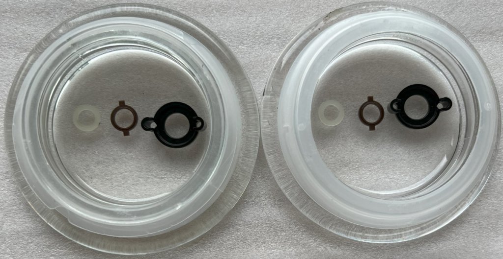

New POM Thrust Bearings
* After receiving new low friction POM thrust bearings, the tape drive chassis was again carefully disassembled and the capstan motor service performed, replacing the original thrust bearings (1.021.510.14, Fig. 9) with new POM type (1.021.520.20).
Figure 9. Original capstan bearing parts replaced - from L to R; Front Sealing Washer, Thrust Bearing, Flange
* After changing to the new POM thrust bearings and performing the service again with fresh PDP65 lubricant it resulted in the W&F being further reduced (Fig. 10).
Figure 10. Example of an AES W&F after servicing and installation of new POM bearings.

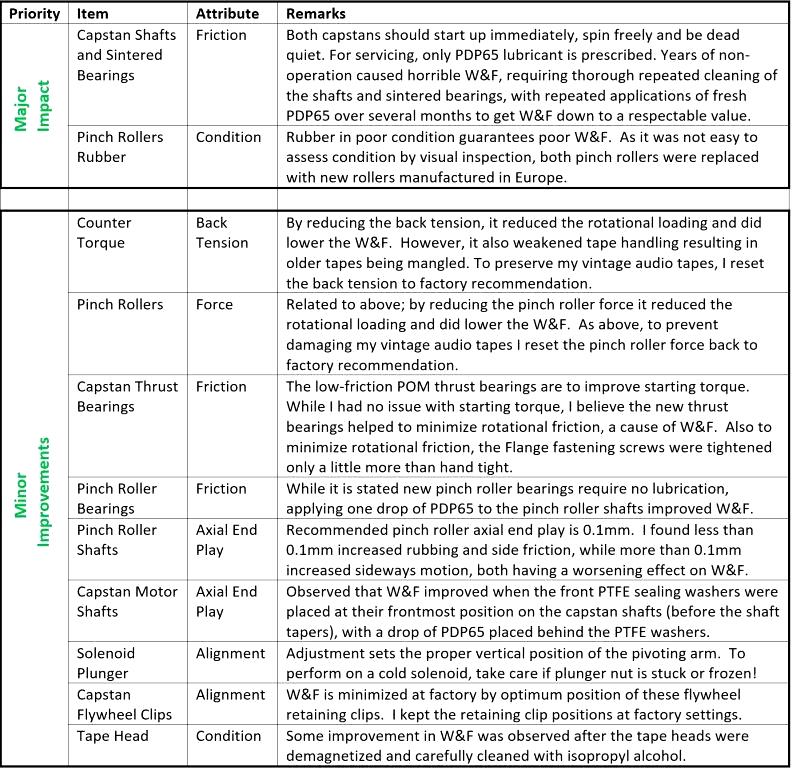

* A summary of my investigations and findings is listed in Table 1., all these efforts played a part in bringing the W&F measurements to within manufacturer specifications.  The pinch roller condition and proper lubrication was observed to have the biggest impact, but even the "Minor Improvements", while on their own only contributed a small amount, when taken together these improvements were also substantial.
* Please note this is not a comprehensive list, there could be other factors that affect W&F, this is only to share my experiences and what worked for me.
Table 1. Summary of W&F investigations and improvements.

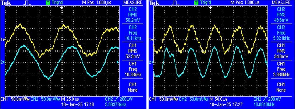

* Lastly, the reproduce head azimuth was optimized using another GennLab calibration tape for this purpose. With pre-amp switched to Mono mode to combine both channels, using a non-magnetic screwdriver the reproduce head adjustment screw was rotated for maximum amplitude on the oscilloscope traces (Fig. 14).  In this case, the adjustment screw was turned approx. 30 Deg. CCW.
* Minimum phase between the two channels was then confirmed on the oscilloscope traces by switching the pre-amp back to stereo mode (not shown).
* While the azimuth optimization did not appear to affect the W&F, it made a remarkable improvement in the audible high frequencies when listening to music.
Figure 14. Reproduce Head Azimuth adjustment, 10 kHz calibration tape, Mono mode. Before (left), Amplitude optimized (right).

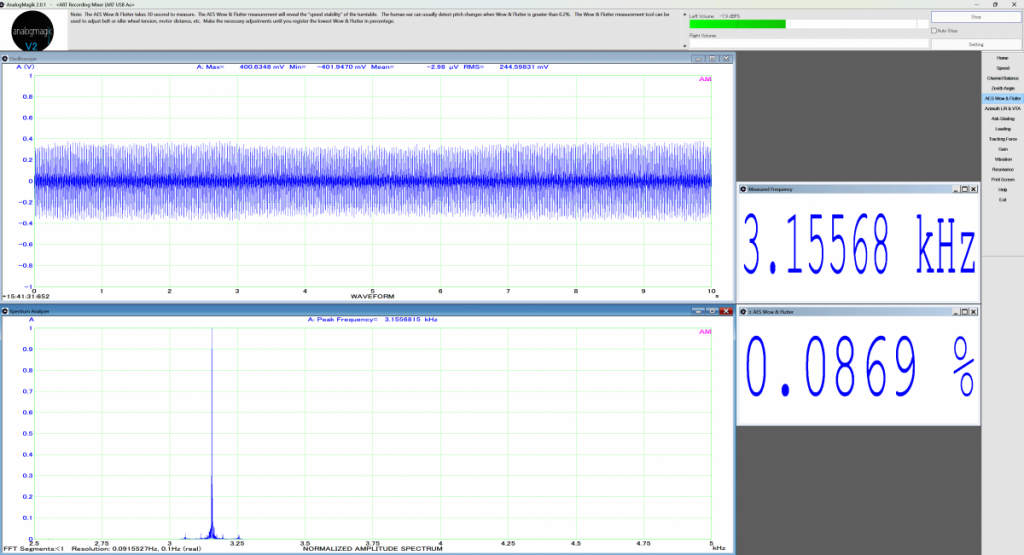

* Final W&F measurements were made with the pinch roller force and back tension at manufacturer recommendations, the final capstan motor service performed, and reproduce head azimuth alignment performed.  Figure 15 shows a typical example, compared to the initial measurement (Fig. 4), this represents roughly two orders of magnitude improvement in the W&F measurement. There is also a small boost in signal amplitude, presume coming from the azimuth optimization.
Figure 15. Example of an AES final W&F measurement.

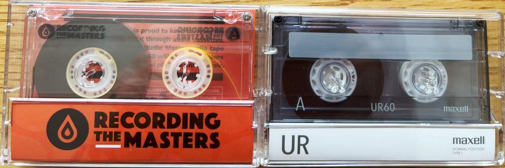

* My initial challenge was not technical, but commercial. Back in the day there were numerous choices for purchasing blank cassette tapes of all types, but these days the supply is limited.  Fortunately for this test, I found two cassette tape brands available locally for purchase, Recording The Master series and Maxell UR series (Fig. 16).   Both cassette tapes are IEC Type I, Normal Bias.
Figure 16. New cassette tapes purchased for this test, Recording The Masters C60 (left), Maxell UR60 (right).

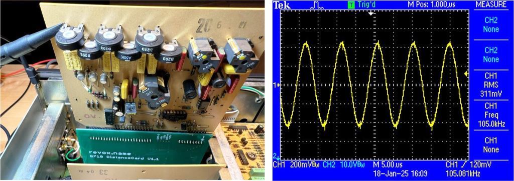

* As all my earlier efforts focused on restoring the tape drive mechanism, I had overlooked the recording section. To ensure the recording mode was functioning correctly for this test, both the bias/erase frequency and the record head azimuth alignment were confirmed.
* With the oscillator board connected through extender card (Fig. 17), the center transformer's trimmer slug allows adjustment of the bias/erase frequency, specification 105 kHz +/- 1 kHz.   While the measured frequency of 105.2 kHz was well within specification, with minor adjustment it was brought back to 105.0 kHz.
Figure 17. Oscillator board on extender card (left), final oscillator frequency after adjustment (right).

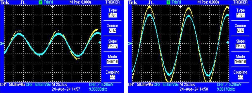

* Next, the record head azimuth alignment was monitored by feeding a low level 3.5 mV (-20 dBu on Peak Reading Meter), 10 kHz sine wave signal into the Line Input, with MONITOR switch set to TAPE position during tape Recording.  Turning the record head adjustment screw by approx. 10 degrees CW was sufficient to align the phases of the Left and Right channels (Fig. 18).
Figure 18. Record head azimuth before phase alignment (left), and after phase alignment (right).

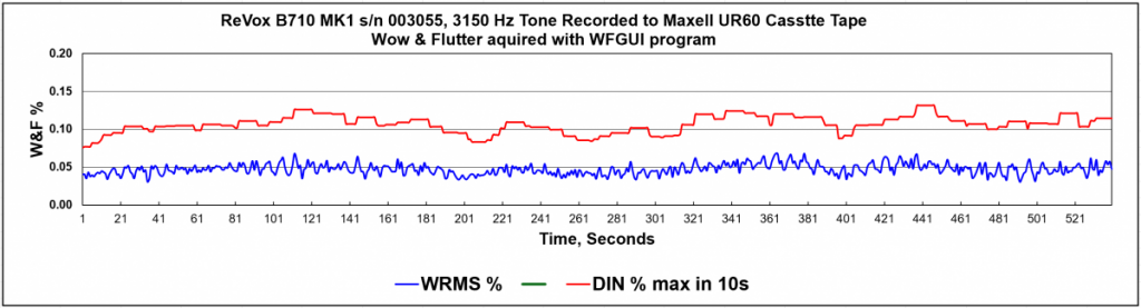

* Two test tapes were created by feeding a 3150 Hz sine wave into the Line Input and recording several minutes of signal to each tape.
* Using the same AnalogMagik setup as before, each test tape was played back to compute the AES Weighted Peak Flutter values.
Figure 19. Example of an AES W&F measurement using Record The Master C60 test tape.
Figure 20. Example of an AES W&F measurement using Maxell UR60 test tape.
* The AES W&F values shown in Figures 19 and 20 agree closely with the previously computed AES W&F value displayed in Figure 15.
* As a final check, the WFGUI program was used to compute the Weighted RMS W&F values, one example using the Maxell UR60 test tape is shown in Figure 21.
Figure 21. Example of a Weighted RMS W&F measurement using Maxell UR60 test tape.

* As commonly seen, the Weighted RMS values in Table 2, in numerical terms, are about half the corresponding Weighted Peak Flutter values.  Further details comparing Weighted Peak Flutter measurements vs. Weighted RMS measurements are described in report "ReVox B710 MK1 Tape Deck - A Wow & Flutter Software Comparison Test".
* Reviewing the results obtained from this test, it can be said there was no detrimental effect from conducting the W&F tests in recording mode.
* Regarding which brand of cassette tape to choose, similar W&F results were achieved with both tapes, indicating either brand of tape would be suitable for this test.

* As mentioned in section History, while undergoing service by Studer ReVox in 1992 all applicable factory upgrades were implemented, bringing it closer to MK2 status (Table 3 and Fig. 22).
Table 3. Installation status of updates performed by Studer Revox Canada - February 1992
* Regarding the updates not implemented by Studer ReVox Canada.
   * R3 and R4 on Microprocessor board. After the wind-mode improvement from adding the twin 1N4001 Diodes, further improvement was deemed unnecessary by Studer Revox.  However, that was over 30 years ago, and with the passage of time older cassettes had further aged suffering from increased internal friction. As per Studer Service Instruction SI 106/87, to further improve the wind-mode reliability I implemented the resistor modification as part of this restoration (Fig. 13).
   * R31 and R34 on Oscillator board. Studer Revox may have determined the bias level was sufficient with no need to increase it.
   * Signal Diodes on Reproduce Amplifier board.  Not a documented/released update?
* Apart from saving me the effort of installing these updates, the work done in 1992 by Studer Revox Canada to my B710 early MK1 unit teaches some interesting information.
   * Contrary to the title "A710 Modifications" in the Studer Service Instructions SI 106/87, it appears the updates were indeed applicable to the B710 series.  Examples from the Service Report (Fig. 22) list new parts related to the updates such as "Diode (x2), Back Tension, Tension PCB, Head Lifting PCB".
   * The Service Report lists new parts installed "1.710.201 Pinch Roller L" and "1.710.202 Pinch Roller R" (diameter 8.0mm and 8.7mm respectively), together with new "1.116.711.02 Erase Head".  This makes sense as it follows the Studer ReVox Service Instructions section "3.4.3 Adjusting the Erase Head". "Version B710 MKI: Erase head 1.116.711.01 has been installed in the MKI versions.  If replacement is required, erase head 1.116.711.02 is also used in these recorders.  In this case, however, the left-hand pinch roller (diameter 8.7 mm) must be replaced by a smaller roller (diameter 8.0 mm, 1.710.201.00)."

To inform our members I made a minor text clarification, that the Wow and Flutter measurements in this report follows the Audio Engineering Society (AES) standard which uses a Weighted Peak Flutter measurement.
The need to clarify this came about from my investigation into the different standards used to describe W&F measurements, which was prompted by member's feedback requesting if I could expand on the tests in this report using another W&F test program.
New report documenting the W&F results achieved with my ReVox B710 tape deck using the AnalogMagik turntable/cartridge test program and the WFGUI tape player test program is posted to the AudioCircle Vintage site, "ReVox B710 MK1 Tape Deck - A Wow & Flutter Software Comparison Test".
https://www.audiocircle.com/index.php?topic=190768.0
