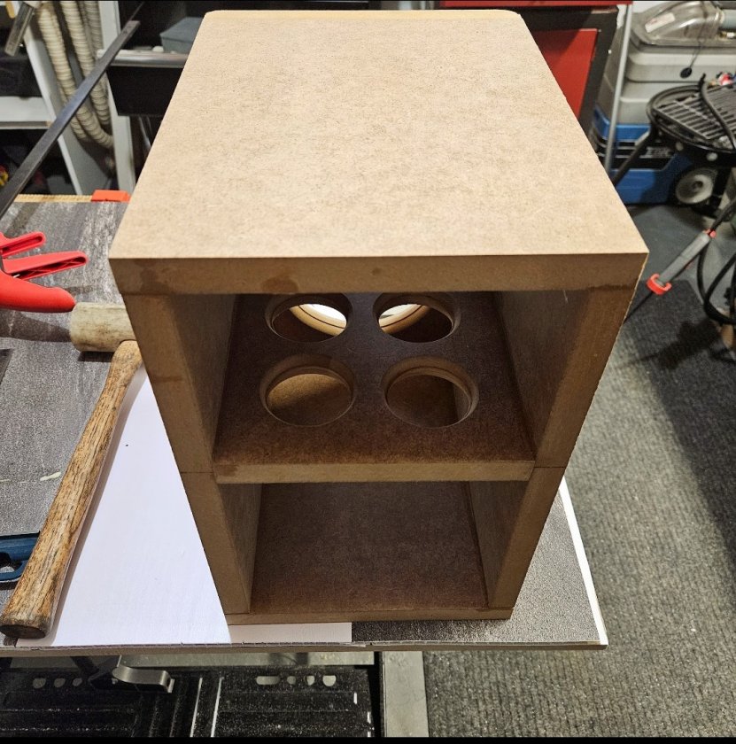

Hello everyone.

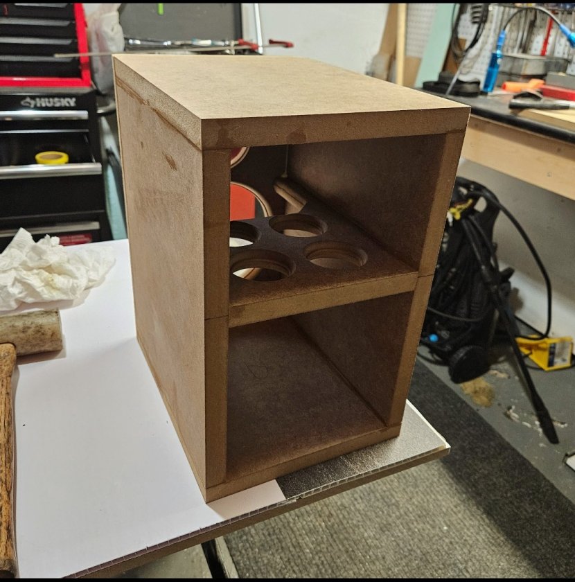

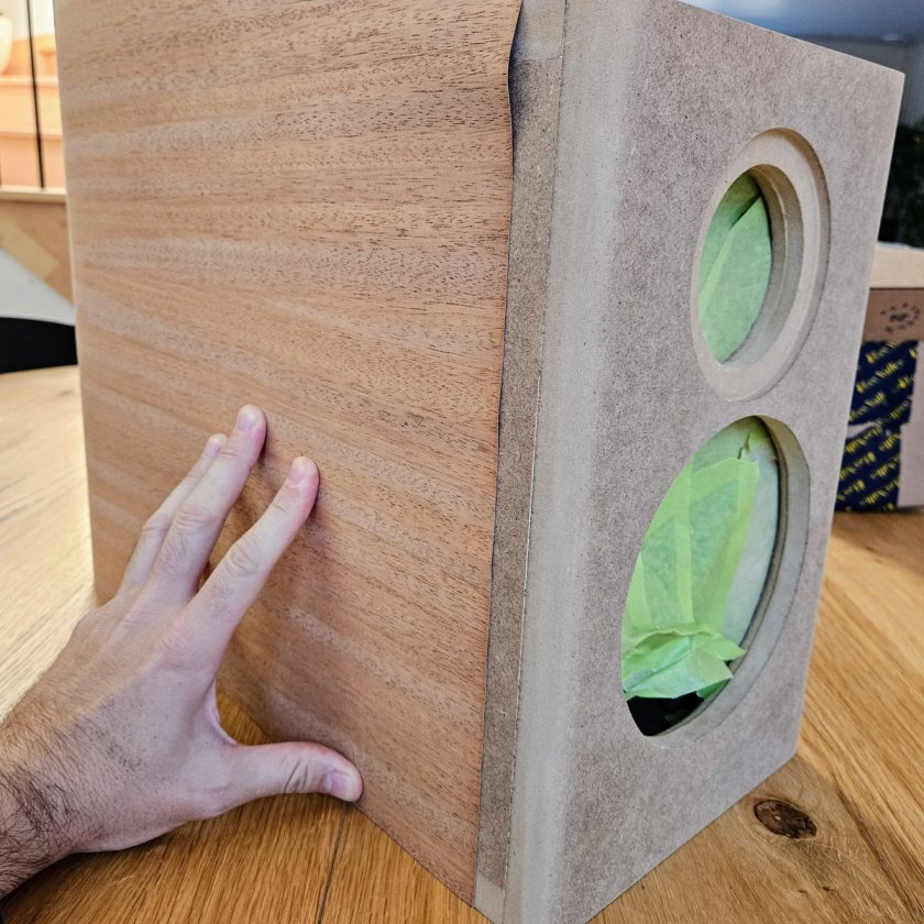

I wanted to share my X-LS Encore project. As Danny often says, it's a "fun project" that I decided to do. The goal is to keep the price as low as possible for my first project. So I opted to build the cabinet myself. The only change made is the bracing. Hoping not to affect the response too much. Once the cabinet is completed, if I am satisfied, I will buy the rest but using the basic kit, then have fun upgrading the crossover and really listen to the difference, instead of going all in. The only thing I will start with  gonna be the tubes connector.

Certainly looks like a decent start, and going step by step through the upgrades can be very revealing.  Audio is an extremely complex area that incredibly dependent upon user and context, so it's a great way to learn what you like and value vs all of the other keyboard warriors.  Like me.  :D  Although I do at least build things sometimes.
It would appear that your router bit is messed up.  The edges where the bearings contact should, by definition, be flush... and it's not  The other edge you manually dial in with a piece of scrap until it's just about to kiss the surface, and that one's close enough to sand with no ill effects.

Yeah I know you are right about the router. I'm gonna take some time to sand those groove. I worked with an old router I had in the garage. :green:

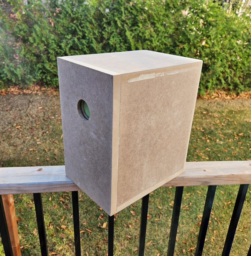

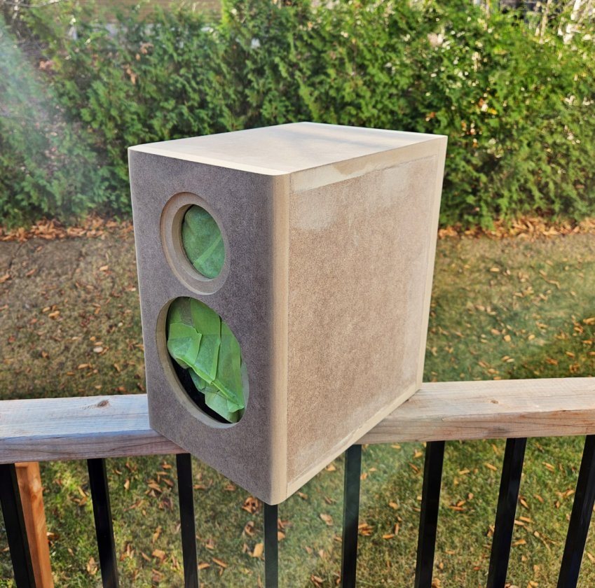

It's the last few days I started installing the damping. (bitumen + felt) that I already had on hand from an old project. I finished the assembly and used do wood filer to make sure all the joints were straight. Sanding completed, I think I am ready to install my veneer. I chose the Mohagany color.
I also got some metal plates from Solen for the binding post. I think the finish is better. So I'm waiting to receive them to make my opening behind them.

« Reply #6 on: 12 Nov 2024, 06:00 pm »
A couple things I see about the breaching. That brace looks like it might be taking up more internal volume than what the plans call for but don’t know if it’s enough to make a difference in the response. The other is it looks like the top panel is unbraced. If it it’s, that could cause some issues.

« Reply #7 on: 12 Nov 2024, 06:31 pm »
Yes I know. On the other hand, in my opinion, I think that a bracket of this type greatly strengthens the cabinet, more than a simple transverse bar. I'm not here to contradict the way, but I simply have fun experimenting.
I will be able to mesure the response once everything is install.

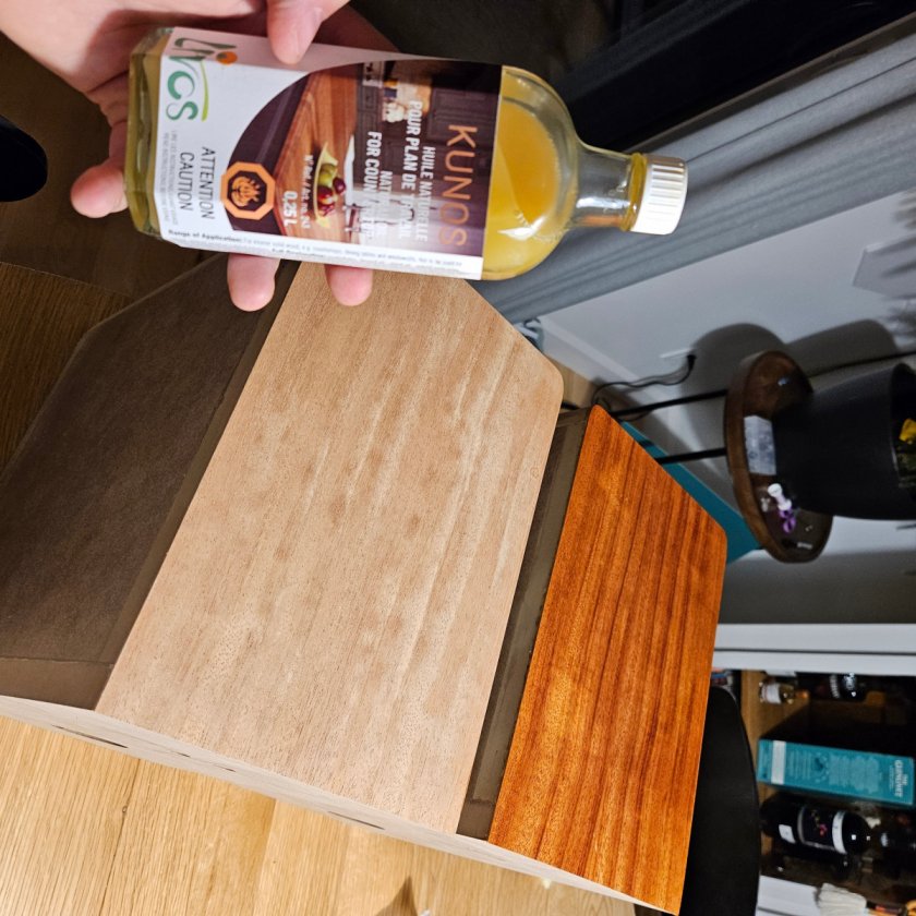

I started applying the wood veneer. being too curious, I have already started to do tests and apply a first coat of oil. It’s going to be beautiful!!
Cheers

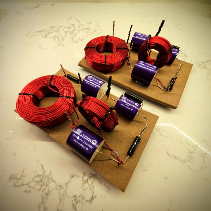

Hello Folks. Well long story short. I've started 2 new cabinet. Definitely learn from a few mistakes. But I've almost reached the end. Like Danny's often said : it's a fun built 😄

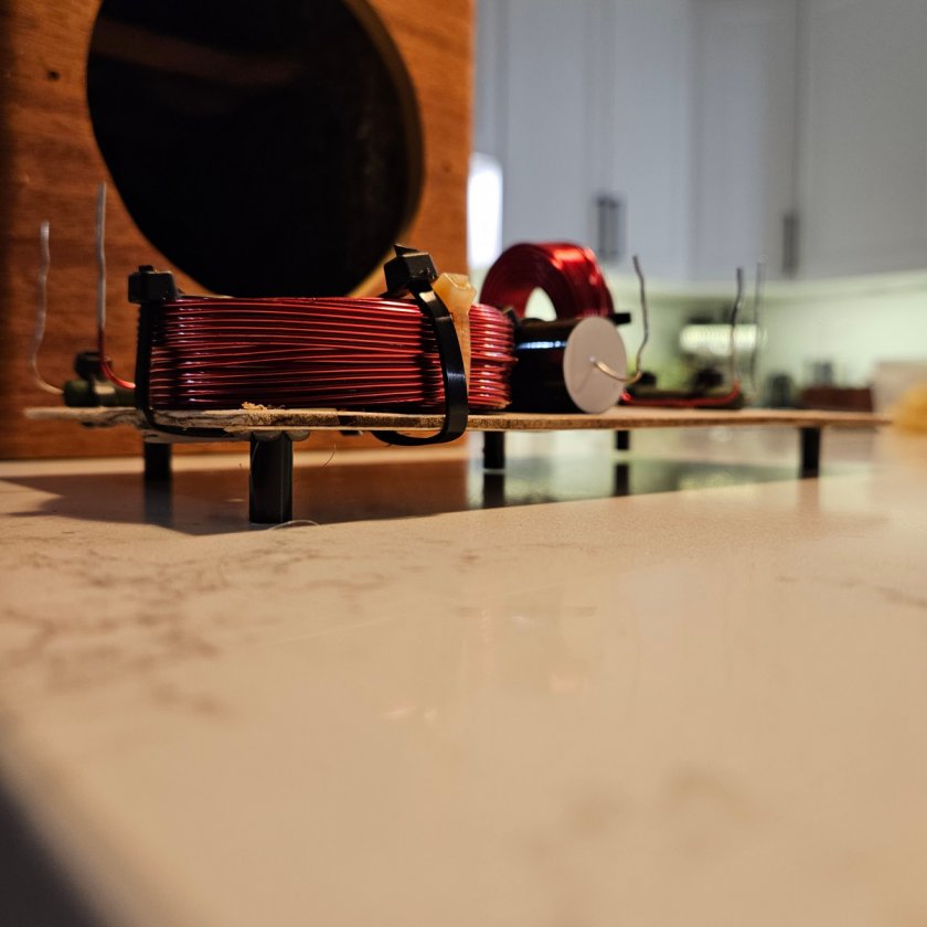

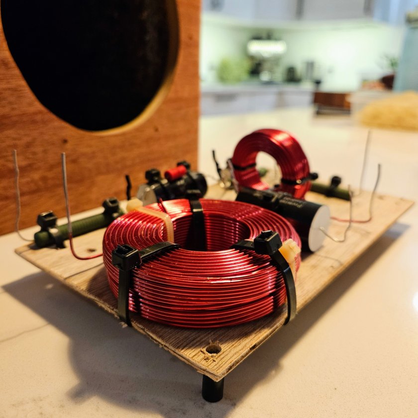

Oof!  They look fantastic but I do not recommend Clarity ESA or CSA caps for the tweeter circuit.  They tend to roll off the higher frequencies.  They’re fine for mid and bass circuits.
For tweeters you should go with the ones Danny provides or if you want Clarity Caps, go with MR, CMR, or their new PUR series. Alternatively, you could use one of these to bypass the CSA caps.

Actually the goal is to try many crossover designs so I can hear the difference between caps. I will stick with mills resistors but I'd like to give a good at Path Audio.

This crossover layout was designed for exactly that... swapping out caps.  The tab strips have solid core wire added to them so the connection is to that, and the other lead is left alone.  It was fitted for a Miflex with holes predrilled to make swap installation easy.  The center spine also has solid core on the underside.
Frederick and I thought up this idea and Frederick did the assembly, of course.  Duelund CAST-PP caps and Duelund resistors.

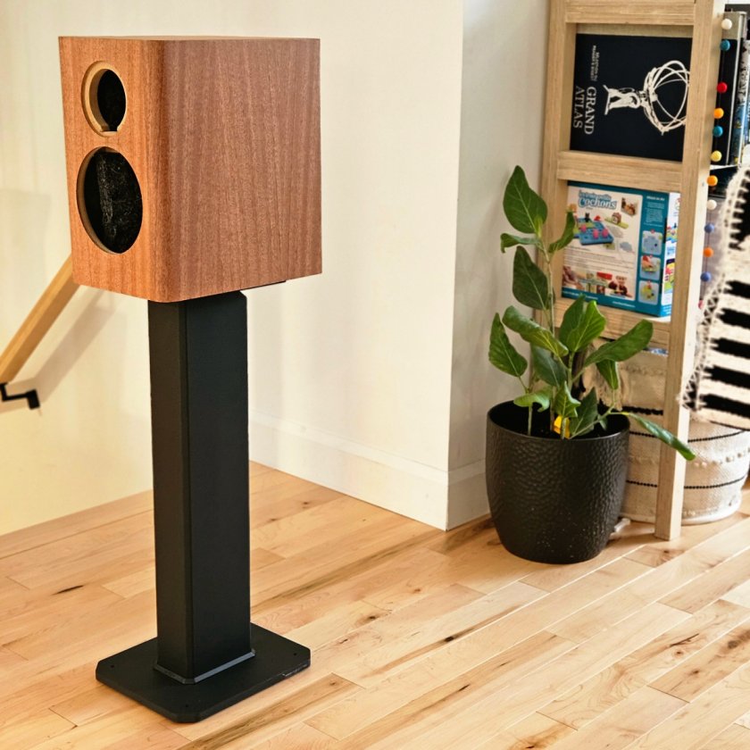

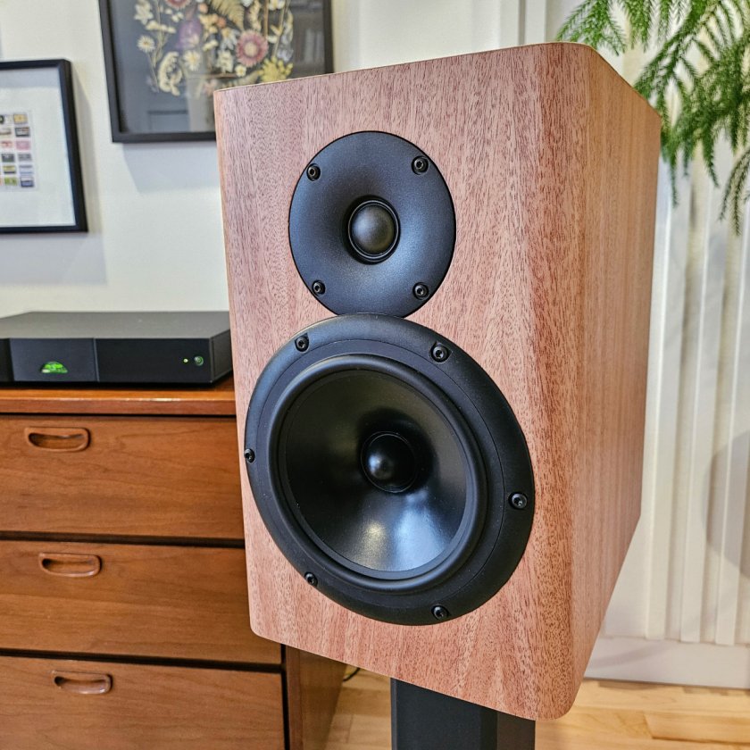

Komoyuki
Re: My take on the X-LS Encore
« Reply #16 on: 29 Jan 2025, 06:59 pm »

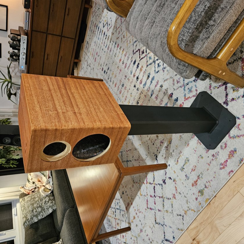

Finally, I can say that the X-LS is complete. Really happy with the result and I really learned. Gonna give them a few hours of break-in but already the image and everything is excellent. Thanks Danny for this bookshelf. I know I'm a little late and this model has been out for a while. But I'm glad I did it!!

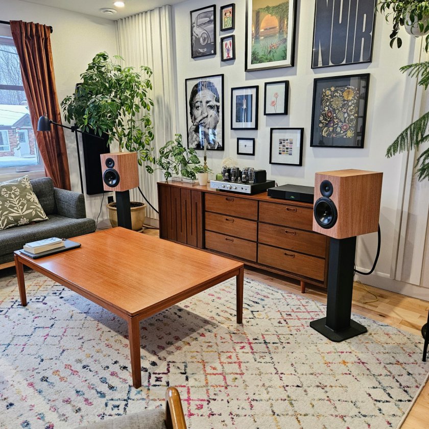

« Reply #19 on: 30 Jan 2025, 10:07 pm »
I'm glad you shared the progression of your project. The image of your X-LS Encore's beautifully finished and in your room is especially elegant. Nice work Komoyuki.
