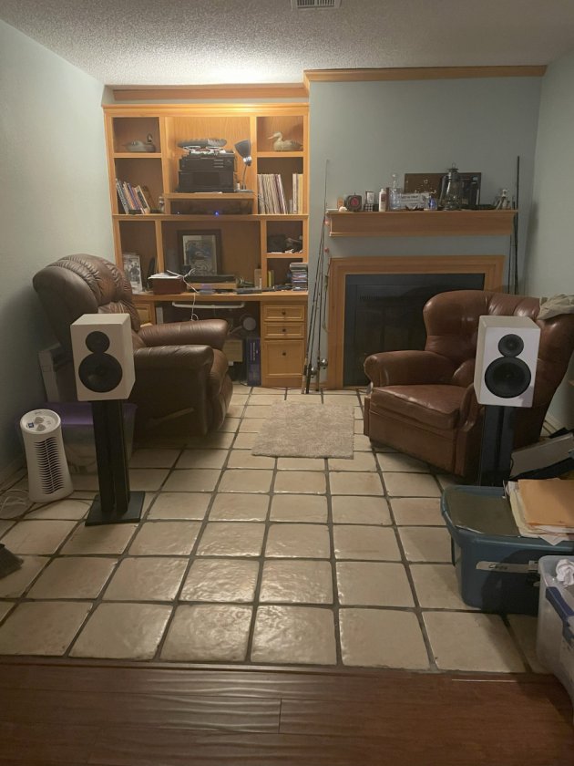

Danny Richie
Re: Searching for Soundstage
« Reply #7 on: 1 Nov 2024, 02:54 pm »
Post pictures of your room.
Lol.  gimme a minute, I need to tidy up a bit.

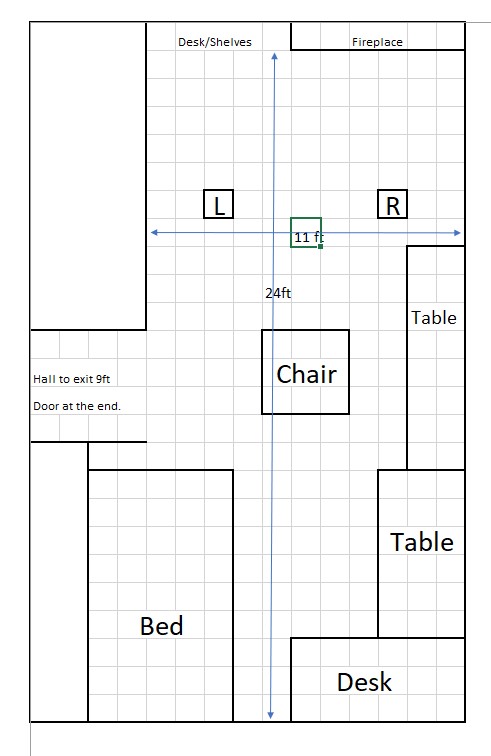

« Reply #17 on: 2 Nov 2024, 02:14 am »
Here is the basic room layout.
Here is a view of the front wall.
Danny Richie
« Reply #18 on: 2 Nov 2024, 07:35 pm »
Ah man, you have way to many hard surfaces everywhere to be getting any really good results.
Step number 1 is to start treating your room. The rest will fall into place.

« Reply #19 on: 2 Nov 2024, 08:26 pm »
Agreed.  A thick rug and lots of absorbers on the walls.
