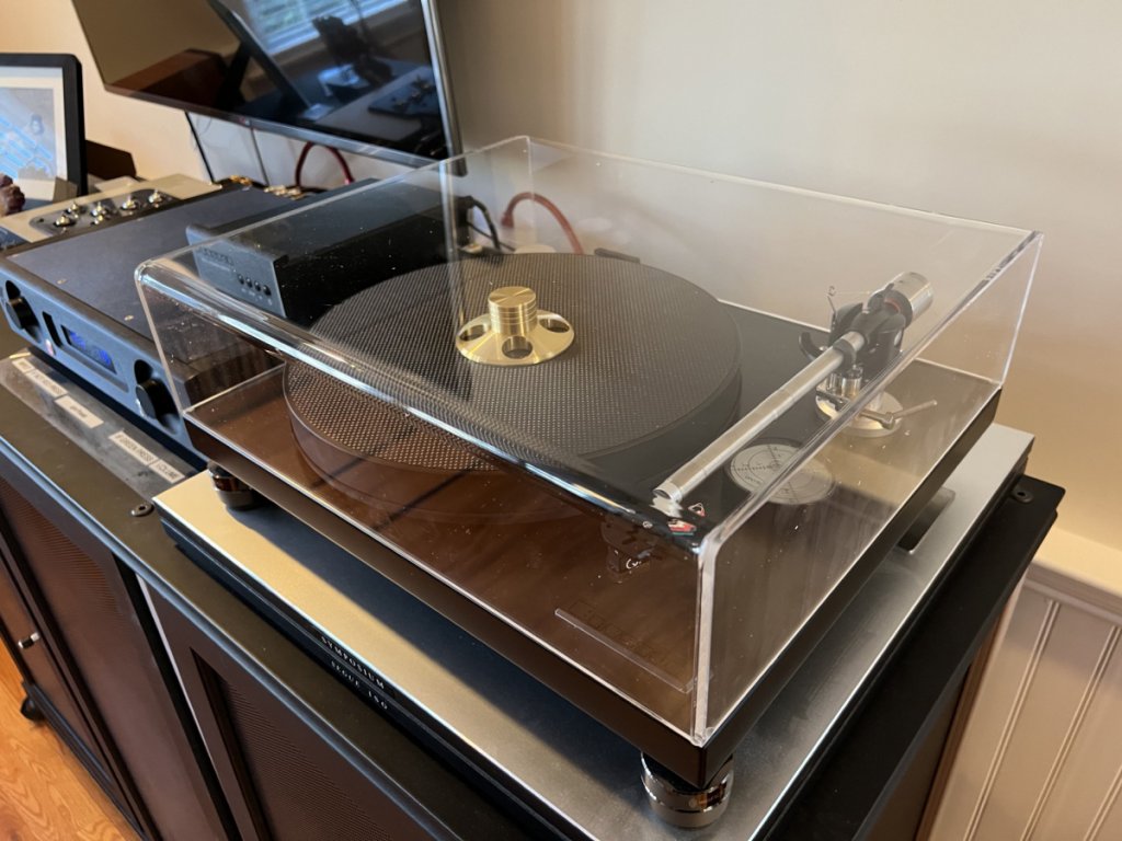

abuhannibal
  • Posts: 70
Re: Bryston BLP-1
« Reply #10 on: 21 Oct 2024, 10:14 pm »
Ortofon Quintet Black S here, very happy with it.
BTW in case anybody wants to add anti-skating... the currently-sold Gold Note anti-skate kit works fine with the version of the B7 Arm on the BLP-1, however, once installed the supplied dust cover is just a tad too low. I am in the process of ordering another one.

abuhannibal
  • Posts: 70
Re: Bryston BLP-1
« Reply #12 on: 10 Dec 2024, 06:23 pm »
Decided to get the Gold Note anti-skate kit for my BLP-1 - it installs and works just fine, however, it needs just a tiny bit more height than the supplied dust cover allows, so i ordered a new one from jmkdisplays.com and attached the Bryston/Gold Note removable hinges to it. I suppose one could also cut a 1 inch or so hole in the original dust cover but that seemed a little crude and you know cats and children would get in there. :)
abuhannibal
  • Posts: 70
Re: Bryston BLP-1
« Reply #13 on: 10 Dec 2024, 11:18 pm »
