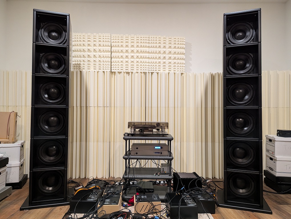

These are my 6x12 OB servo subs with captainhemo's cabinets I had painted hotrod black.  I have 4-HX300-12OB servo amps running the servo subs.
More info on my AC page if interested.

Here is a great example of Kazoom's dspNexus 2x8 system with his NX-Tremes with his servo subs.  Lots of details on how he integrated the DSP crossover design I setup for him with his system.
https://www.audiocircle.com/index.php?topic=186956.20
I think you can put a couple more subs on each side to reach the ceiling.  Reminds me of SNL "I need more cow bell"!  I am building triple threats with the modules just in case I want to add more cow bell later.....
