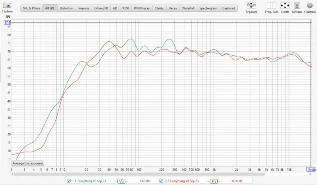

So with Hal's version 1 (nothing but crossovers set up), this is what we were working with.
The rest of the day was "wash, rinse and repeat" with Hal quickly turning around a new Audio Weaver file for me to measure with.
It should be noted that with each new iteration you need to be paying attention to how much you are abusing the CPU with the changes.  This is displayed in the AWE Server window.
For the most part of the day, the CPU was pegged at around 75%.  It was not until Hal started adding a few PEQs around version 7 or 8 did we see it hit 80%.  PEQs are costly in terms of CPU.  Mine sitting around 80% is actually really good, as I am told many guys are tapping out around 95%.
IIR filters are much more efficient than FIR filters, so that is a place one can save cpu cycles if you find yourself running into a wall.  The upgrade should free up some of the CPU and enable more FIR implementation, if that is needed.
@Jaytor - to answer your question from before, Hal did add in some IIR filters for bass management.  And we have been toying with FIR filters.
Actual measurements
As tedious as this work can be, I love hearing something barely listenable transform itself into that which sounds pretty darn good.  I still am always in disbelief that what I am hearing on the first iteration will actually go somewhere.  When it eventually does, then it is like Christmas for me. :xmas:
Within a few hours we were on version 11 which produced the response below.
This is a solid place for me to start playing with adding PEQs to AWE for room correction (which I will chat about in my next post).
