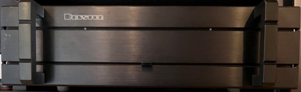

Figure 1. Bryston 3Be front view after repairs - photo from January 2023.

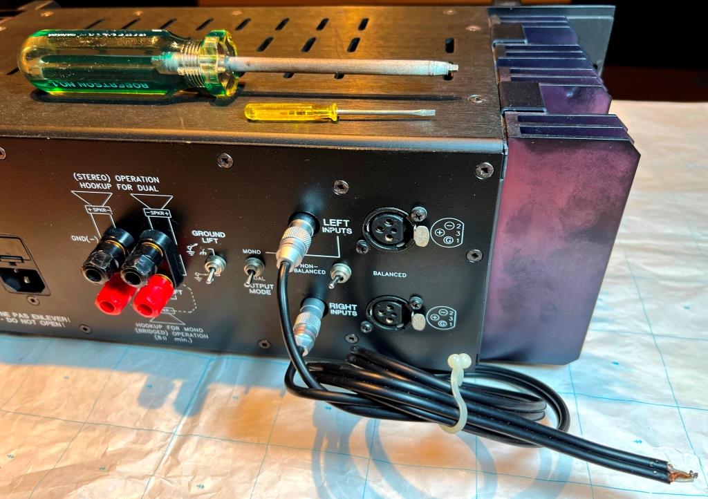

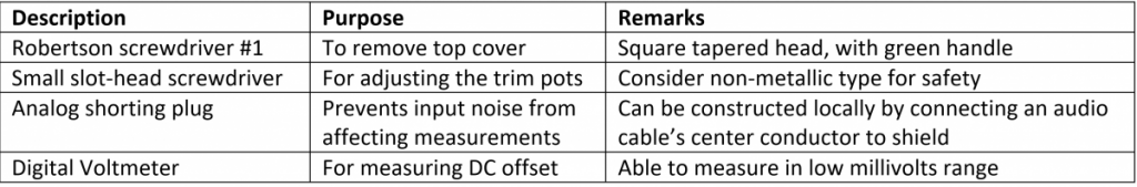

* Fortunately, both the Bryston 2B and 3Be power amplifiers are straightforward to work on using common tools and common sense.  For the 3Be power amplifier a description of the hand tools and equipment used for measuring and adjusting the DC offset voltage is shown in Table 1 and Figure 2.
Table 1. Suggested hand tools and test equipment for measuring and adjusting DC offset voltage.
Figure 2. Rear of 3Be amplifier with; Robertson screwdriver, trimming screwdriver, analog inputs shorting cable.

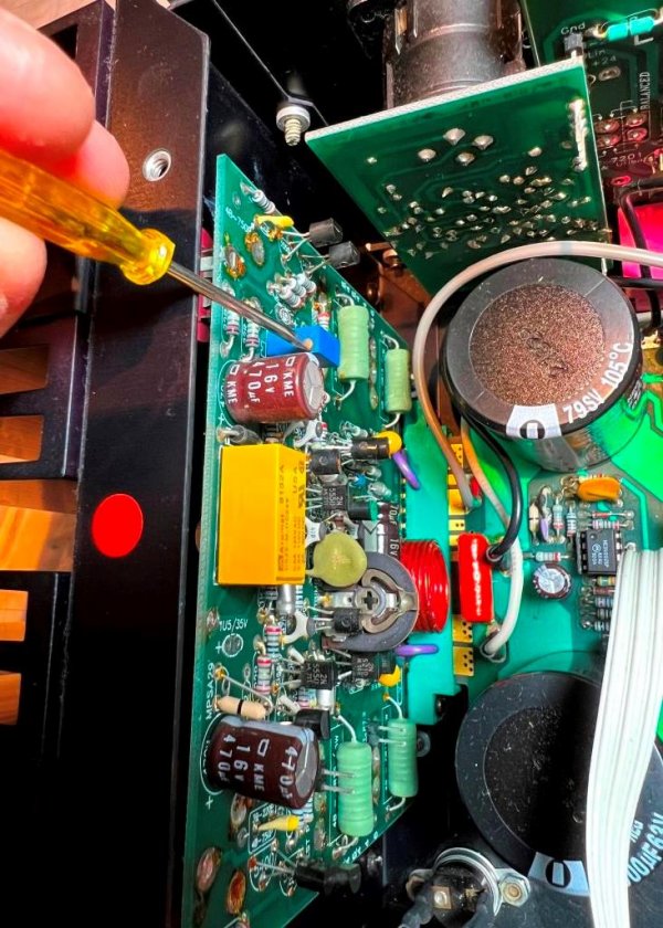

* Familiarize yourself with the location of the trim pots and the correct type of screwdriver needed to adjust them.  There should be one trim pot for each channel (Fig 3.).
* Suggest marking the initial position of each trim pot set screw, in case there is a problem with adjusting the offset value or something goes wrong, you can always return to the initial setting.  Gently rotate the trim pot set screw by a small amount to ensure it is not stuck.
Figure 3. Location of trim pot - left channel shown with top cover removed.

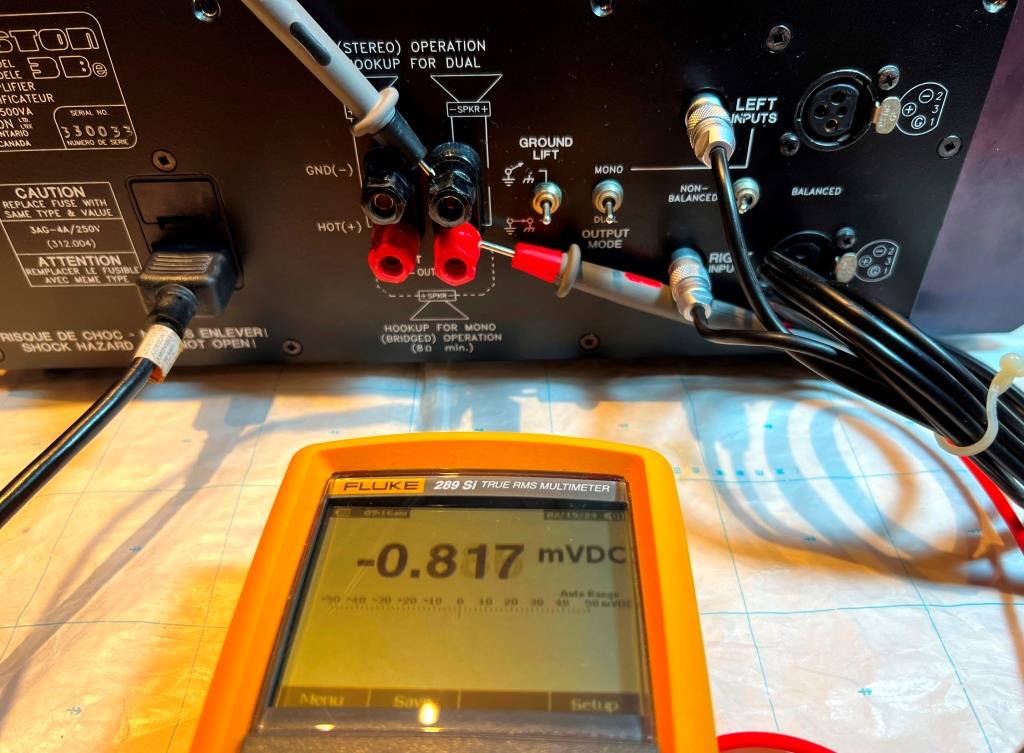

* With the top cover removed you might see some fluctuation in the measured DC voltage, this could be due to noise pickup from lack of shielding without the top cover.   Gently replace the cover and record the final DC offset voltages.  In my case replacing the top cover provided a more stable reading.  Example of these final measurements are displayed in Table 3, Figures 4 and 5.
Table 3. Final DC offset voltage measurements after adjustment.
* While your results may differ, the results shown in Table 3 were achieved by turning each trim pot set screw approx. 2 turns clockwise (when viewed from above) from their initial positions measured in Table 2.
Figure 4. Final DC offset voltage after adjustment, left channel.
Figure 5. Final DC offset voltage after adjustment, right channel - note top cover in place but not fastened.
