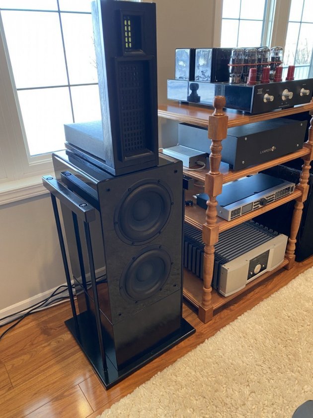

Since you are looking at dual Rhythmic subs don't overlook the FM8s. Dual 8" paper drivers that play up to 200 hz. Will output almost the same volume as the 12s but are faster. Gives a lot of options to crossover high.
If I had the LRS I would make stands to have them above the FM8s to gain stage height and cross them over as high as works. You would have to work out something to high pass the Maggies but to me that is what I would do if I entered back to Maggie land and would not care about the rest of the line.
Make sure to get the gloss black FM8s, beautiful.
I have a pair of FM8s with GR Super Minis. Here are a couple videos for proof of concept. Subs have 4 hours, Minis about 30. Crossover is 200 hz. Still a lot of work to get things right, but a start. Room in new house is challenging, but a miracle to even have the system there, ha. Acoustic foam has yet to be put on the front baffle.
I have since raised the subs 10" off the ground with the funny things on the sides. They are Specially Tuned Harmonic Resonators that create an out of phase signal to cancel out box resonances. They also just happen to be fantastic grab handles to move the speakers to they listening positions.
Rickie Lee. https://www.youtube.com/watch?v=iTRByZtq7K0
The FM8s are impressive for sure. I just don't think I have any interest in crossing over that high though. I'll probably be crossing over at 60Hz.
