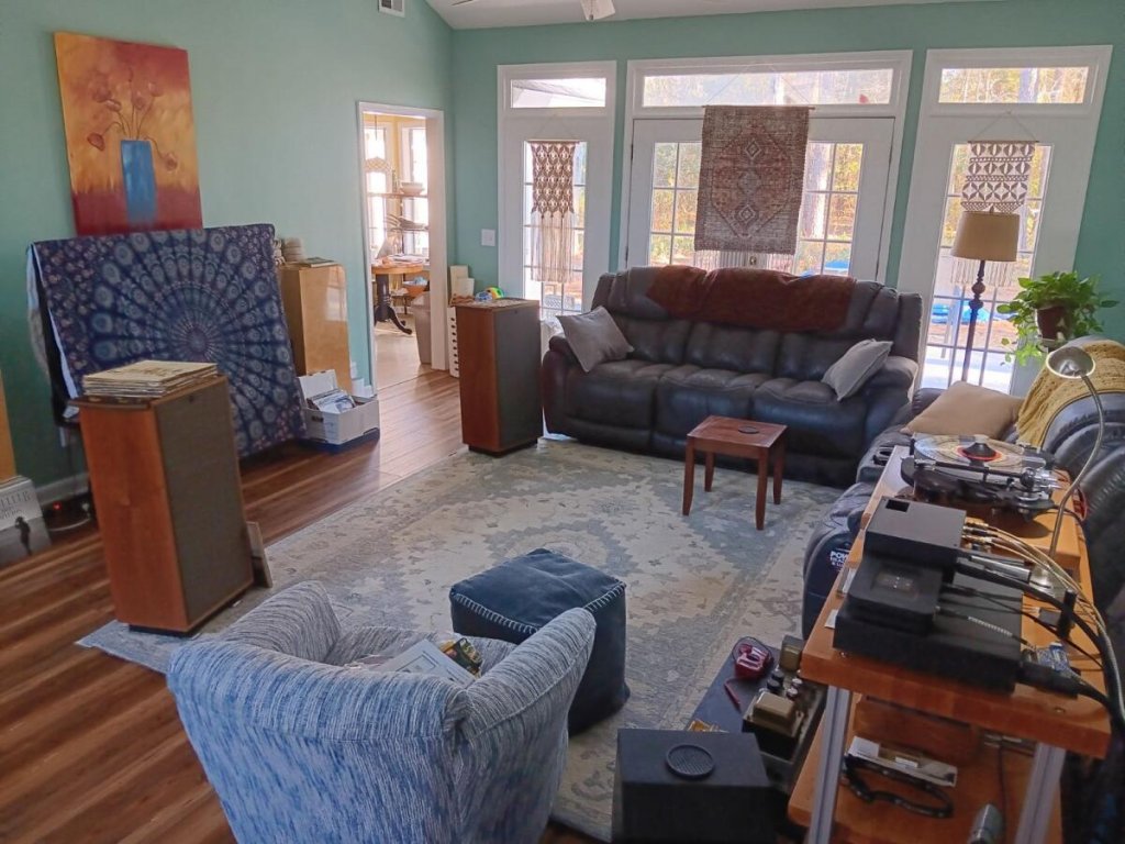

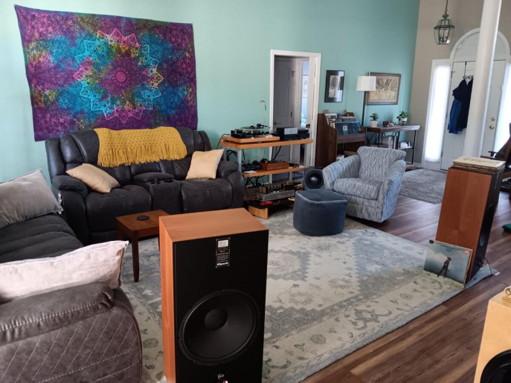

Please view these 2 pics, I think they say it all.....
12' wide wall of glass, RIGHT side:
from behind RT spkr, open layout beyond LEFT speaker:
-  Very tall ceiling, slopes from RIGHT to LEFT, 9 to 15 ft.
-  Speaker spread is 7.5 ft
-  Speaker baffle to LP is 9 ft
-  Front baffle to front wall is 5.5 ft
-  Back wall to ears is 2 ft  (unfortunate, but unavoidable)
-  65" TV between spkrs is against front wall, and covered with comforter + tapestry
-  Left Speaker:  open layout to the left,  front wall ends at left edge of speaker cabinet
Bass is not a problem, so I'm not thinking bass traps.  Slap echo is creating serious discord in the sound and very rapid listener fatigue,
to the point of unlistenable.  So I'm focusing on just general across the spectrum frequency absorption.
100% sure problem is the room, as I had the identical gear in my previous house and it sounded GREAT!

Are those Klipsch speaker? If so they are notorious for sounding terrible in large echoey spaces. I hope you are not in love with them. The money spent on room treatments would be better spent on different speakers, either open baffle that work best in large open spaces (Magnapan) or a speaker with a more focused presentation. Speakers with a RAAL tweeter don't have as much a wide dispersion as a dome tweeter. The big, flabby, phat, slow passive radiator on the back of the speaker isn't doing you any favors either.
You have enough rugs and furniture in the room that room treatment is not needed with the right speakers.

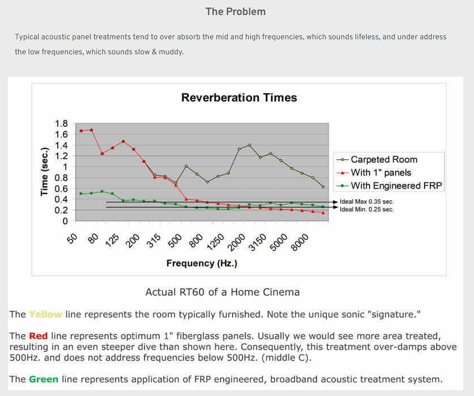

AV RoomService has tested Frequency Response Panels designed to control room modes, first order reflections, reverberation times and flutter echo.
Their site has plenty of well written acoustic articles too, start with "Measurement Beyond The Atomic Level"
https://avroomservice.com/frp/

I think you would be far better off skipping the fiberglass or Rockwool insulation and consider the panels at acoustic fields.com.
You might want to watch, or consult with, Acoustic Fields.com, they are on YouTube.
Their solution might not be so waf friendly though.
I am in the same boat. Will use window coverings and live with it.
Rocket Ronny
Of course, they are trying to sell you something.  However their claim about absorbing better below 500hz is dubious.  Regular acoustic panels can do this too, they just need to be thicker.  I use 4 inch thick panels and it absorbs below 500hz quite well.
If you build out acoustic panels big enough and thick enough, you end up with corner traps that absorb all the way down to the bass.  No need for 'special foam' at all.

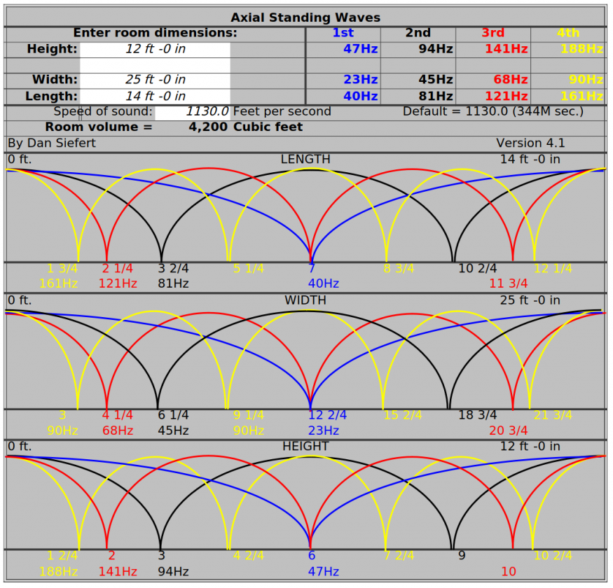

You are on the right track but you are failing to identify the biggest bang for the buck.
Let's sort out the facts from the myths so you apply your effort where you will get the biggest bang for the buck.
Slap echo happens between two closely spaced walls. It sounds like a pinging ring because when you clap your hands you hear the same wavefront ricocheting back and forth between two high gain/low loss surfaces.
Your problem is that huge front wall in front of you, and that huge rear wall behind you. It is especially problematic for listening because the slap echo bouncing off that nearby rear wall behind you is contaminating everything you hear in that room, even more so than it would if you were closer to the center of the room.
But there's more. To get the best modal reinforcement of bass, you need to be somewhere between the 1/3 and 2/5 point between parallel surfaces, where modal bass is strongest.
I've taken the liberty of downloading a Harman modal analysis spreadsheet and put your room dimensions into it. I've assumed that your underestimated the length of that glass wall by not including the portion that is not glass, so I opened it up to 14'.
Since your ceiling is sloped and its modal behavior is quite complex, I've put a guess for a halfway point at 12' just to fill something in that is somewhat realistic. You also didn't specify the left-right dimension so I estimated 25', but again this is immaterial to the meat of this analysis which is that rear wall 2' behind your head.
Sorry, can't find the original Harman link, but I found the calculator archived here. Use at your own risk:
https://pearl-hifi.com/06_Lit_Archive/15_Mfrs_Publications/Harman_Int'l/Calculators/Room%20Mode%20Calculator.xls
So here is your room:
The place you need to put your ears is about 4.5' off that rear wall.
That will attenuate the reflection off that rear wall and reduce the amplitude of the slap echo you hear relative to the direct sound.
It will also improve your sense of ambience in the entire space by rebalancing the relative contributions of ambient sound from all directions.
It will also preserve your modal bass response on that front-rear dimension, particularly regarding the muddy bass you are currently hearing from sitting too close to the rear boundary where modal pressure is building up. Moving away from the wall while not moving into a modal null should help rebalance the tone.
You don't want your ears 3.5' off that rear wall either. That is where you'll be in a modal null at 80Hz. If you are using a subwoofer (even if you aren't using a subwoofer) listening from that null may seriously disrupt your bass.

Acoustic Fields products are overpriced and likely underperform plain old fiberglass or Bonded Logic or Rockwool.  They have no real measurements that I can find on their website, and the only comparison they offer to other products is low freq. performance versus standard acoustic foam, which is almost worthless.  Their  panels are $300 each for a chunk of foam.  You can purchase an entire pallet of Bonded Logic for $700 from Home Depot.  Or you can purchase 6 rigid fiberglass panels or 6 pieces if something like Bonded Logic of the same size for around $100.
https://www.acoustimac.com/acoustic-insulation-materials/acoustic-insulation
If you want premade, Acousticmac has those too.  All for VERY fair prices and with proven performance.
