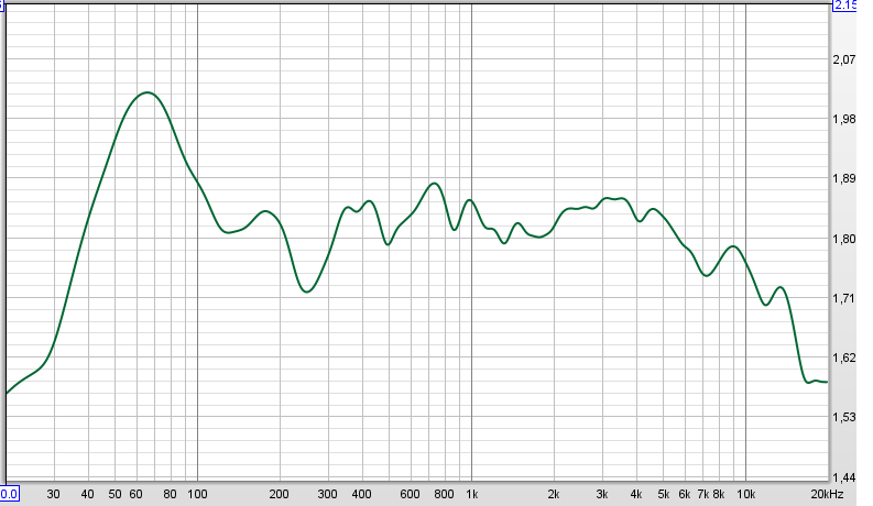

This pretty much looks like mine. I have the X-Statik with point to point, with upgraded Sonic Caps and Miflex bypass. Measurement 91db at 1 meter at tweeter height. Dirac (second pic) cleans this up pretty good, even better at main listening position.

« Reply #17 on: 17 Dec 2023, 12:20 am »
I was able to replicate that response. It is caused by a floor reflection.
The latest version compensates for that. If you are interested in getting the latest version of the crossover then let me know.
Thanks for sharing how much improvement your Dirac ARC was able to achieve!
