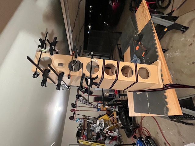

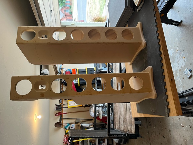

Here are some pictures of my cabinets glued up.  I tried to find some pics of them sanded  and ready for paint but I couldn't find any.  In this pic you can see where the glue got out of hand in some places the inside of the first one is really bad.  It took a bunch of sanding and scraping to get it ready to paint.  I was going to paint them myself but decided to have them painted at a body shop down the street.  They are currently getting painted.

Nice job, the glue up the most terrifying part. Not having to paint yourself it really nice. That part takes forever.

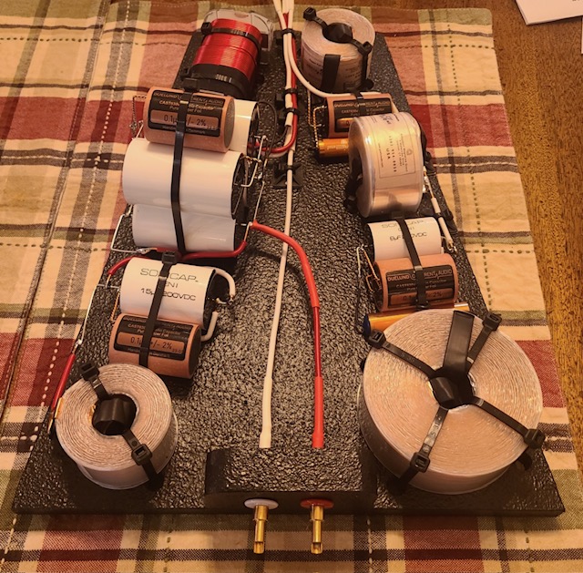

I had my crossover built by Fredrick.  He does a great job and very miticulous.  He built and painted the crossover board.  I could have done it myself but it wouldn't have been near as nice.  I really feel like the crossovers are eye candy.  I upgraded the crossovers to all Sonicaps with Deuland bypass caps and path resistors and Goetz copper foil inductors.  I also had Fredrick build me some speaker cables from Danny.  Both the speaker cables and crossovers are being Cryo'd at Danny's while my speakers are being painted.

Outstanding.  Man those crossovers look familiar. I think we are going to have nearly identical sounding NX-Otica's. Can't wait to see how the paint turns out.  Im in the process of cutting my no res now for them. Im going a bit overboard and applying some to the bracing as well which where I started with the no res.
Yes it is the exact crossover.  When you get done with your no rez put some picture online I would like to see it.  I am going to have surgery on the 28th and I will be coasting around on a scooter.  I hope I can get them up and running but I don't think it is going to happen.
