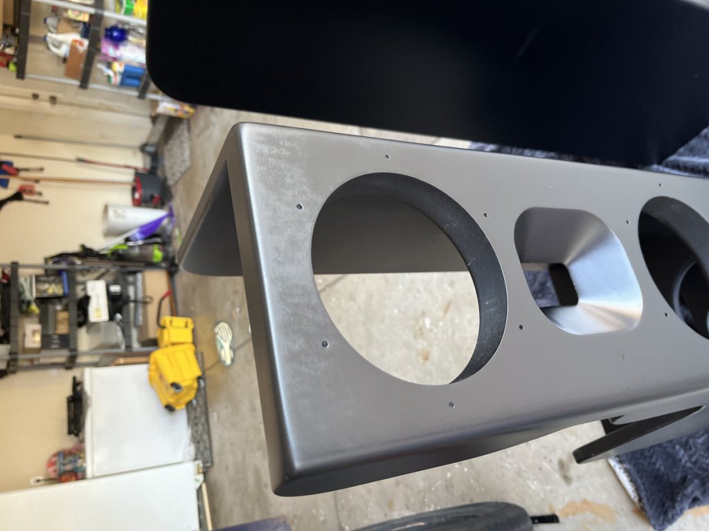

Well it's been a long process getting my NX-Otica's built.  I started out over a year ago.  I had some health issues that held me back.  Well I am much better now and rolling again.  I also went thru several painters.  After they screwed the paint jobs up  I had to sand and re-prep so I did this several times.  I eventually found a good painter.  He talked me into doing something a little different and I am glad I did it.  He suggested painting with rock chip paint.  He said it is used on fenders etc in cars.  I had it  painted with the rock chip paint and he sanded it down to give it a cool texture so it's not exactly smooth then he painted over it with hot rod black.  I was really happy with the way they turned out.  Oh I forgot to mention I added some triple threats to the mix.  I just got the NX-Otica's wired up.  Now I just need to solder in the crossovers.  I have never soldered before and I was getting better as I went along.  Here are some pictures.  I just noticed in the picture they need to be wiped off.  The paint job is excellent.

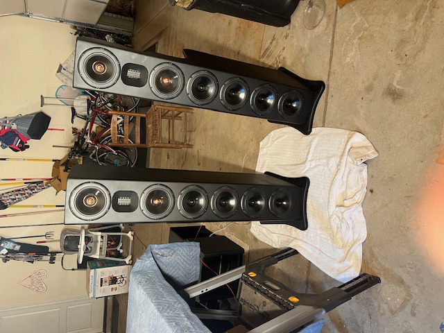

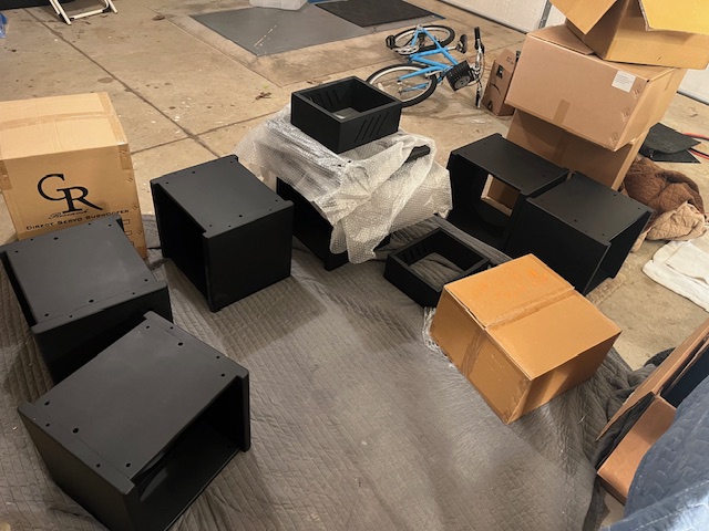

Here are some pictures of the triple threats after paint ready to be put together.

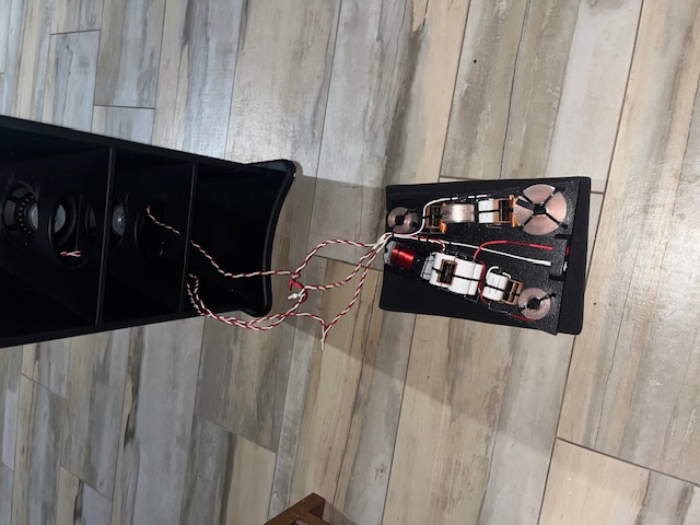

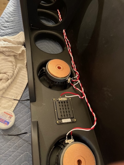

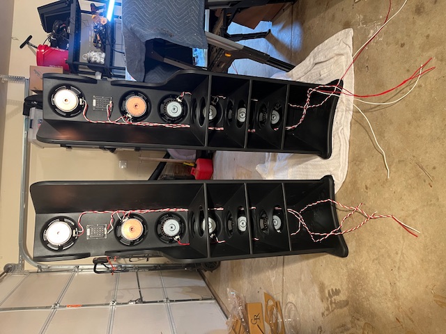

« Reply #28 on: 11 Jan 2025, 06:52 am »
Here are some pictures of the wiring.  It took me about 1.5 days.

Oh man Brandon I know it's been a long time coming. I'm happy they are finally together and looking damn good! :banana piano:

I think the rocker stone guard was a brilliant move. So many shoot for the glossy "piano" finish. FWIW, I think the texture and lower sheen can look better and be more forgiving to boot. Glossy automotive finish is difficult even for the experienced painter and can look kinda out-of-place in today's casual living environments.
Thank you.  I knew what I wanted but wasn't sure how to get there.  I met a painter who had a shop in his backyard.  He painted all sorts of stuff including cars, motorcycles, guitars etc.  First time I  met him he was painting a classic vette.  He was a cool dude and we ended up talking more about other things than the speakers.  He did a couple of test runs on the amp boxes but I didn't like  how it was looking.  I told him I wanted it to have a little texture.  He was the one who recommended doing it like this.  The texture was ruff but then sanded  a bit to give it a better feel.  When I was putting the drivers in I dropped a screw on the table and didn't realize what I had done and I took a few pics of the results.  When I left the painter he told me how to touch up scuffs. It's as if he knew what I was about tho do.  I am not too worried about it because you don't really even notice it until you get down and look at them so once I touch them up it will be forgotten.  Again I was looking at the speakers and I keep forgetting to dust them off from bringing them in from the garage but you can definitely see the damage that little screw caused.

« Reply #37 on: 14 Jan 2025, 06:10 am »
I left the wiring to the crossovers long so I could pull them out and get to them if I need to.  I tried to do some fancy solder joints so the wires would be nice and flat but my skills are lacking. I ended up just cutting the wires and twisting them together and soldering them.  Once I get the speakers tested and burned in I will go back and install the no-rez.

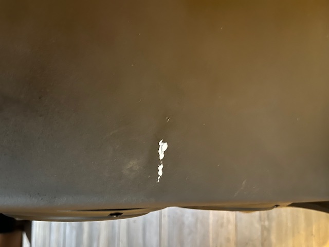

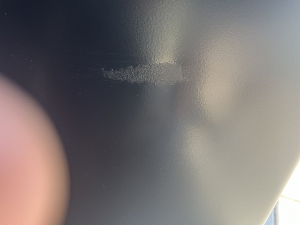

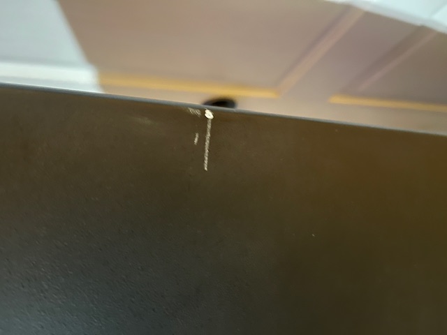

That's unfortunate about the screw but stuff happens. Sounds like you're spraying black rocker texture as the final coat?

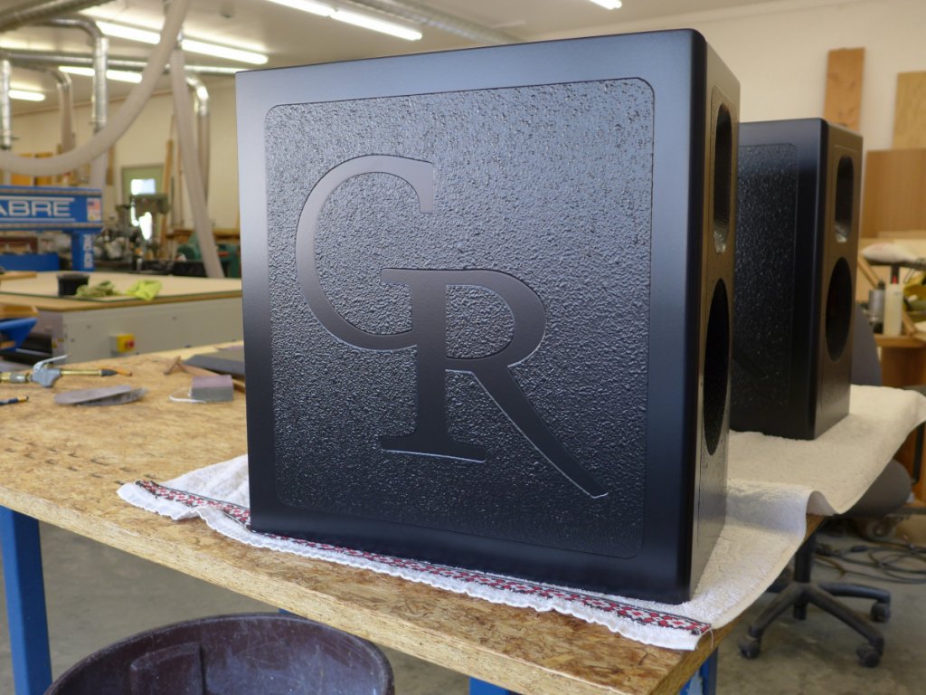

Here's another way it can be done with heavier texture. 3M calls theirs Shutz, I think. Similar to what you describe with sanding but then top coating, although this was black then clear satin conversion finish. Idea was actually born from a mistake.
That is impressive!  I have  thought about what I would do if I make another pair of speakers which will probably be some monitors or old school speakers.  I would have the face be smooth with the sides having some sort of texture but you have taken it one step further with the GR logo.
