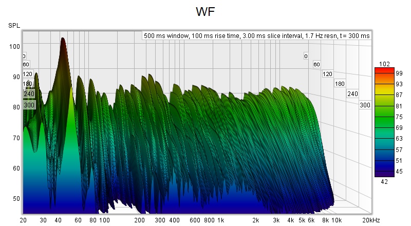

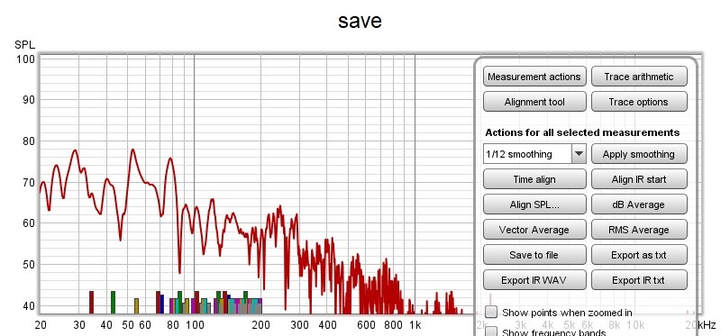

  Is this peak a room mode? No matter what I try it's very stubborn. Could this be a first-reflection issue? That area of our room has treatments on the way. Thanks

Looks like a room mode to me. I have one that does the same thing at 40Hz.
  • Posts: 11649
Re: Room Mode or What?
« Reply #2 on: 4 Sep 2023, 06:41 pm »
Definitely a room mode.  What are you running in your system?

Most certainly appears to be a room mode. What are the specs on your room?

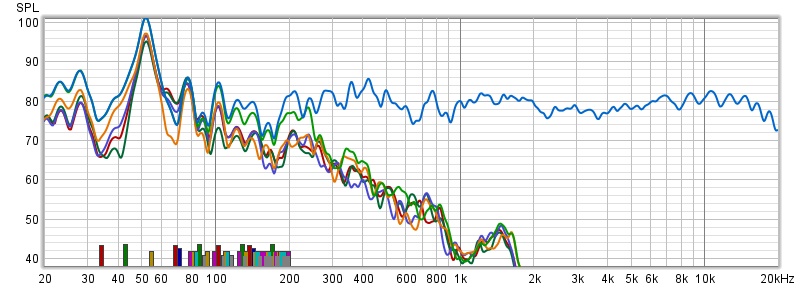

 I've tried every PEQ  dial and nothing budges. Same peak.
Rooms 15.526 x 22.374 x 9
Taller bass traps? More bass trap? Trap on the rear wall?

The more, the bigger & the deeper the better. Especially if you want to control something in the 55Hz Range.
Considering that the peak is ~15-20dB over the average output level, I don't think the Rythmik PEQ would do a whole lot in such a case.

Moving the listening position is an excellent suggestion too as it's free. You may be able to move out of the main room mode at ~53Hz which should make it easier to treat the smaller modes at your new position.

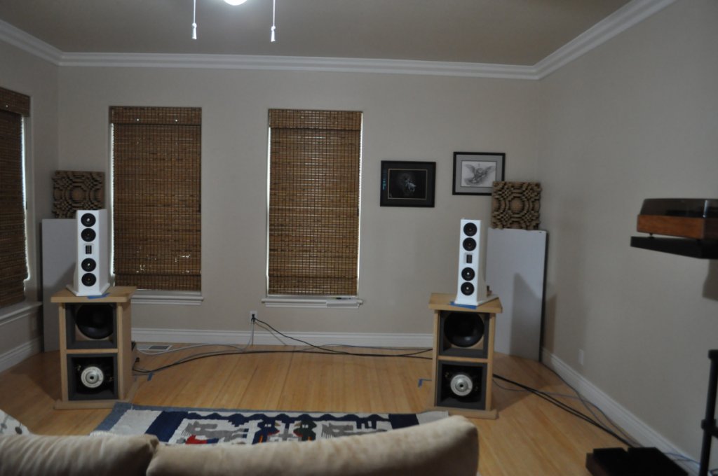

Just curious, how far from the front wall are your speakers and from the back wall is your listening position? If moving the speakers front/back or side/side didn't do much, then it's likely a floor/ceiling mode not a wall mode, or possibly a combo of the two. Tricky to solve, but not impossible. Between some more positioning tweaks, some carefully selected and placed room treatments and utilizing the peq feature on the subs, you'll tame that beast pretty easily. Also if there is a door in/out of that room (not sure if it's a spare bedroom or a living room) then try leaving it open. My room is a small spare bedroom that has a nasty 45hz spike when all closed up, but if I leave the door open that spike is nonexistent.  Food for thought.
-Lloyd
mkane
  • Posts: 488
« Reply #17 on: 6 Sep 2023, 03:11 pm »
Speakers are 5' from the front wall and there's 8' of space to the back wall from the listening position. There is a door on the rear wall and it was shut when the measurements were taken.
