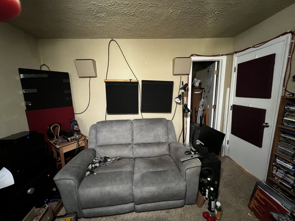

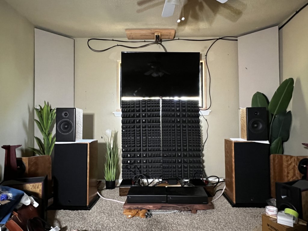

Here's what my room treatment looks like.
Front Wall GIK Acoustics Tri-Traps with range limiters in the corners and PI Audio Group diffusers in the center
Here's the back wall. GIK Acoustics Alpha panels in the rear corners and behind the LP
There are also PI Audio Group diffusers at the first reflection points
BTW, the speakers are a custom pair I built for a client that are being burned in. The NX-Otica MTMs will return once the burn in is done.

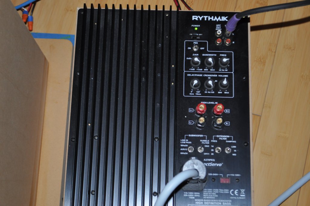

 I'll get a picture of the dials

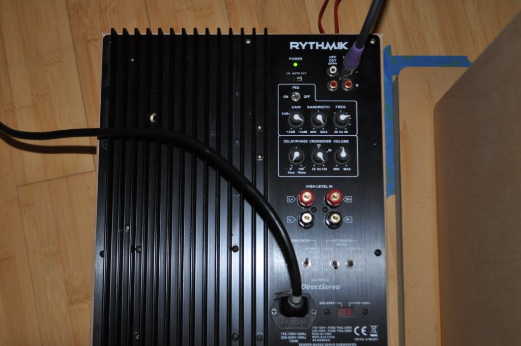

« Reply #25 on: 6 Sep 2023, 08:07 pm »
 Left/right dials & rear wall. I'm going to buy some materials to construct diffusers. Traps I'll probably buy ready-made. Absorbtion I'll probably DIY also.
toggle switches are on AVR Extension filter 28/Hi
I really appreciate the input.

I see one problem - bandwidth is too wide.  Change it to "min" instead of "max".
Re-measure after making that change on both sub amps.
