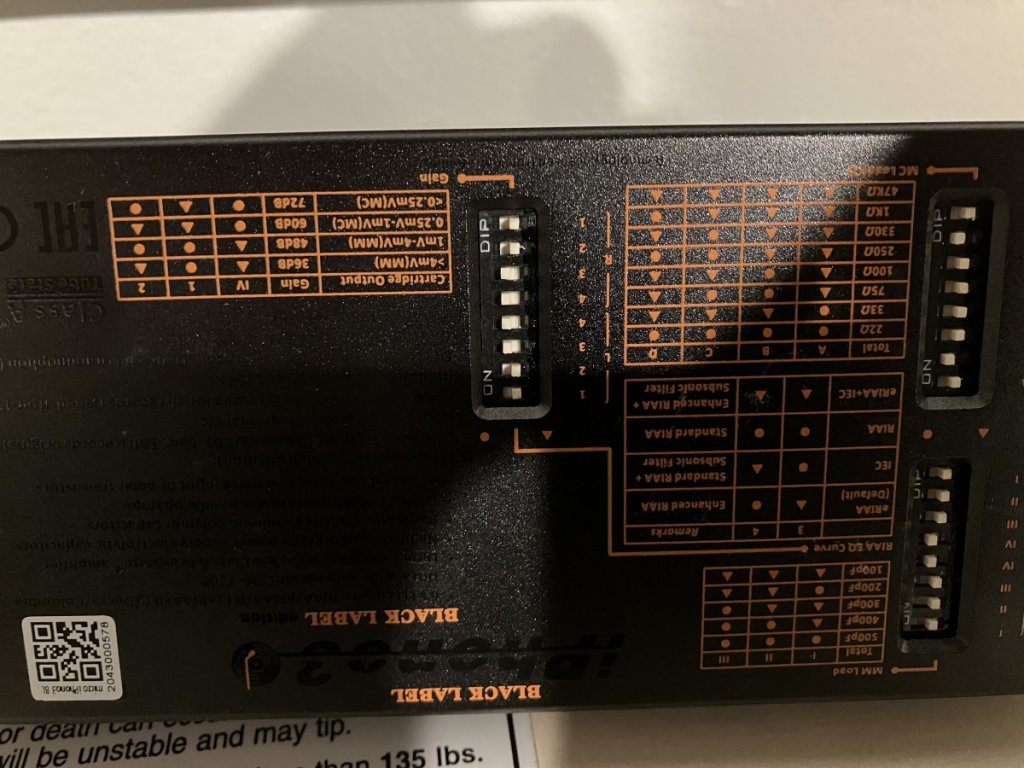

can you tell me if this looks right for Quintet Black S

It looks like right now you have it set at 60db gain and 100ohm impedance. Not a bad setting for most carts, but ortofon get a little peculiar on settings sometimes. Try flipping to the 72db gain setting and see how that does, then start lowering the impedance settings to 75 and then 33 and then 22. I think the gain setting has some to do with it since your cart is barely above the "recommended" cutoff for thr high dv gain setting. But I do think the impedance setting will play into it. With too high of setting, things will sound thin and tinny, but with too low of setting (too much resistance) then things will sound muffled, super dark and quiet.
Try that out and report back. I'm interested to hear if it makes a decent enough difference before you jump down the rabbit hole of fancy new phono stages.
