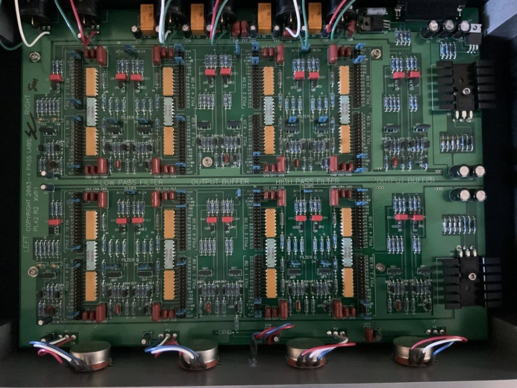

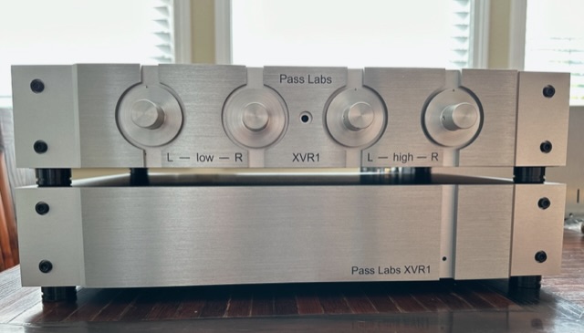

I had an XVR-1 to bi-amp my Maggie 3.6Rs.  It is discrete without op amps.  They come up for sale about once a year for around $4 - 4.5K.  I sold mine last year to a nice gent close to San Diego for his Apogees.  Are you gents sure that it sold without the external power supply?  I’m not sure how that’s possible, since there’s no room for a power supply in one box.  As for noise I never had any, but it was plugged into my Shunyata Everest power conditioner with Omega XC power cord.
Photos of my XVR-1 below.  It is more transparent than my modded Marchand XM-44.  Anyone interested in my Marchand?  It’s been sitting around for years.
