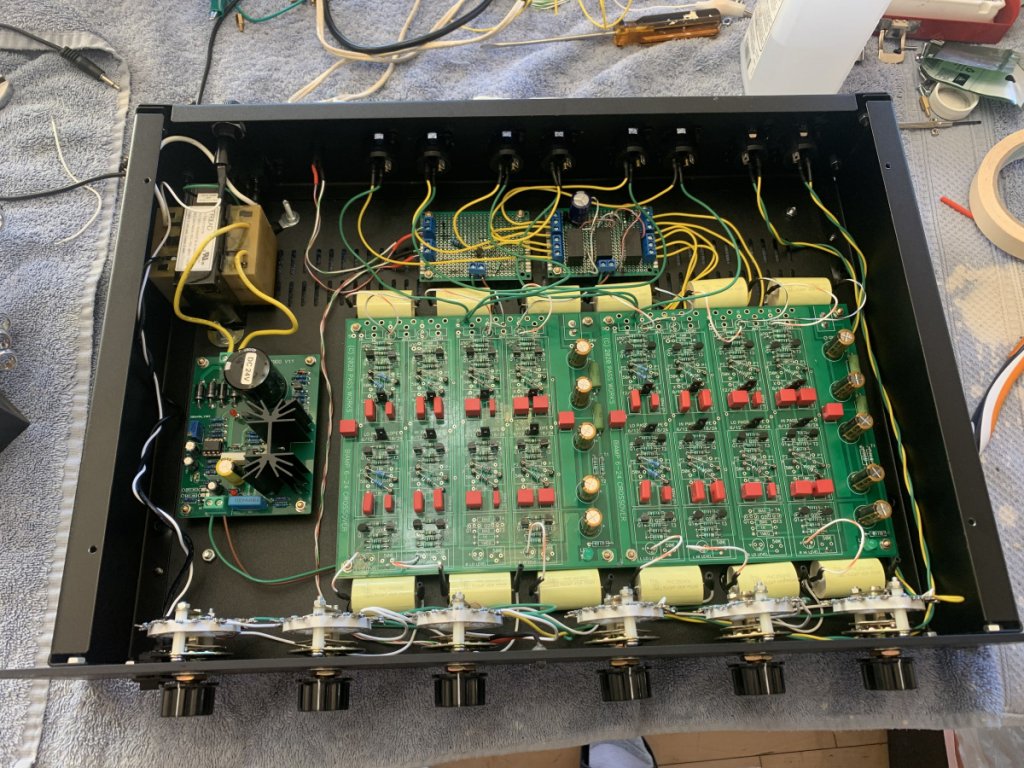

I have had some hum due to my DIY Nelson Pass 6-24 active crossover. Not terrible, but c'mom it should be a black brckground. Had a local audio enthusiast over last week and he mentioned it.... definitely motivated me. I'm looking at ordering fets, maybe ground loop as its single ended, generally pulling my hair out trying to figure this out; but as I look at the picture I remember it does come mostly from the left sub.... now isn't that the closest output to the step down transformer for power regulator. Hmm, could it be electro magnetic radiation from that transformer. Disconnect supply and switch in a bench supply, noise gone. Eureka, finally found it! Spent today tearing things apart installed toroidal transformer (should have in the first place) I had laying around... totally quiet. Didn't stop there and fabricated a faraday shield around power supply. Took the better part of the day, but I'm done and listening to music.
Before and after pics... booyah!
Before
After
