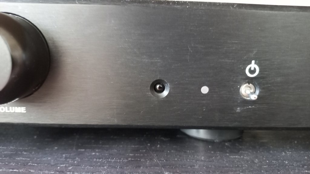

Trying to clarify my question, what I'd like to know is if when I bought a bp6 without a remote, the amp could be sold without IR sensor or with sensor but somehow not activated.

HI
Does it have a small glass eye on the front panel?  If not there is no remote capability.

HI
james
Hi, James, I think it has. Check photo, please.

« Reply #7 on: 2 Jun 2023, 11:04 am »
Yes, that is the remote sensor next to the led.  Good luck.

« Reply #8 on: 2 Jun 2023, 12:47 pm »
Fantastic! It's working. Thank you very much.
This remotes do the job perfectly being simple as the original remote sold at the time.
