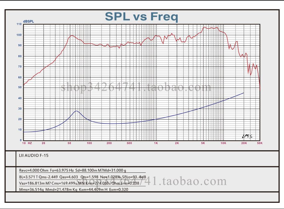

Seller measurements:
Do you think this speaker is ok for a fun OB project?

This F15 chart is not the same sold by the Lii Audio.
It say F15 not Fast15.  :scratch:
I cannot find the F15 used by everybody in the official shop on taobao. For me, the one available is the "new" version, FAST-15 or F15 is the same thing. Well, not sure, but it is what I think.
