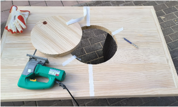

Finally found how to upload an image.

Ha... It is working since last Saturday and I am working at home, so it means it is from 08:00 to 23:00 each day.
I use a little amp, the FOSI BTA20 pro, paid 57€, so the total cost with the amp was less than 400€.
I am very happy with the results because it was a fun project shared with my wife. She helped a lot, in particular with the wood. She knows a lot in mechanic (and a lot of other topics, but mechanic knowledge is good for building a first Open Baffle). We continue to work on the project with a full toolbox of ideas.

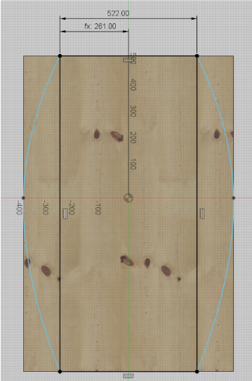

My wife designed the model, ordered the wood and cut it.
We plan to re-cut but I want some measurements before we cut the round shape.

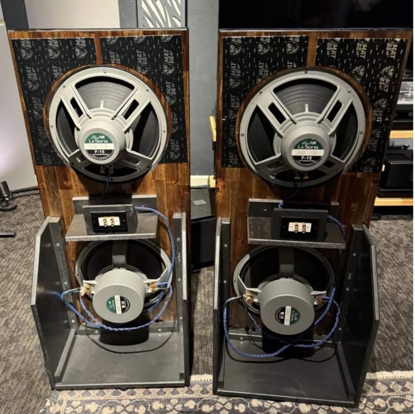

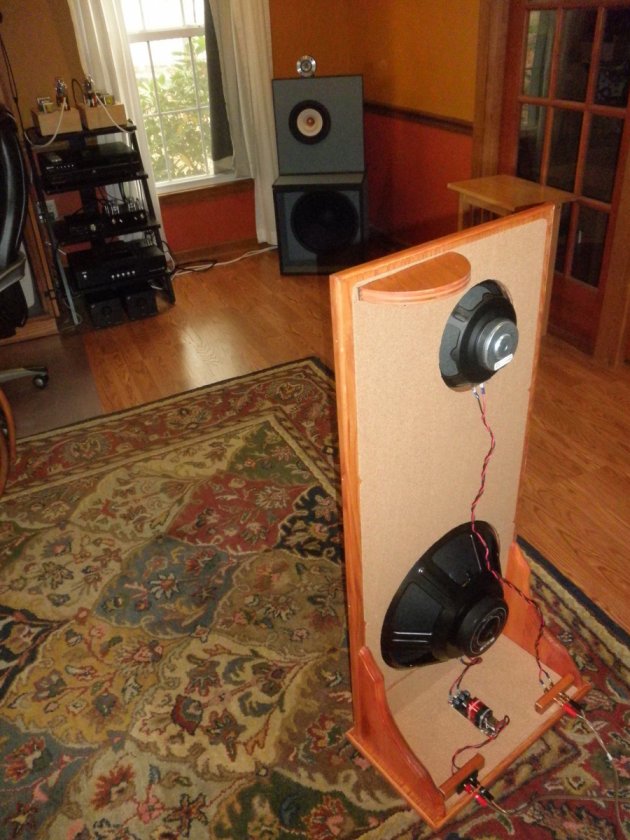

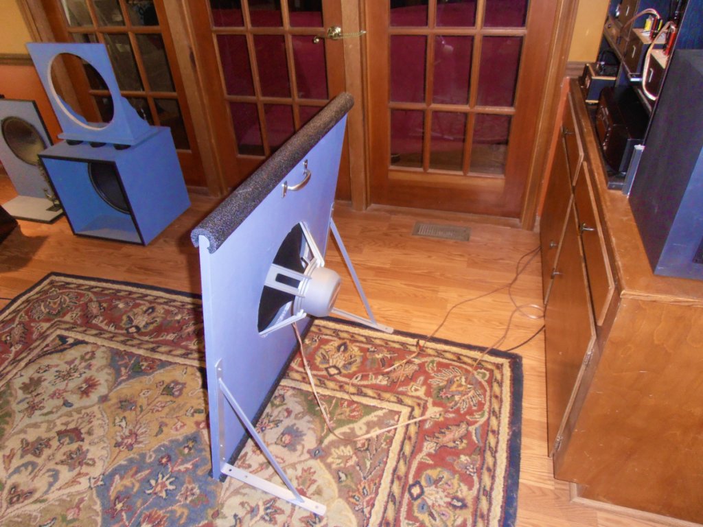

Tried the F15 solo in a wide baffle but much prefer it in a smaller baffle bi-amped with bass woofer support.
Poultrygeist
Re: Want to build OB with Lii Audio F15
« Reply #32 on: 9 May 2023, 10:20 am »
My first experimental baffle using the F-15 was sort of a cross between the dimensions of the Decware and Mr. Glow-in-the-dark's version. Bass was weak but probably ok for some. Elevating the F-15 atop the H-frame supporting woofers proved to be a much better solution.
Do you could stuffing inside the H Frame walls with 10mm car wood blanket to increase the bass and inform us the results?

I use 3/4" MDF covered with heavy wallpaper. Filler between layers or thicker baffles may be required to reduce resonance if one plays at extreme SPL's but I don't.
I favor MDF for baffles as it tends to be deader that plywood. The objective with OB's is you don't want to hear the baffles.

Cork also works well to combat baffle resonance. Here I used thick cork placemats from Ikea.

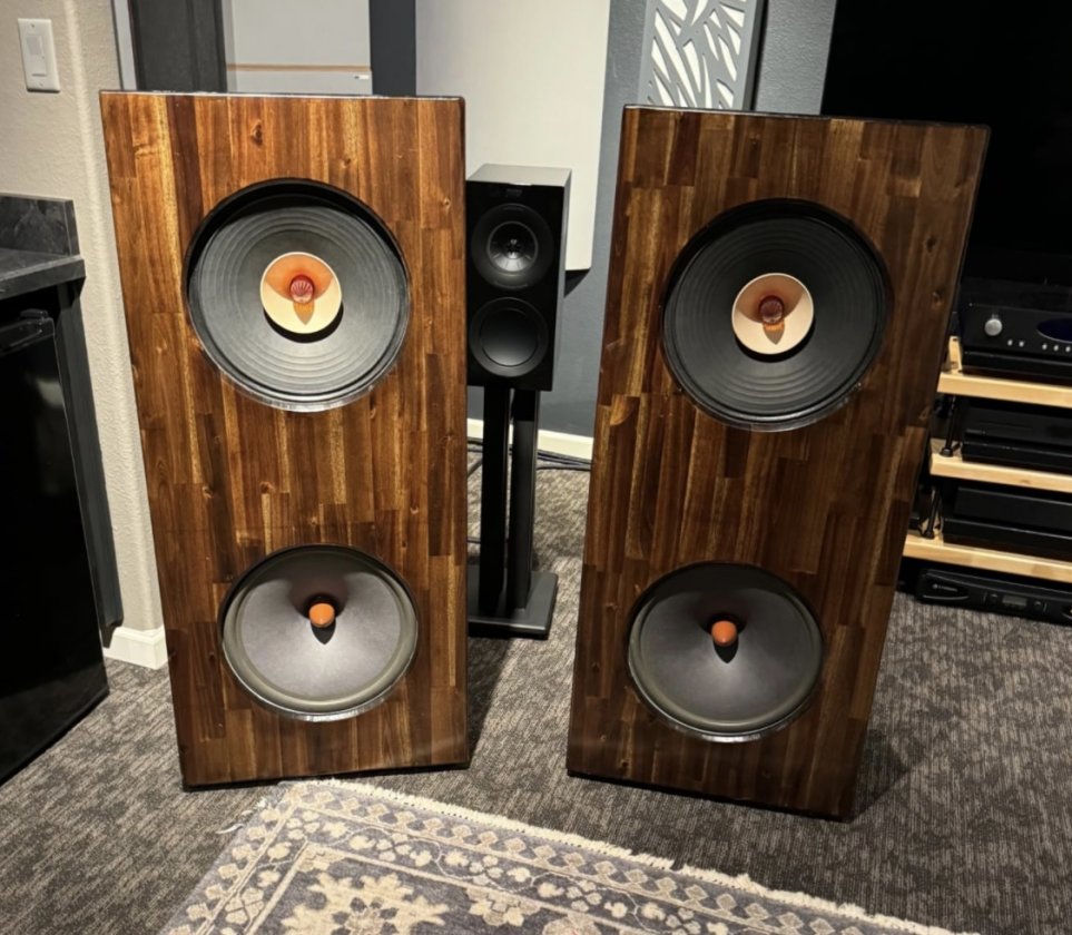

Finally got my new Fast 15s in a test baffle....I know this is all wrong, but just temporary  :D The plan is to do a PAP style modular OB. As of now, decided to have the Fii in the middle, and two Eminence Beta 15 bass drivers underneath and above.  Tried the Fiis on the floor, a little higher up on some milk crates (for WMW), and then on my 24" stands (for MWW). Very happy with what I'm hearing so far.
Right now driving them with a W4S M-pre/ dual M-amps, will use Crown XLS1500s for the bass driver, and IB subs in the ceiling above, if needed...
« Last Edit: 1 Feb 2024, 01:12 pm by jk@home »
