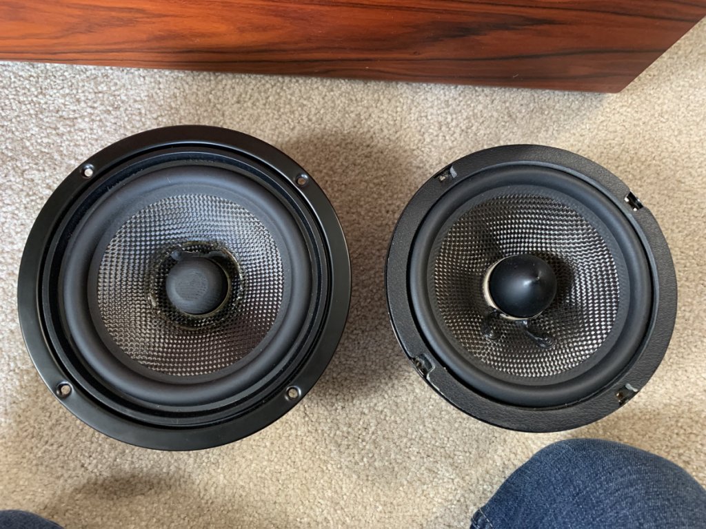

So if I understand correctly you want to replace the LRC’s MCM Audio Select 6 ½” woven carbon fiber cone woofer 55-1545 with the Misco LLC62W-8A Speakers? I may be wrong, but those are the only two drivers I know of being used by Brian in the LRC.
I have seen both drivers come from VMPS. I currently have the MCM’s in my LRC and it looks like the Misco would drop in. The Misco has a slightly smaller diameter of 6 1/4". I have noticed on the Misco drivers that came from the factory that there is an additional ring around drivers to make up for the additional cutout space in the housing. I had planned on replacing the MCM with Misco as I have a spare set, but never got around to it. I am actually quite happy with the MCM’s for the LRC application.

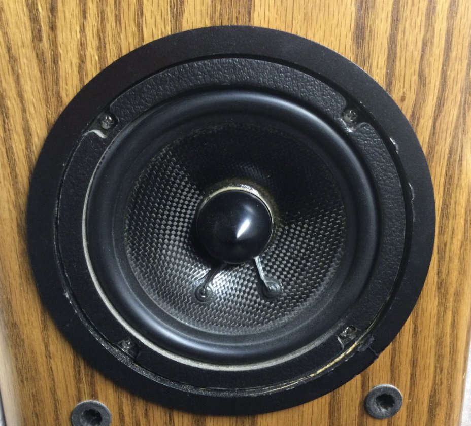

The drivers in my LCR are the matte plastic (polypropylene?) cones and the WCF cone drivers provide deeper and tighter bass.  Looking to get more body and mid-bass to fill in the lower registers.  Richen up speech primarily.
Apologies for the crappy cell phone photo.  :icon_frown:

You may want to send a PM to davidc1 as he may have a pair of MCM 1545. I sold him a couple of the MCM 1545 drivers, a neo panel, and an extra LCR cabinet I had laying around. As I recall he found a built up LRC and never got around to the project of building up the LRC.
If you can live without your RM30 for a few days, you may consider removing a couple of the Misco drivers from the RM30 and throwing them into your LCR and sitting with it for a couple of days. If it gets you where you want to go, if it was me I would just special order 4 of the drivers from Misco that were made for your RM30 and the LCR. It would serve two purposes as you would get a performance improvement in your LCR and if you ever had a problem with your RM30 you would have spares. When the 4 drivers come, based on my experience you will be able to sell the 2 spares to someone. I looked at the specs of the Misco drivers they have in stock (BWF-6503) and appear to be a good replacement. Personally I would just be patient and have them make the LLC62W-8A drivers.

You may hold off, I will get to why in a few. Is the outer hole diameter just shy of 7 1/2"? If yes, either driver should work (see below). The MCM Audio Select is 7 3/8" outside diameter.
You motivated me as I have intended to drop my RM60 Misco spares into the LRC. If anything happens where I need a spare, there would be a trickle down of moving from LRC back to RM60, and then spare of MCM back to LRC. I have three MCM drivers so one spare if I lose a driver and sell the MCM's. The reason I never got to it was I was good with the MCM drivers and I spaced it. The specs are similar, but the Misco definitly have larger magnets and are just really nice.
I just removed the drivers out of LRC and put in Misco. As I mentioned previously both drivers were used in the same cabinet. To account for different diameters of drivers the cabinet lips are extra wide so there is still enough material to screw down the Misco speakers. Below are some pics of what I am talking about. For the LRC that came out of VMPS with Misco drivers there is a spacer between outside of diameter of driver and cabinet cutout. Without spacer it looks a tad goofy, but with the grill all is good. Although I may look for spacer to glue in later. One of the pics shows how much wood is left for the Misco drivers, black dots are where the Misco cage holes line up.
Let me spend some time listening to the Misco drivers. I am not going to start until this evening and may need a day or two. Give me a day or two as I may be getting rid of the MCM Audio Selects. If I decide I will PM with price, they may be slightly higher than what I sold for previously as they have the VMPS phase plugs. The TV is two weeks old Sony X95K... loving it.

OK George, and thanks.  So the one on the left in your pic is the MCM?  Wooden phase plug?
Yes, and yes. I looked at the picture of your LRC and based on the distance of the outer edge of the speaker diameter cutout to the top of speaker and grille holder your cutout appears to be 7 1/2".

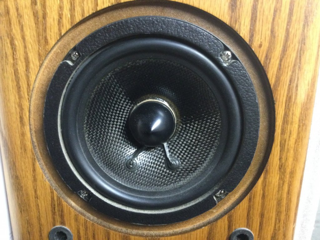

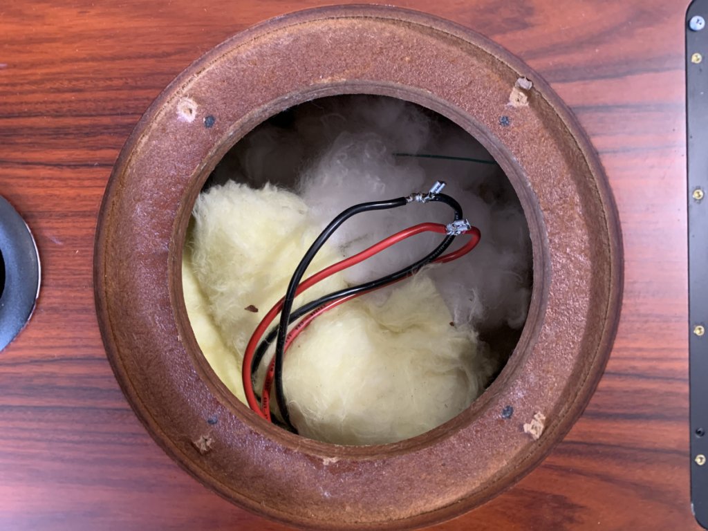

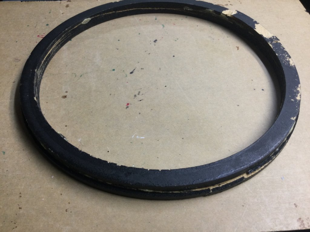

The cutout in the face of the cabinet is 7.5".  Do I need to pull a driver to check the actual hole diameter?
ZAKski288
Re: Driver upgrade?
« Reply #14 on: 3 Mar 2023, 02:40 am »

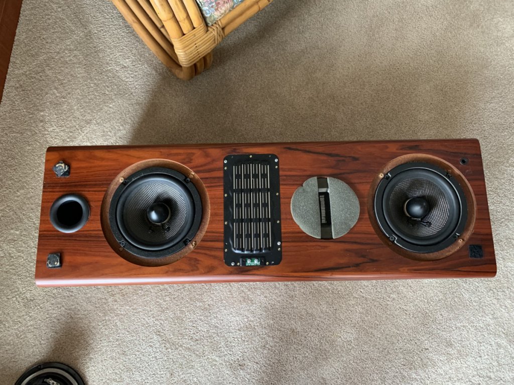

Brian use a trim ring to fill in the gap. Mine has seen better days. He also used three different drivers among the RM-30’s , LMC, and 626R.
Misco MC62W-8A , 28oz magnet with wood phase plug
MCM 55-1545
Misco LLC62W-8A, 40 oz magnet with aluminum phase plug
Misco MC62W-8A driver with 28oz  magnet, VMPS installed wood phase plug
LLC62W-8A driver with 40oz magnet

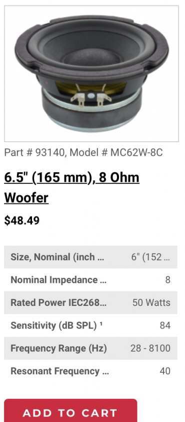

Jake, Misco offers this driver, has a paper cone, but you may still see if they can make you some of the
MC62W-8A carbon fiber cones. Just order them with no center cap and you can make the phase plug. They really sound close to the 40oz driver
Good luck.
