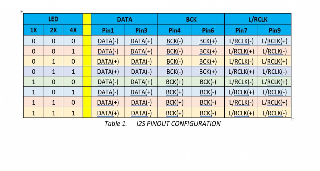

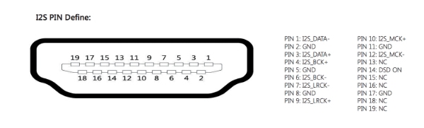

Check that your DAC's I2S port uses the same pin spec as Nuprime:
You can still use other outputs from CDT-8Pro to connect to your DAC.

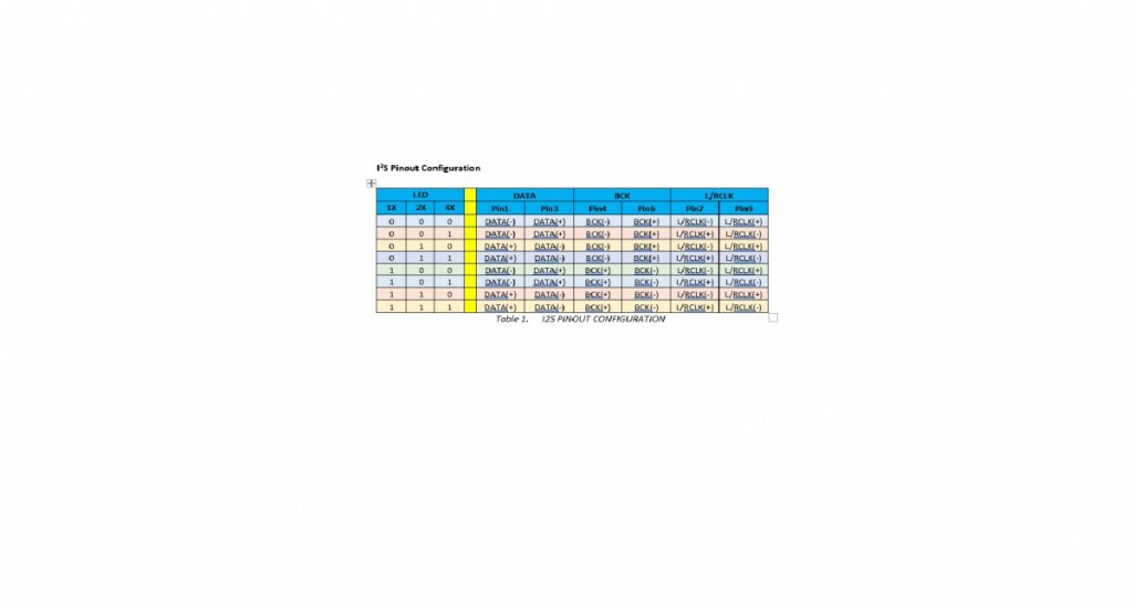

The Dac Denafrips Terminator has  I²S pinout configuration....if the configuration is wrong, it shouldn't work in  DSD mode instead go with DSD's upsampling.

Nuprime gear uses the PS Audio I2S pinout and Denafrips does not.
I have already written that Denafrips has configurable pins. I actually set it as PS audio I2S pinout. With DSD it goes; with PCM it doesn't work . Why?
