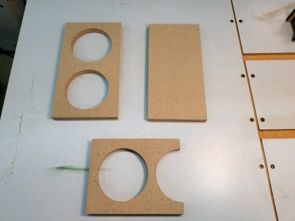

Step 3:
Cutting specific parts to length:  Parts B, C, D, I and J were cut.  If you notice I created part B, the inside baffle with the half circle the same size as the baffle with two circles (part C)...because I didn't pay attention to the length dimension in the plans correctly.  I realized my error, and proceeded to cut them to the correct length.  In hind sight, I wish I would have left them the same size, and then adjusted the measurements after I cut the holes in the parts.  More on this in the next few steps.
« Last Edit: 14 Jan 2023, 02:39 am by Rojo22 »
Rojo22
  • Posts: 30
  • Sometimes, the wanderer is not lost....
Re: X-Statik and Voce Build
« Reply #10 on: 13 Jan 2023, 02:06 am »
Step 4:
Milling parts B and C:  I set up a drill press with a set of stops which would allow me to use a fly cutter to cut the holes in the parts for B and C.  The measurements are NOT THE SAME for these parts.  Check your measurements, you will need to have a different set up for parts B and C.  If I had been paying attention, I would have created part B differently than I did.  I would have adjusted the fly cutter, and cut the holes in part B, and them trimmed off the ends to make the part to the correct dimensions.  The way I did do it, was to reset the stops, cut the full hole, and then use a band saw and a radius/drum sander for the half hole....Note to self check the parts list at least another 100 times!
SAFETY INFORMATION-  A fly cutter is a VERY DANGEROUS tool.  There are no guards, and it creates an enormous amount of torque.  If you look carefully, my stops are clamped to the drill press bed with metal clamps along with the part as well (I forgot to take a picture of this clamped to the stops).  A fly cutter requires an immense amount of respect and attention when in use.  If you use a fly cutter on MDF, be patient, always be aware of where your hands are, use a sharp tool, cut slowly, and NEVER bind up the piece when drilling.  Safety glasses and a breather mask are a must!
« Last Edit: 14 Jan 2023, 02:40 am by Rojo22 »

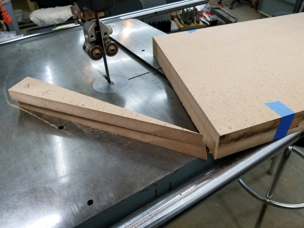

Step 8:
Making a Sandwich of Sides and cutting the slant for the top of the cabinet:
I took the matching side to the one in the previous step, placed it on the keys, taped up the "sandwich" and marked the slant line on the top of the cabinet sides (Parts I and J).  I checked 20 times to make sure I was cutting the slant in the right direction!  I then took the "sandwich" over to the band saw and cut the angle, leaving the marked line.  I will take the "sandwich" over to the horizontal edge sander and flush up the sides next.
