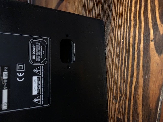

I would like to find something to fill the hole left from the socket on the back of my Scenario's that is not a piece of mdf of ply to cover the hole. I've looked for a blank of some sort to fill the hole to no avail. So now I turn to you guys to see if anyone else has solved this little issue in the past.

Well I'm not to bright. I did not mention my intent is to use the hole to run the three wires to the panel that come off the transformer that is now in a box outside of the speaker. If I could have found a blank with no prongs or other electric bits I would have drilled a hole in it and used a grommet to seal it. I may just be s.o.l. in this case. I may just have to fashion something to cover the hole and allow my wire to run. Thank You richidoo for helping me again. You rock. I did order those caps thinking they were bigger and would work. They did not work. :duh:

You may be overthinking this.
I would either find find a small aluminum or steel plate, fastening it using the existing screw holes and drill one or three holes into the plate for your wires.
Or I would take an IEC socket and remove the prongs from it. This would leave three holes for the wires.
Problem solved?

I was going to use some half inch mdf I have about, but I like your idea of using metal instead better. Once attached and wired, I can fill that void with silicone or whatever I have handy to make sure it is air tight.

You can get small pieces of sheet metal at Home Depot or Lowe's.
Amazon too.

I would use a acrilic plate, it bold well with metal also.

A blank wall plate should cost you a couple of buck at your local hardware store and be available in a number of materials including steel, various plastics, and wood.
